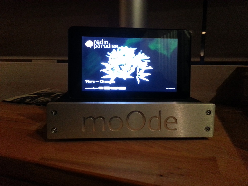

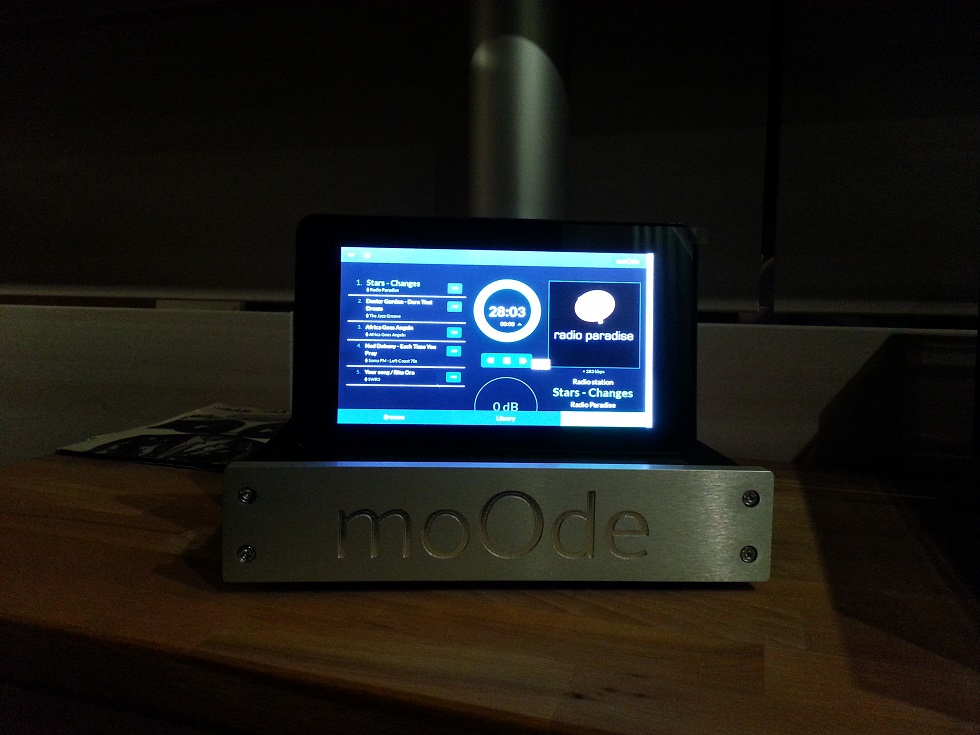

my Moode awaiting the final release and playing the
Radio Paradise Slideshow while waiting.
Michael
