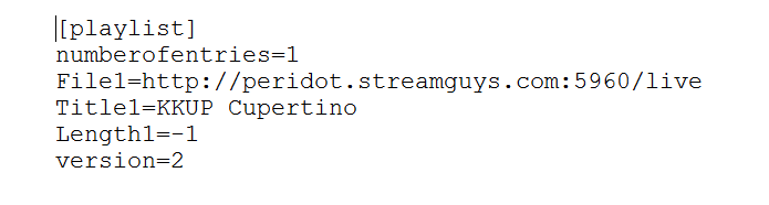

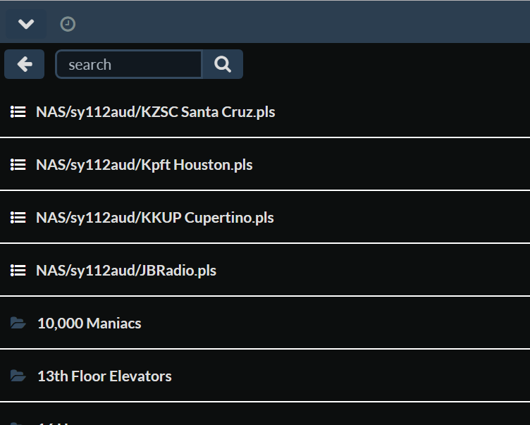

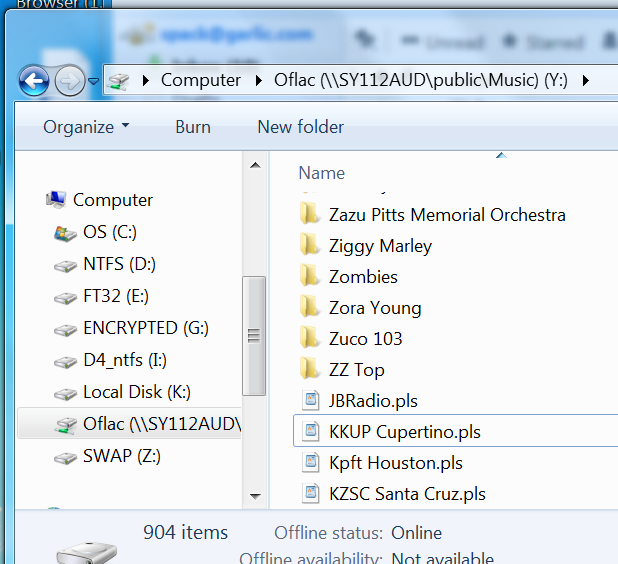

Here's a hack that removes the need to do anything about your own station entries. The downside is that they don't appear under radio listings. The do appear in your NAS, SDCARD, or attached USB music area.
You use a .pls file exactly like you would when you create a new radio station entry (leftmost image). Place this .pls file in your top level music file directory. (middle image -- Nas directory viewed from Windows) Once you index that directory, those file will show up in Moode browsing. (Rightmost image). Use them just like an album directory or a single song.
Not stylish, but perfectly functional and low-effort.
