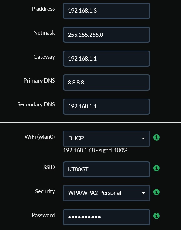

Hi Graham,
Try the following:
1) plug in WiFi adapter
2) System config, Maintenance section, Pi3 WiFi-BT adapter OFF, SET
3) Network config, enter WiFi (wlan0) SSID and password, APPLY
4) reboot
To return to using Pi3 integrated adapter
1) System config, Maintenance section, Pi3 WiFi-BT adapter ON, SET
2) shutdown
3) unplug WiFi adapter
4) power up
-Tim
thanks for responding
ok I followed steps 1 through 4
see attached screen capture that shows wifi network is recognized
after reboot I loose connection when I pull Ethernet cable
Change eth0 to DHCP, APPLY then unplug the cable.
If you are going to use a static ip address for eth0 at some point then Primary DNS should be set to same as Gateway addr 192.168.1.1, leave secondary DNS blank.
-Tim

I'm bashing my head against a brick wall...
New Pi3, new copy of R27
Boots fine, connect to MOODE SSID perfectly, get the standard display.
When I go to config network to change the SSID from AP to 'HOME', I get an error message telling me to 'please use the correct format' (or something similar).
I have tried it three times, with three different SD cards and have re-downloaded the img file, just to be sure.
Hi Mike,
There is bug in the Network config html.
To fix, delete all the pattern="..." statements from the file
/var/www/templates/net-config.html
-Tim
