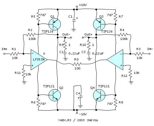

Hi JH,
How did you arrive at the component values in your circuit? I figured values that were quite different. I will explain how I got mine .
The resistors in the base emitter of the transistors, R5.R6.R7.R8.
The dc bias current of the opamp will generate a voltage across these. The LM353 has a supply current rated 3.6 to 6.5mA. Taking a 5mA value and 1.1 volt Vbe for the Darlington TIP's , this turns out to be 220 ohms. You cannot turn on the transistor in the no signal condition as there is no current control on it.
To fully turn on the transistors you will need about 1.5 volts Vbe.
This will mean that we have a current of about 6.8 mA flowing through the R5,6,7,8. The signal component of this would be about 6.8-5 mA ~ 1.8 mA. This is well within the capability of the opamp.
It is not clear about the opamp output voltage when the transistors are fully turned on. With 100 ohms that would be about 90mV at the output of each opamp. Wouldn't that be comparable to dc voltage errors at the output of the opamp which may be several mV in open loop. I am not thinking clearly I guess.
As a guesstimate I would use say at least 2 volts output on the opamp to drive the TIP's fully on. So I would probably try about 2 or 2.2K ohms for R0.
You will also have to use the resistors from the + input to ground, as mentioned in Nelson's post , as it will reduce dc offsets.
How about your approach?

Re: Component values
I am a kind of hopeless man about the electronic circuit analysis. So, I have to spend much time after work to understand the basic of electronics. This is also a good excuse to avoid TV news about the bloody hell of politicians.
You are right. We could turn on the TIP with Vbe of about 1.4V (not 0.7V as I initially thought). Therefore, we will get the supply voltage of 8.6V to LF353, and the corresponding typical supply current of about 3.4mA according to the data sheet. I assume this 3.4mA as a current source. Meanwhile, I want to have a base current of about 1.6mA to the TIP. Then, the remaining 1.8mA is to be used to generate 1.5V across the base and the emitter. This requires R5 of about 787. I consider R5 as a sort of bootstrapping resistor. Please note that all these are based on the first approximation. So, the correct values might be somewhat different. What would happen if the supply current is going crazy up to 6.5mA? I would go crazy, too.
I might be wrong. I am however relaxed to some degree because Nelson Pass will as usual thunder in and light the garbage off.
R0...? Pwhoooo... I do not know... I just understand the value as Nelson Pass says--to be compromised in consideration of the stability and the distortion.

JH,
I explained how R0 could be worked out. The load current through R0 will come through the resistorsR5,6,7,8 depending on which device is 'on'. So it will increase the drop across these resistors providing the voltage the base emitter requires.
The maximum base current should be about 0.5mA at maximum collector current of the power devices. Hfe at about 1.5 amps is quoted at "typically" x3000. Someone should build one and try it out. Anyone ?
Ergo ,
The circuit has a differential input and differential output with a floating load. How would we make a 3rd order filter with this configuration. Is the intended application to be a line level filter or a 3rd order filter built around the power amp. Interesting idea.
Cheers.
Ergo ,
Cheers.

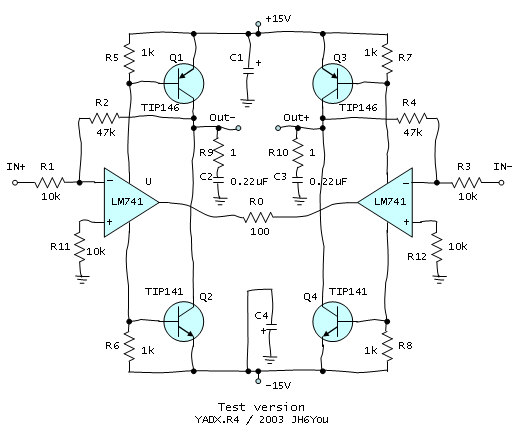

No. I can't use the dual op amp LF353 as it has a common voltage supply for the two channels. Therefore, I select two LM741 op amps (typical supply current of 1.7mA). And, for the power booster transistors I choose TIP141/146 (on-Vbe about 1.4V). The values of R5/R6/R7/R8 are decided with 1k. If this test circuit works as I wish, I would get output power of 22W per channel.
By the way, for the test of this circuit, is the regulated rail voltages recommended?
JH
PS
If this test version has no hope, please tell me so. I would much appreciate it.
