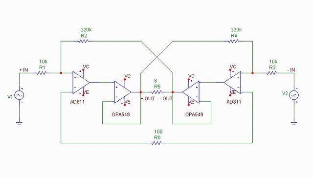

Attached below is to show the resistor values I want to have. The sizes of the resistors must affect the feedback transimpedance, frequency response and bandwidth. As expected, however, I could not figure them out. Therefore, any oipnions from all of you would much appreciate. Thanks.
JH

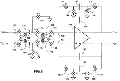

The sw-C filter circuit below is nearly the circuit used in the output stage of AKM and Crystal/Cirrus’ 120 dB DACs – I should hope any competent patent attorney would argue sw-C circuits are equivalent “feedback means” to the resistors you use
In the Crystal/Cirrus CS43122 the differential op amp is very much the same as the OPA660/2662 tranconductance amplifier except for CMOS implementation – a complementary pair of cascoded differential pairs feed the gates of 4 common drain output fets hanging from the power supply rails (H-bridge style), local Miller caps with series Rs compensate each output fet (presumably the zero from the R is required due to the “nested” feedback C structure: “A 120dB Multi-bit SC Audio DAC with 2nd Order Noise Shaping” ISSCC 2000 paper WA20.6 (Crystal/Cirrus) and “A Multibit Delta-Sigma Audio DAC with 120-dB Dynamic Range” IEEE JSSC, v35,#8 ’00, p1066
I would be happy to receive a finder’s fee of 10% of any royalties you can collect from these big boys

Nelson Pass said:
Best guess offhand? 100 ohms.
Better way? Find the highest value that still causes
oscillation and multiply by 5 to 10.
According to you, R0 sets the open loop gain and stability of the system. And, it would mean that the open loop frequency response is characterized here too. Therefore, the high values of feedback resistors, e.g. R2 and R4 up to about 200k, would work without any particular problem both for the system and with respect to the frequency bandwidth. Could I go ahead? I am searching shops to get the girly-man chips for another round of DIY exploring.
JH
