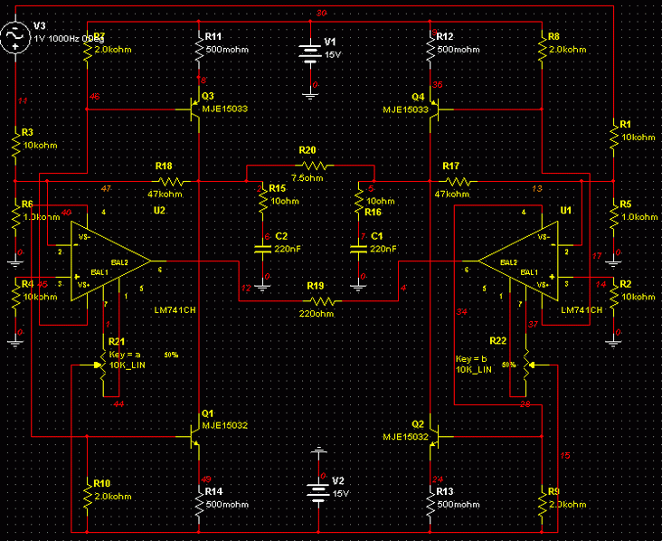

I tried the schematic on 2 simulators, but no matter how I try,
It doesn't work.
Don't have the models for MJ4502/802, but that is not the real problem I guess.
Dumb question: The outputs from the LM's are connected to each other. How can they drive the output transistors that way?
I'm I missing something here?

Does the simulation model represent the op amps as "ideal" and so the model does not pick up the variations in current draw at the V+ and V- terminals that provides the variation to the transistors? Just a guess as my electrical engineering training predates simulation programs (although I could probably whip up one in FORTRAN with some punch cards! )
With the ac current flowing in X-form across the power supply terminals of op amps on the left hand and right hand side, I believe.

Netlist,
I had a similar case where the signal source was internally always connected to gound, so you couln't use it floating. This was with the Proteus simulator, don't know in your case. What if you try with one input grounded and the other one driven by a grounded signal source?
Jan Didden
Edit: Do you get an error message "..singular node..."?
JH
Thanks...

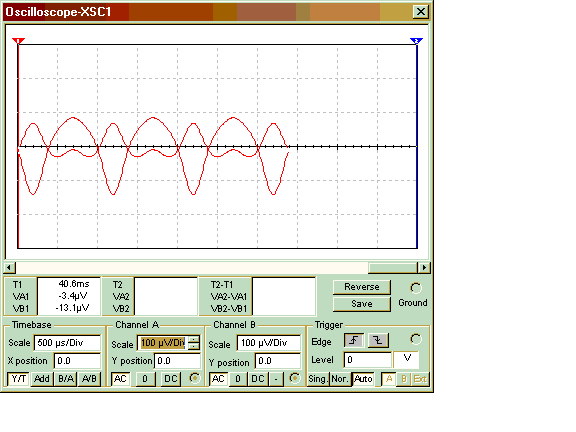

To janneman: no errors at all, just very low and distorted signals at the outputs. Both channels of the scope connected to V+ and V- of the left LM741. Notice the scale settings on the scope.
/Hugo - now studying

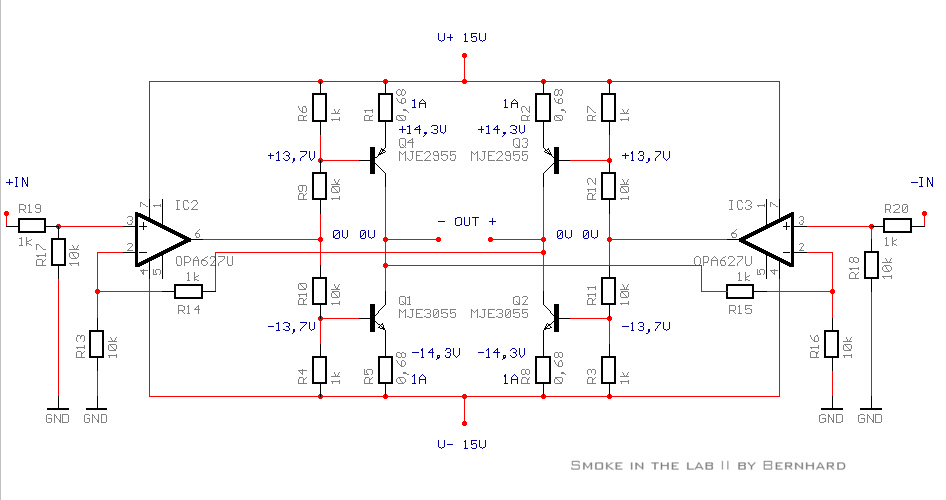

Both OPs are inverting, so if there is a positive signal on one and a negative signal on the other input, in one OP the upper output transistor will have more current and in the other the lower output transistor.
So for example, the current can flow from upper left to lower right via the 220ohm.
The that will confuse the four current sources (are the big transistors current sources ? ha ha ha) and modulate the base voltages of the big transistors, so they will do the same thing as in the OP. Current will flow from one upper side to the other lower side.
But the 741 has a crappy classB output stage IMHO.
And what do you think of my design ? Isnt it less complicated = more simple ?
Bernhard said:And what do you think of my design ? Isnt it less complicated = more simple ?
Definitely looks more understandable to me; what about putting some values near the resistors?
Your theory about current flow could be correct...I think we will have to study the first post of this thread again.
/Hugo - Is going to pick up his soldering iron :idea
My calculation may be wrong, but I believe if there was no feedback, when there are +2 V and -2 V on the OPs output, 0,6 A will flow through the speaker.
0,6 A if it is a 4 ohm speaker and 0,6A if it is a 8ohm speaker.
I am afraid, this will not work, it would mean more power on 8 ohm less power on 4 ohm.
Somethings wrong...
