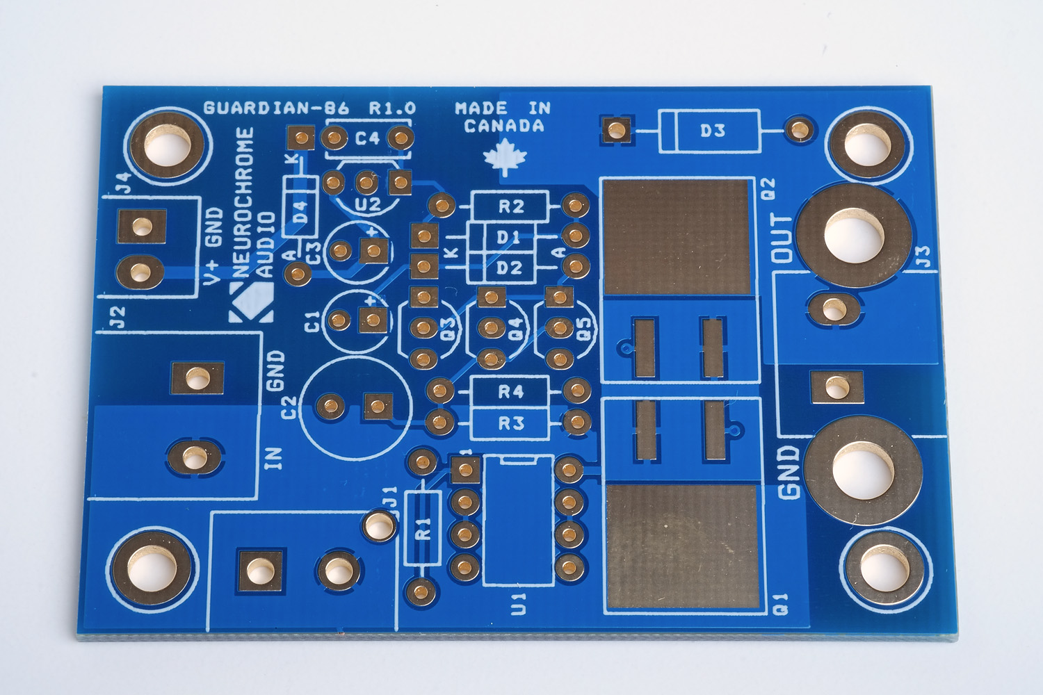

Oh, nothing. Just a li'l protection board.

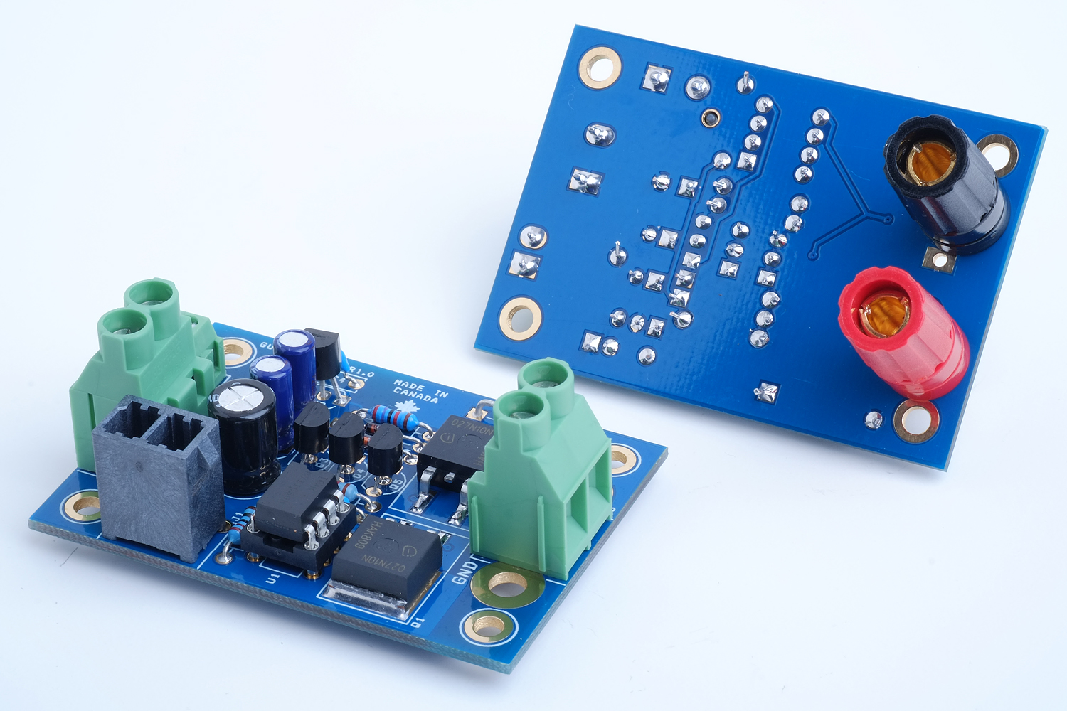

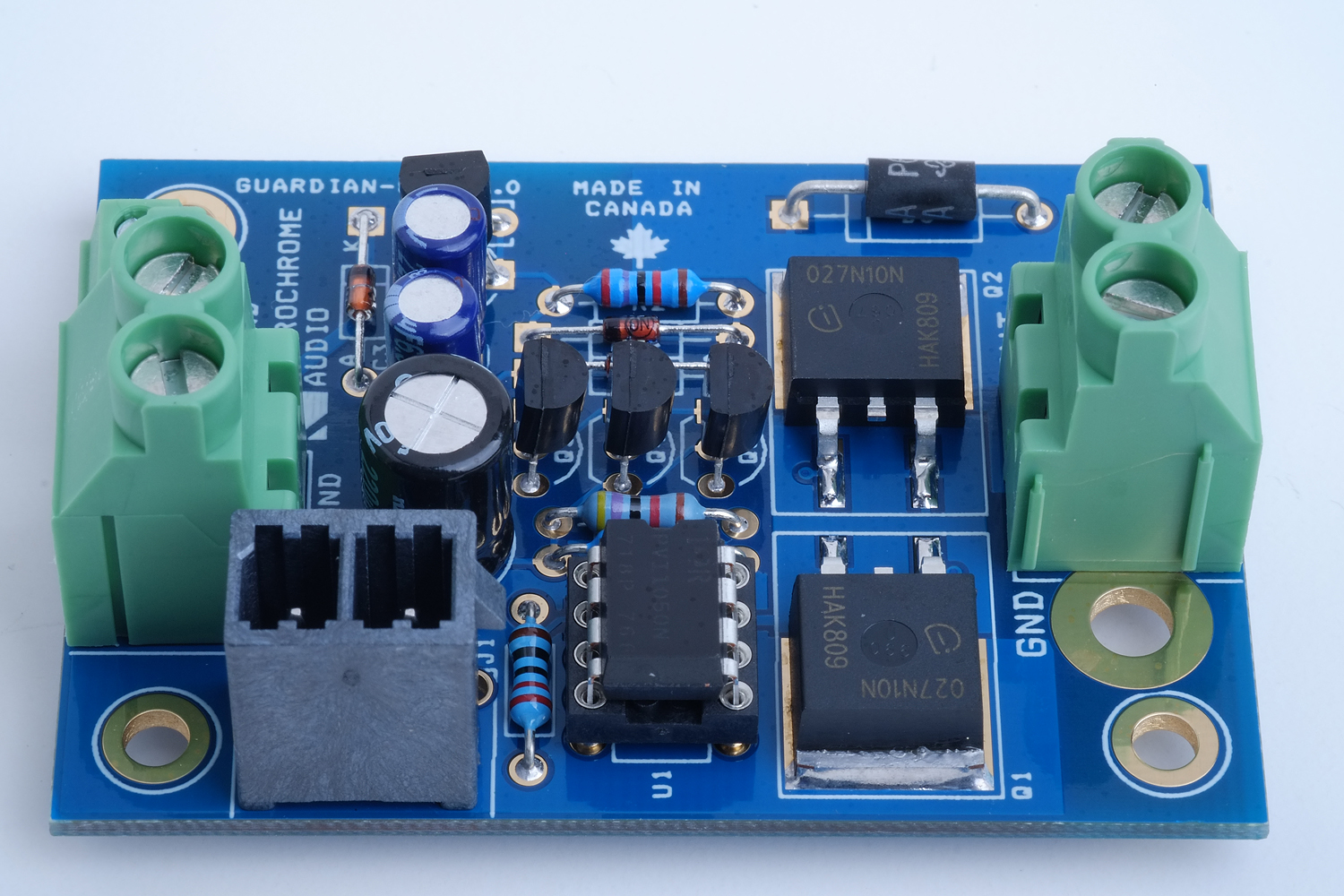

Guardian-86 is in and works well. I have boards in stock. You can find the circuit description here: Guardian-86: Speaker protection board for LM3886-based amplifiers (and others).

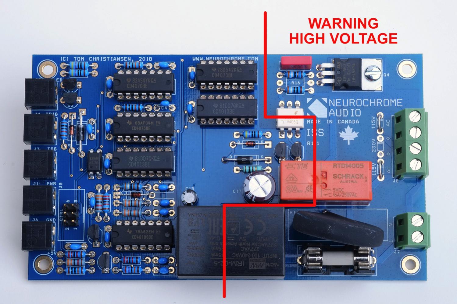

Oh, that other board? That's the Intelligent Soft Start. Description here: ISS: Intelligent Soft Start

Tom, I assume Guardian could be used for other power amplifiers too. What would be max. amplifier power or PSU voltage, that this nice circuit would have confident work?
±100 V would be the max rail voltage the switch MOSFETs can handle.
