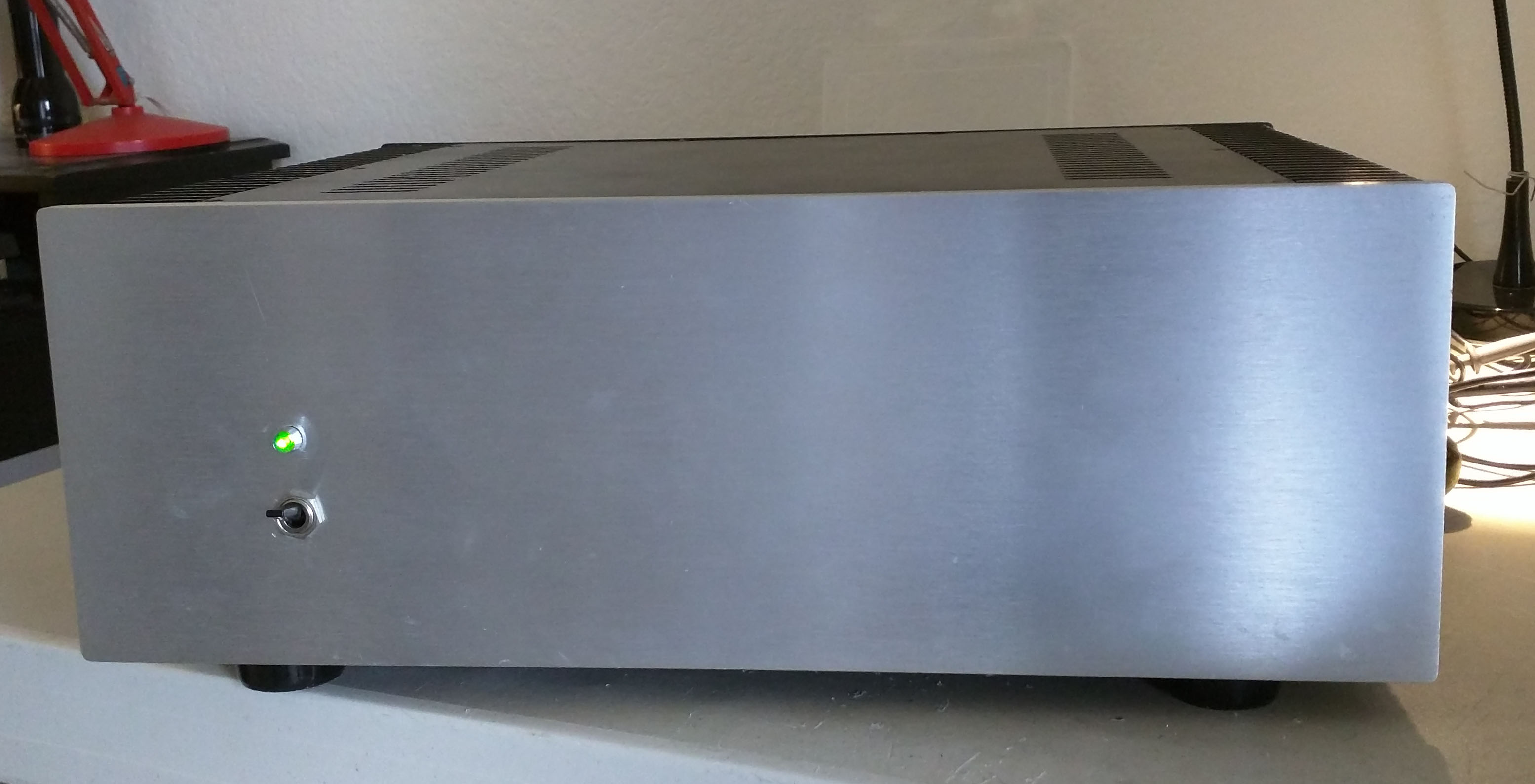

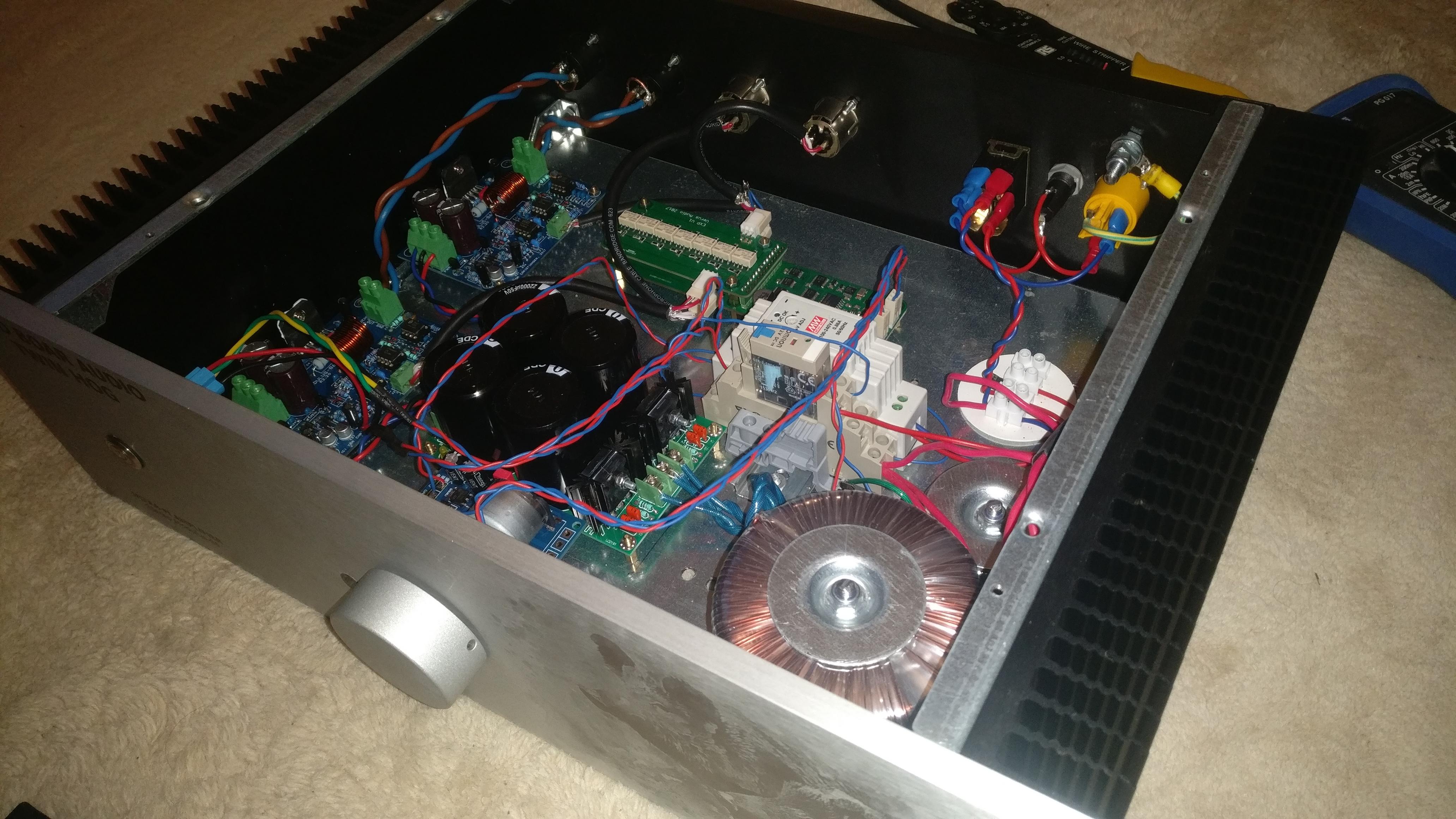

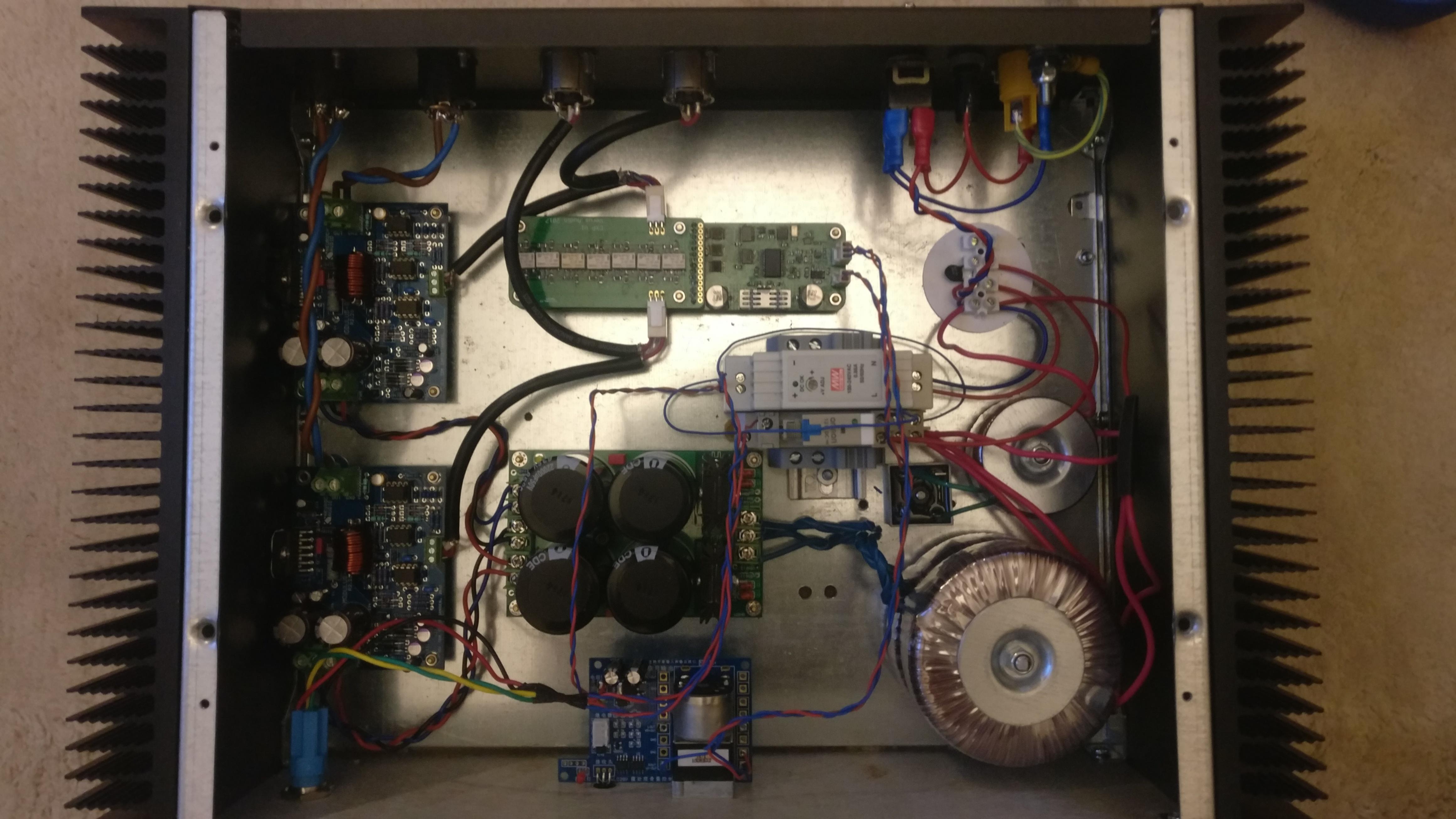

I posted my build a while ago and at the time it still had an unsatisfactory relay attenuator from eBay. That has now been replaced with a very good (though tricky to solder, being all SMD) relay attenuator by Neutrality, of this forum, so I've attached a couple of final build photos. I've been listening to the amp for a while now and it sounds very good, completely noise free and very neutral, and the 0.1% thin film resistors used in the attenuator makes for a perfectly preserved stereo field. Thanks Tom, it's been a pleasure building your design, I've learned a lot along the way. And for other builders, I highly recommend Neutrality's attenuator as a great complement to the Modulus86.

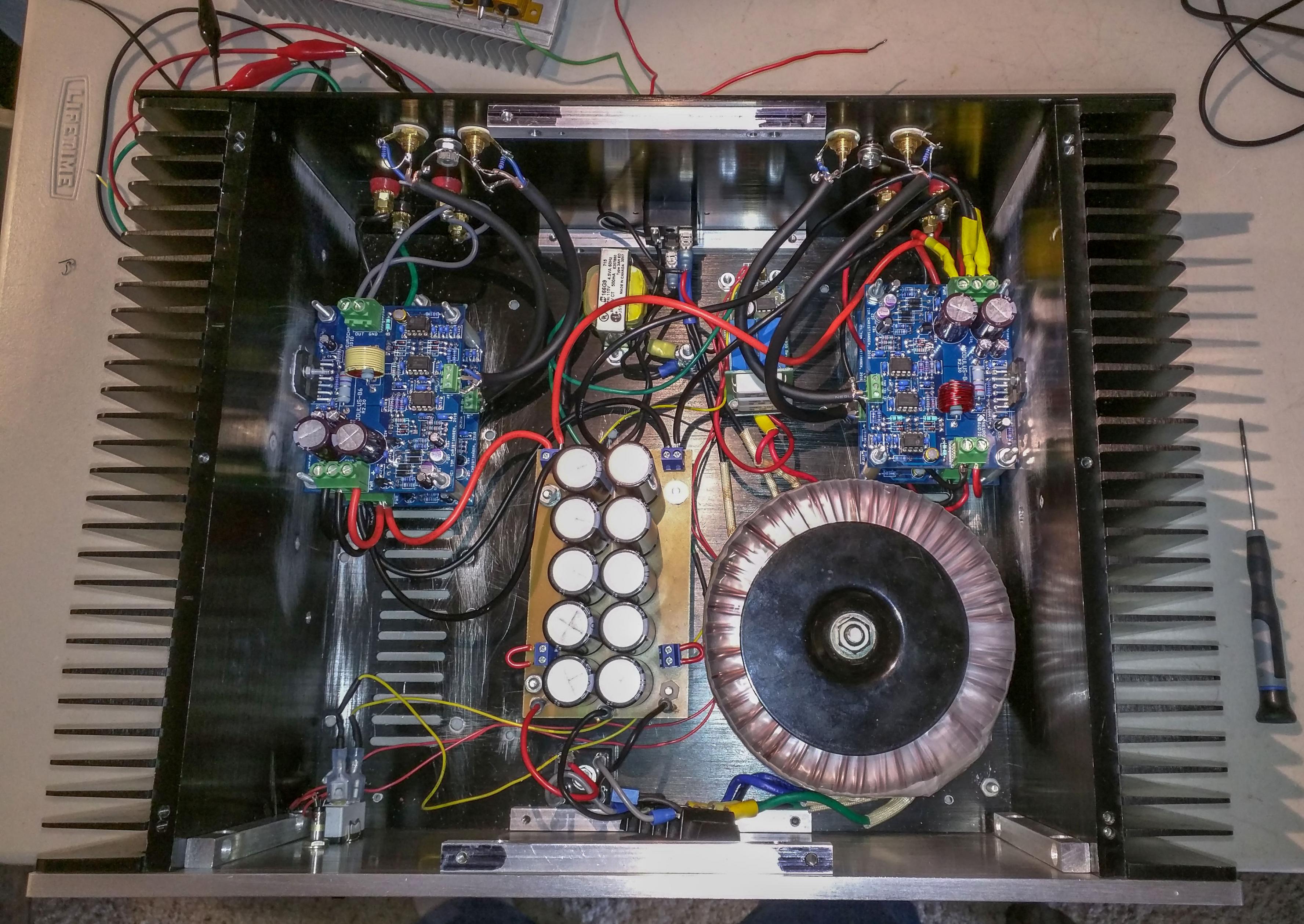

Attached are pictures of a Modulus-86 4 way build I just finished. I used a case and PS from a 2 way 25 watt Class A amp I had which I will use as an excuse for any sloppiness .
It was a pleasure to build these boards. The BOM was a big time saver, the boards are top quality, and the documentation extensive and very helpful... and so it Tom.
Objective Review: My Oscilloscope / signal generator/ distortion analyser (USB Analog discovery 2) is no match for the Mod-86. At first I was disappointed because I was measuring distortion that was lower than any other amp I had seen but not that much different. Tom pointed out it was probably my test equipment and sure enough my signal generator has harmonic distortion at -70 db.
There is a lot of discussion that many amps have "low enough" distortion so there is no point in the Modulus-86 ultra low numbers but I don't agree. While many amps look pretty good at 1 Khz and high power I like to look at 250 mW at 20 Khz. No amp I have had does particularly well (usually 20-30 db worse performance than @ 1 Khz). While I make no claim to hear past 14 Khz I have found the less distortion at low levels and at 20 Khz the better I like the amp. The Modulus-86 measures much better than any amp I have ever had (even though I can't completely measure it).
The main purpose for this 4 way build is for a "summer amp". I have a tri-amp system and was running El-34 triode strapped mono block amps on the mids and a class A on the highs (MOSFET for bass which is staying put). There is no doubt that 4 MOD-86 run WAY cooler than a Class A and two tube mono blocks.... somewhere around 400+ watts cooler and with more power as well.
Subjective Review: I built two MOD-86 first and used them on 1 channel and my old amps on the other channel and switched back and forth with some mono recordings I had. Knowing full well about bias and sighted testing I still believe I could ABX between the two. The MOD-86 were both more detailed and smoother. I especially liked the vocals and guitar tone... I usually miss my tube amp on the mids during the summer but not this summer. After listening I bought two more MOD-86 and completed my 4 way build. I will be selling off some amps this summer as well.
Bottom line I am a happy customer.

Very cool. Thank you for sharing!
Good to hear. And you're welcome.
Welcome to the club. I need to resort to special tricks and use a precision oscillator to measure the distortion of the Modulus-86 with my APx525. The '525 is the second-best audio analyzer in the world. The $32k+ APx555 is better and might be able to resolve the THD of the MOD86 (both the MOD86 and the APx555 THD is around -125 dBc).
That's what I've found as well. If the THD vs frequency rises significantly, I perceive the amp as harsh and straining. If the THD remains flat vs frequency - even if it's approaching audible levels as it is on many tube amps - I find I like it much better.
In the end, there's no substitute for precision.
Awesome. I'm glad the build worked out well for you.
