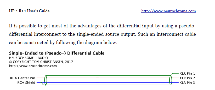

Hello Tom and fellow builders,
I get a nasty hum when PE and the ground connector of the Power86 are both connected to the chassis. When unplugging my single ended preamp, Linn Kairn, the hum goes away. Likwise, when I disconnect PE OR the Ground from the power86 it goes away.
Any advice is very welcome.
Other than that, the amplifier works great.
