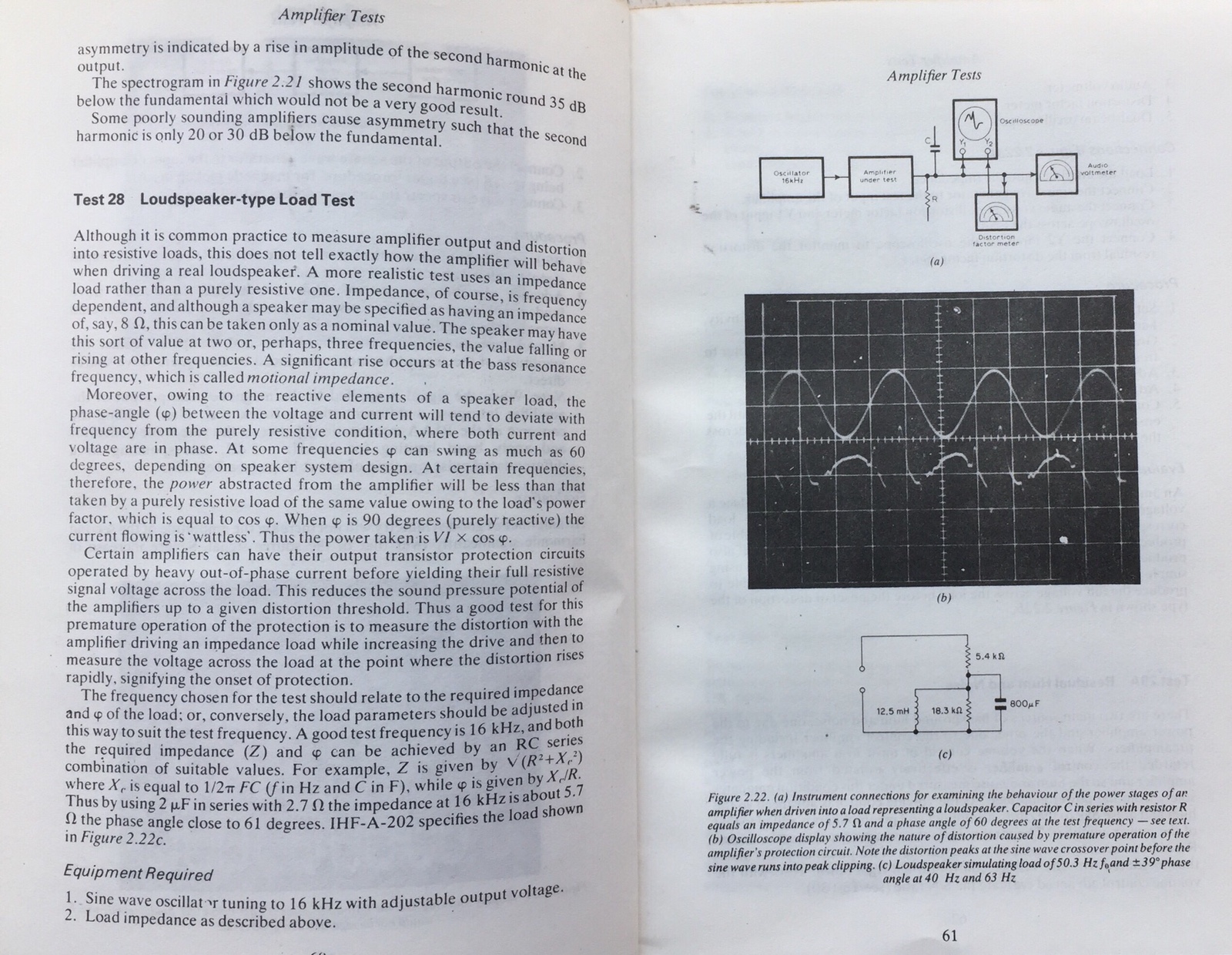

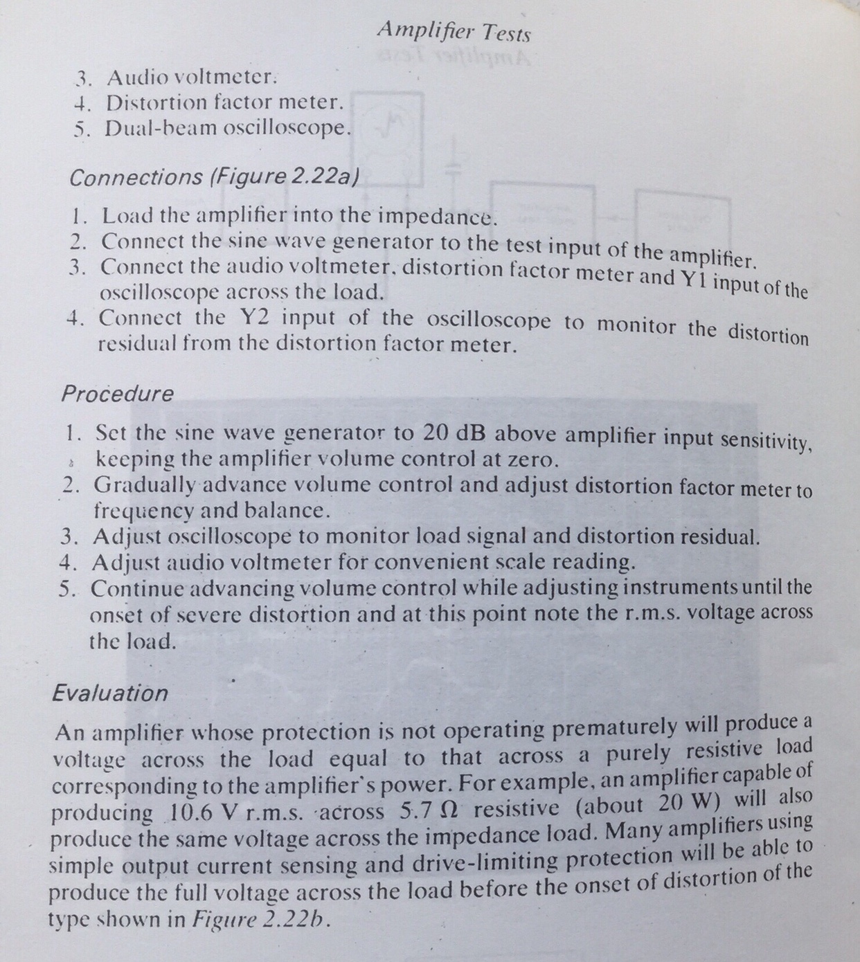

The original FTC (1974) Rule required a pre-conditioning at one-third rated power into each rated impedance.
it was not anticipated it would lead to the (unspecified) 10% THD ratings we see now with many transistor designs, especially offshore eBay boards.
