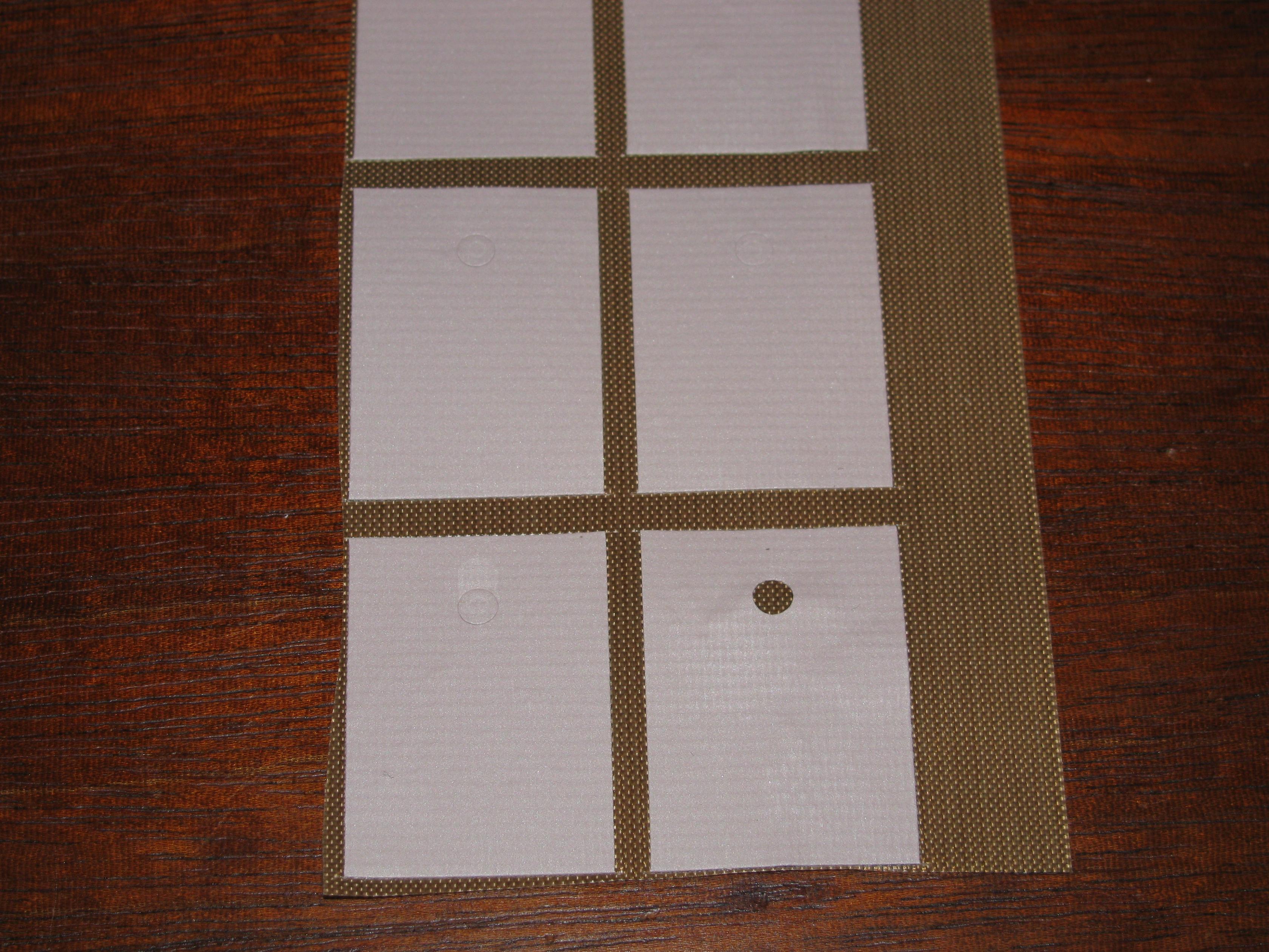

Phase shift pads are a PITA if you have to reposition things. Need isopropyl or other solvent to clean up, plus you have to remove when warm, or risk breaking your device (dont ask how I know....)
Try the Keratherms....Love them on Class A First Watt builds...
Keratherm Transistor Insulators – diyAudio Store
It's nice material indeed. You can see the data sheet here: http://www.kerafol.com/fileadmin/us.../01-standardfolien/Datenblaetter_TM_86_82.pdf
Tom
Tom
They do have a single mounting hole.
Yeah. I took a closer look at the DIY Audio Store photo, which revealed the little punch-outs for the holes.
dimensions are 3.2 x 2.3 cm
A little larger than I'd like, but large enough to cover the LM3886 and the additional length is easily trimmed off. $19 for ten is a pretty good deal.
