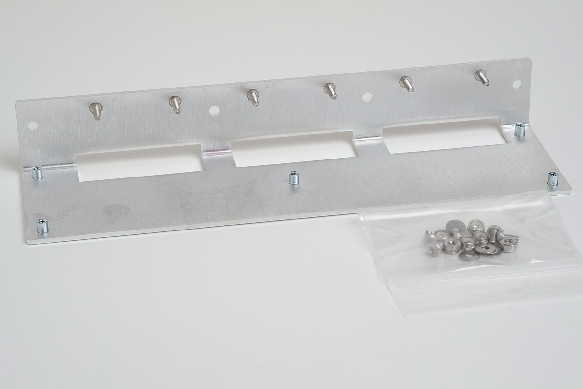

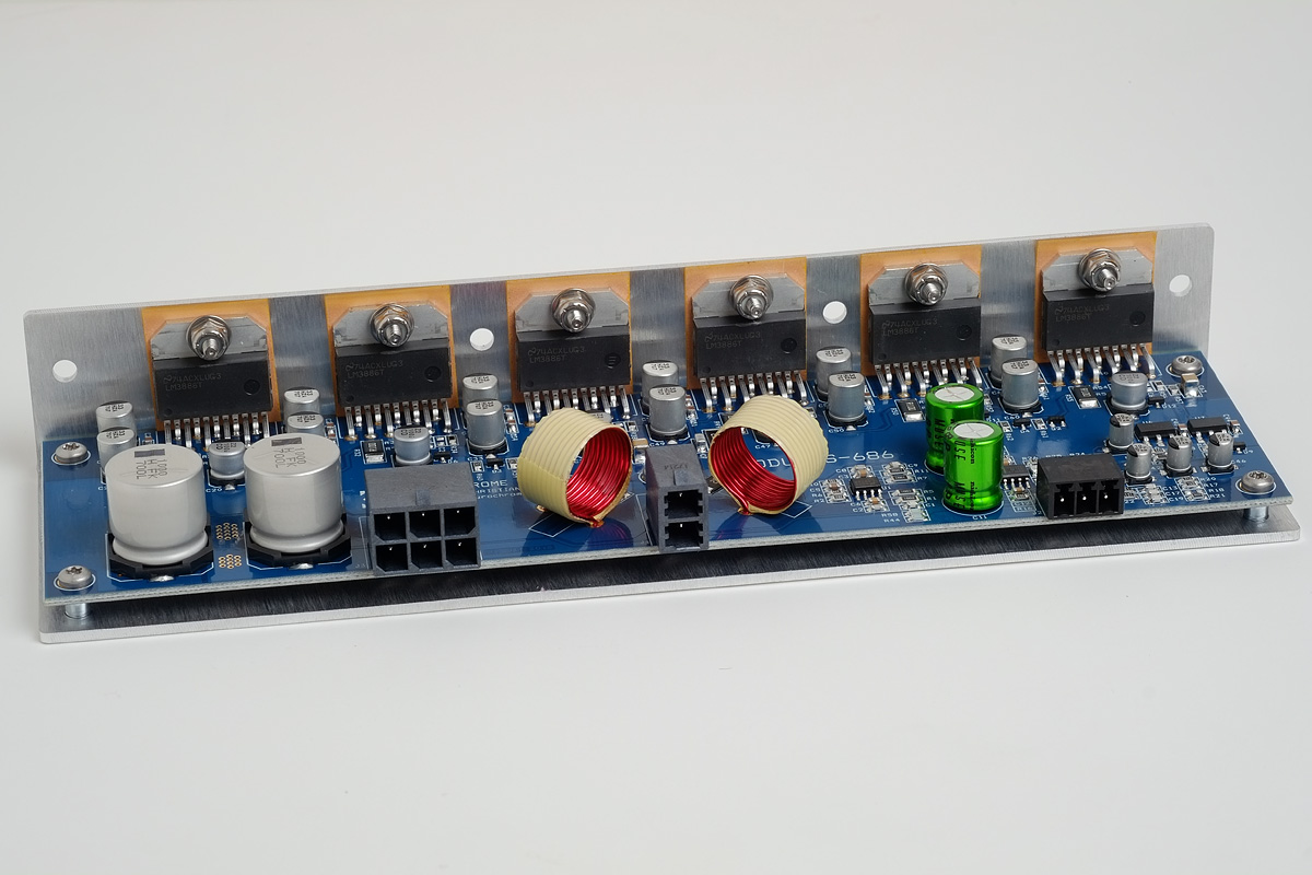

Yep. That's the fully assembled and tested Modulus-686 option. The only thing not shown is the wiring harnesses and the input connector plug. They're included in the price of the fully assembled product.
For those who wish to build their own but still use the mounting bracket, I'll be selling the bracket as a product option. The bracket will come with the mounting hardware (screws, nuts, washers). You'll still need to provide the thermal pads, shoulder washers and additional components to go from the SMD pre-populated board option to the full build. Those bits add about $50.
Tom
Tom
I am wondering, perhaps hard anodizing on the heat sink would provide for sufficient insulation, but I guess I need to check what the thermal resistance of something like 35uM thickness would be. I remember in the past, when mica was used, we would rub the surface of the contact point to remove the anodized layer. So I am wondering what the options are to further lower thermal resistance .
