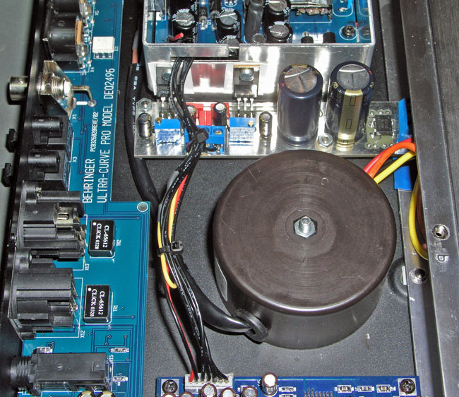

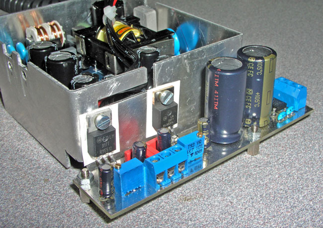

ryssen said:Do you have a schema of your mod?
Not realy but it's not difficult.
First build a small 15V PSU using LM317 and LM337. I use a 2x15V 15VA toroid. Fix it a the best place depending of the PSU size. Be sure to isolate the LMxxx and the PCB from the DEQ box. You will not need a large cooler for the LMxxx.
On the power cable cut the first RED cable (+15V), the second black cable (-15V), the fourth black cable (analog GND). Connect the + and - 15V from the DSP board to the new PSU. Connect the new PSU GND to the GND cable coming from the old PSU and the GND cable going to the DSP board.
That's all.

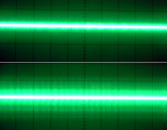

With the new PSU, you reduce the noice by x10, have less heat on the old PSU, and more power for the analog and digital circuits.

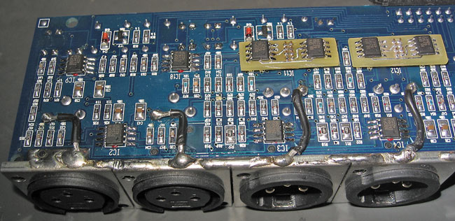

New op-amps for the DEQ2496.
Input: 3 x BB OPA2134 (on the left).
Output: first I/V stage from AKM using four BB OP627 soldered on home made adapter and final stage using two BB OP2604.
The small adapters are only 5 millimetres tall.
The coupling caps have also be replaced with Blackgate PK serie.
Great mod. No more noise and great sound.

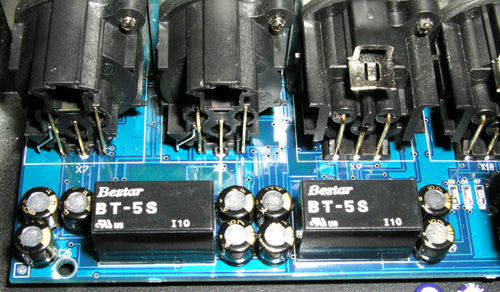

ryssen said:Could I remove the digital input transformer,sins it is 1:1 and take the digital direct to dac input?
Why would you want to do that? The transformer provides ground isolation. It is a barrier to digital noise, EMI, and ground loops. You want to keep that noise away from the DAC.
