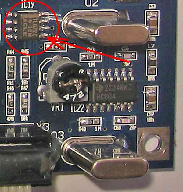

what does it do this amplifier - TL072 ?
