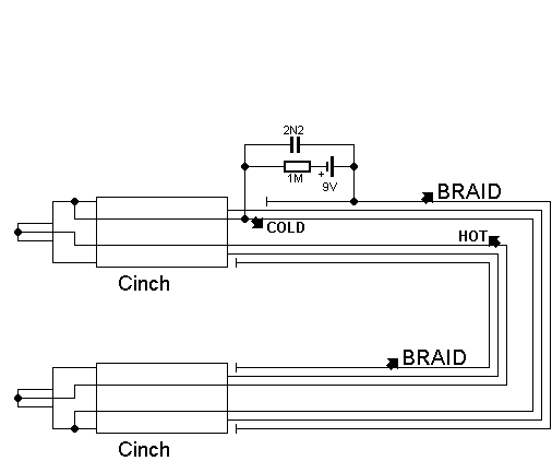

Want to try somthing trick on ac input sheilding. I cant stress how important sheilding and rf filtering is with digital.
http://www.dhtrob.com/schemas/afbeeldingen/Cinch.gif This is somthing I am about to try.
I'm working on a Power Board with filtering.
There are plenty of people who don't have my problem, I'm not sure if its the configuration I am using. I'll build the filter & then see how I go.

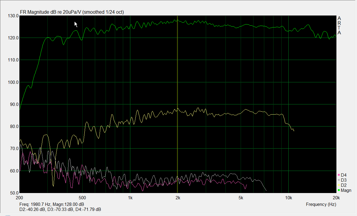

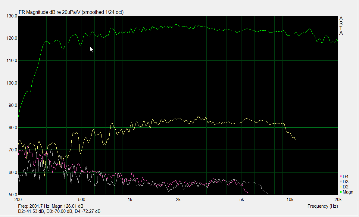

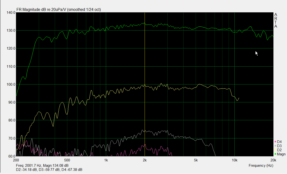

FWIW, I ran a little measurement test with my TAD TD-4001s. I use a ATI 602 amp, its the best comercial amp I have found wrt to SNR and it has gain control on the back.
Ignore the dB Scale, I never calibarted the exact voltage levels in ARTA (think of 120dB on it as really 90dB). The MiniDSP does not really effect the signal chain that much. The DCX definitely increases the output by around +6dB and also increases distortion levels.
TAD + ATI 602
TAD + MINIdsp (unbalanced) + AT 602
and for reference of with the popular DCX
TAD + DCX + AT 602
