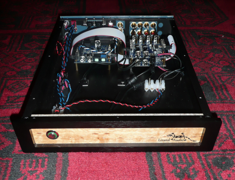

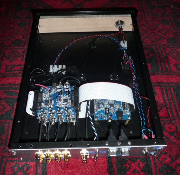

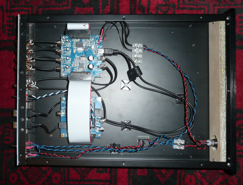

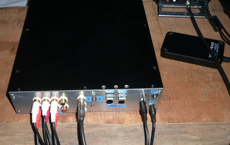

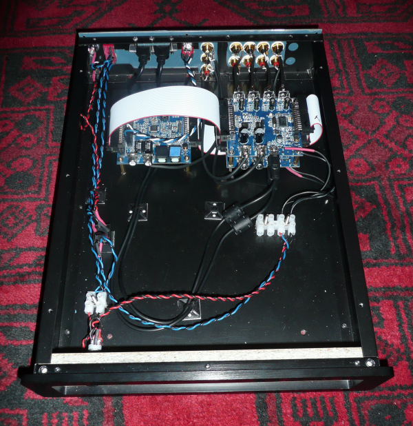

Hissing Noise In System
My MiniDSP setup is injecting a hissing noise into the system & I have no been able to work out what is causing it. I have tried it with my 2 amps & it is the same with both. I don't think it was there (cant be sure) when I was running 2xDSP 2xDigi, Now I am running 2xDSP 1xDigi.
My main (Coldamp) volume control is after the RCA inputs to the amp & before the amp modules with the Coldamp. I have it set so that I am using the last 30% of the Squeezebox volume for adjustment.
When I use the Integra Receiver as the amp, the Squeezebox it set on 100% volume & I use the Receiver volume for adjustment.
Both amps product the same hiss, except the Receiver is worse.
The DSP's channel Inputs are set with no attenuation & the DSP outputs are set to level the driver but have very little attenuation overall. So If I understand Gain Structure correctly, that shouldn't be a problem. I'm definitely not the only one that has this issue as I have read about numerous similar problems in the MiniDSP forum, I am also aware it is not a global problem
I normally run it off a 12V External Hard drive PSU, But have tried it with my 12V Kingrex Linear PSU and the noise is the same.
I have tried pulling it out of the case, triple stacked it as per instructions, shortened the link cables, & mounted it on a piece of wood as it was in the 2xDSP & 2xDigi setup.
Nothing has worked, can anyone help?

I had similar issue when I first tried to introduce one miniDIGI and it appeared to be due to the plug-in installation process.
Have a look at miniDSP forum but in few words, I didn't follow ALL the steps described in the installation guide. In fact I forgot only one :rolleyes: that was to reset configuration before installing plug-in again.
Hope this helps.

I had similar problems which are now solved.
Follow these steps:
1. Reduce the output volume of the miniDSP by -20 db, for all channels.
2. Make sure the units are sealed from RFI (Looks like yours are already)
3. Use a non-switch mode PS
Hope this works for you!
Matt
Thanks for the input, I think reducing the output -20 db is just masking the problem that still really exists, I need to go & reread the gain structure artical in this website to check I am doing it the right way.
I have tried a well built linear PSU but it didn't make any difference & as you say I think I have the RFI under control.

Gday You want to think about shielded power supple cables. And perhaps a cmc or 2 in there. What earthing are you using? Rf can get in that way too. What input impedance are you using? Perhaps you can put a 600 ohm resister in there if you driving with op amps or buy some trans.
I'm working on a Power Board with filtering.
There are plenty of people who don't have my problem, I'm not sure if its the configuration I am using. I'll build the filter & then see how I go.
