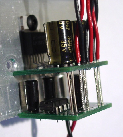

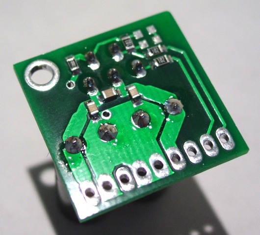

Bottom of LM1875 board.
Hi Brian!
For my lm1875, I'm currently enjoying this: http://www.alliedelec.com/Images/Products/Small/928-8566.jpg (20, 0, 20 ac and freakin' huge), plus 4700uF per rail and a discrete Motorola MR rectifier. For reference: I do have 8 ohm speakers and big heatsinks.
But, I was thinking of "shrinking" the rather massive power supply down to size.
Would a 10 amper KBU1004 mini-rectifier and 4 of 10nF caps, be a good place to start? The caps across each diode can lower the peak voltage a bit, and then. . . What about the 21 -0- 21 toroid for $12 on this page? http://www.apexjr.com/miscellaneous.html
Hey, that's just a comparison and some ideas that I'm pursuing. Any suggestions?
