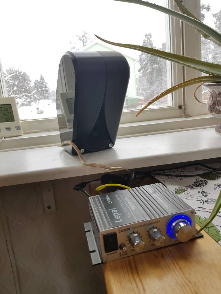

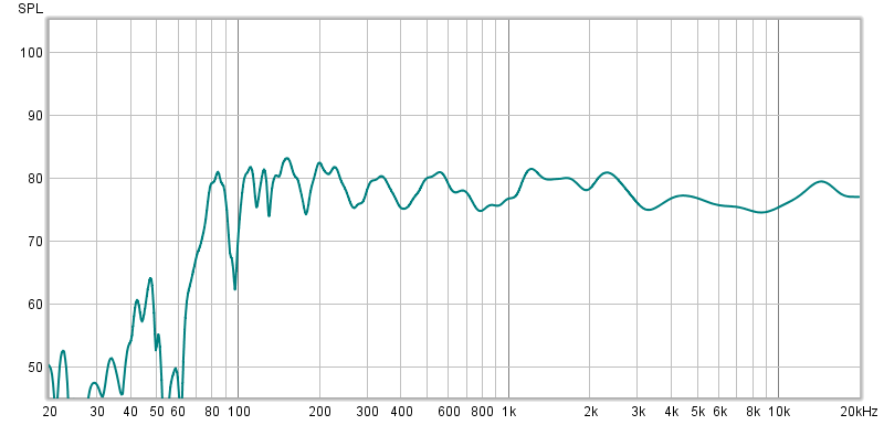

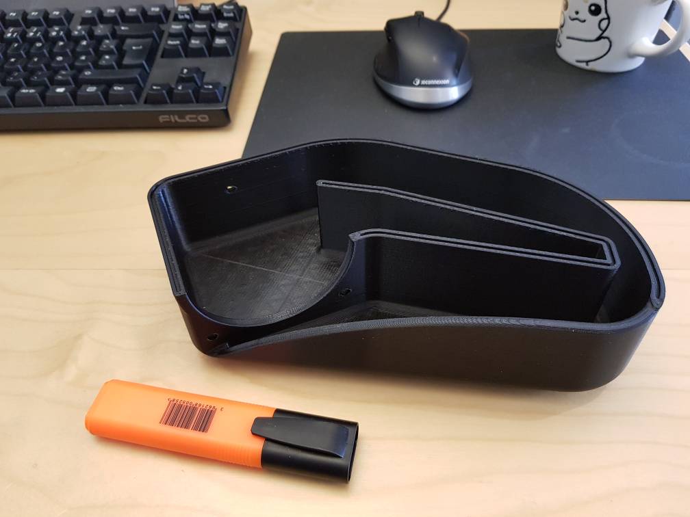

Some cool work by elleman with an all 3d printed mini 0.25x Karlsonator for 3FE25 over in this thread:
Desktop TL / BLH with 3Fe25
Although only 0.25x scale, seems to reach 85Hz! Some EQ applied to flatten a 600Hz panel resonance peak.
ellegant ! Tooppy - I want the mini-Karlson type vs Karlsonator as have 6.5" speakers with fs around 100-110Hz and wish them to play very loud without failure. Tuning will probably be above 100Hz.

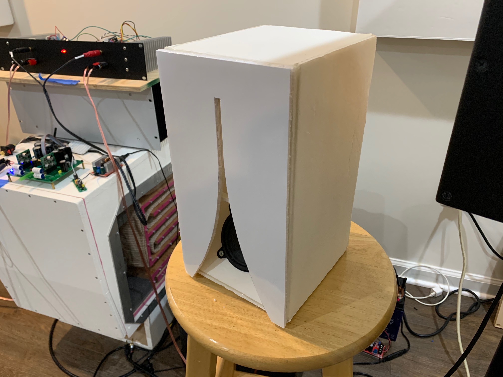

I took out my old 0.40x Karlsonator today, these were the original ones that started it all. They have 3FE25-4 drivers in them. Gave them a new facelift with a fresh (now second layer) sheet of high quality Elmers brand foam core (shiny faced) - made it like a new speaker again. Looks great and sounds even better with double layer K-aperture.
Listen here:
XRK Audio on Instagram: “Revival of the original 0.40x Karlsonator with 3FE25-4ohm driver. Sounds pretty good full range, no EQ or BSC. #audio #speakers…”
This speaker is heading off to Texas tomorrow.
Listen here:
