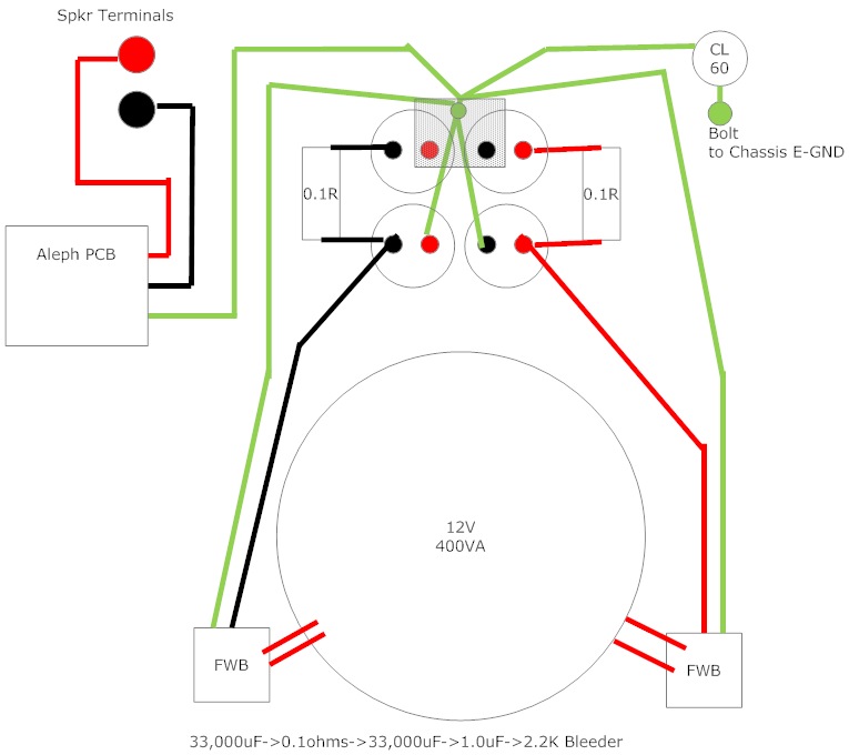

Hi ZM,
I rotated the toroid and cap bank. Does this wiring look correct
for the grounding?
I'm kinda confused as there has been few different ways to wire it.

that looks good
that looks good
Thank you sir. All rewired and hum is still there.
The hum is only heard when placing ear next to speaker.
About one foot away, I cannot hear it even in a quiet room,
ambient noise is louder.

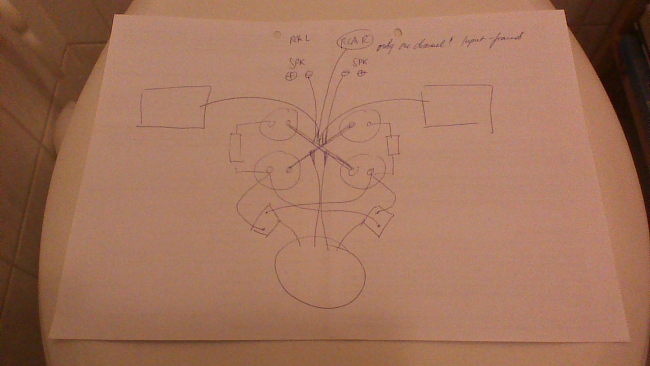

May be, you could reduce the hum a little bit more.
Whether ground-star or rgound-plate should be necessary: do not regard my/the graphed star.
RCA only one channel to ground.
Speakers at the star.
Final I - my opinion - both windings for (+) and (-)

Assuming the main difference between the two transformers mentioned would be their stray magnetic field, swapping them would make very little difference I think. You've moved the transformer away from the circuit and there was no notable change in hum levels, right? That would indicate that the circuit is not picking up a stray field from the transformer, I'd say.
You've moved the transformer to the other side of the capacitor bank. That should have taken it outside a potential ground loop. No change in hum, so again indicating that the circuit is not picking up a stray field.

Thanks cumbb. The speaker - output tied to star ground is what I had
originally.
The input signal ground wiring scheme looks like what I use in tube pre amp.

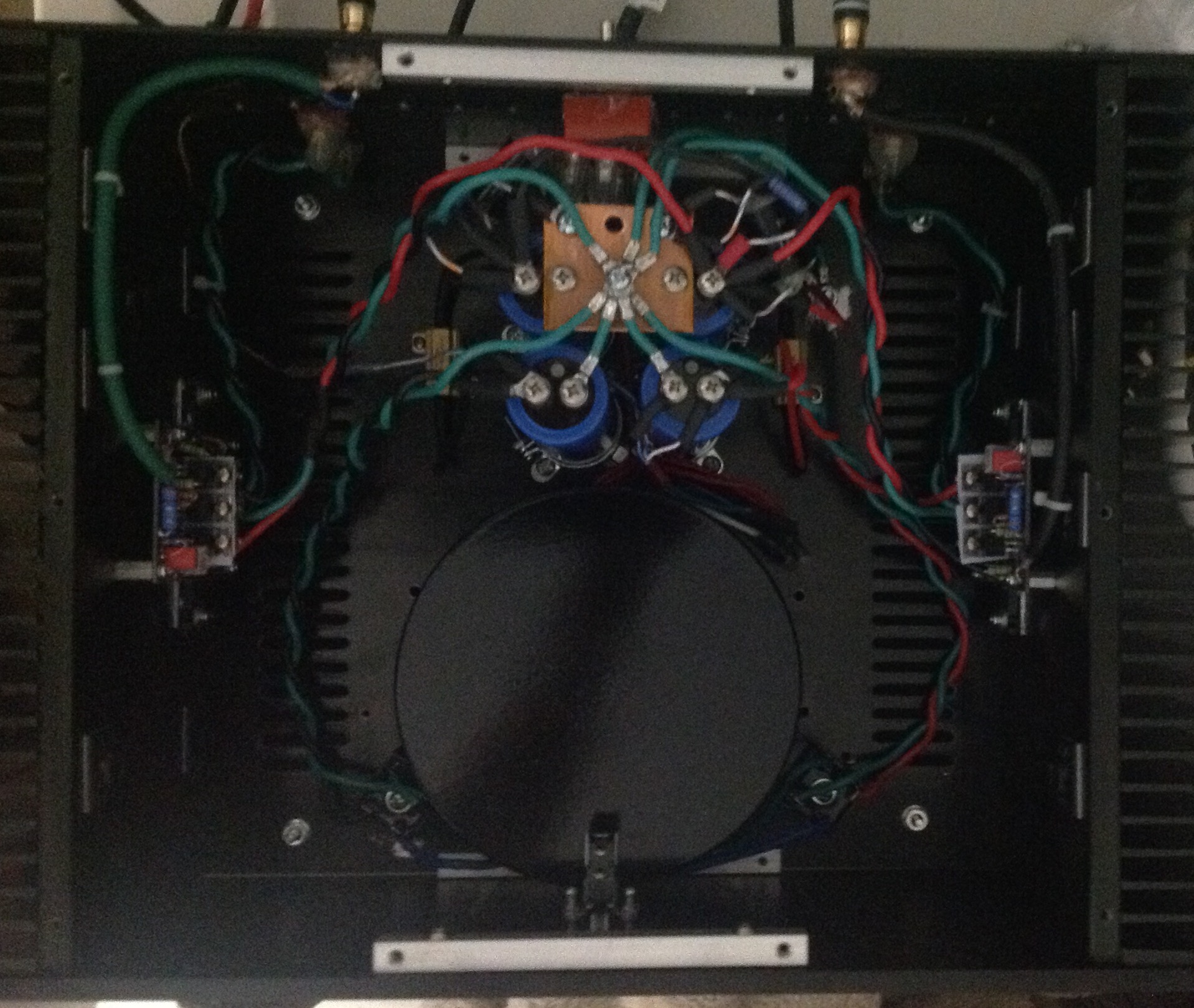

My final question is if I swap out the Antek 12V 400VA toroid with
a Piltron one, what are the chances of the hum reduced or go away?

Most "hum" problems are due to wiring incorrectly.
That "star ground" in the middle of the smoothing capacitor charging plate could be the culprit.
You must completely separate the capacitor charging circuit from any/all audio voltage references !

the 0.0mVac to 0.3mVac is Hum+Noise at the output of the power Amplifier.
It is not the ripple on the PSU supply rails.
Going back to posts93 & 95
I said
You must not take any audio grounds or audio references from the middle of the charging plate.
That is one of the dirtiest places inside your amplifier.
