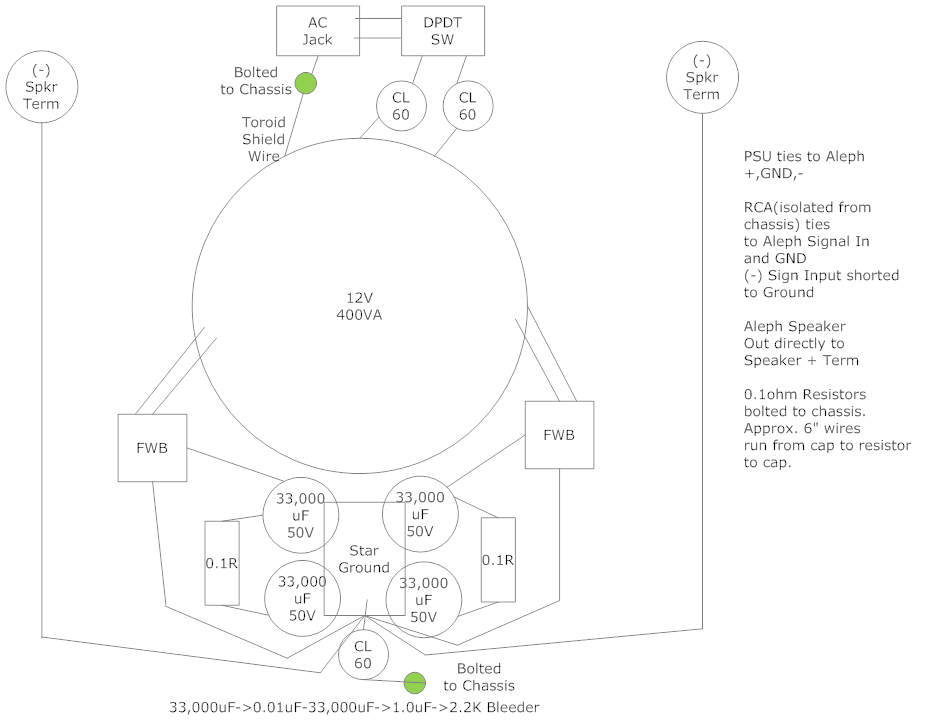

Thanks Dennis. I used snap in caps for all builds, this is my first with pc grade caps so wanted to rule that out. I do kinda have long wires, 6" or so from cap to .1ohm,
any issues with that? the power resistor are mounted to the bottom of the chassis
hence the long wires.

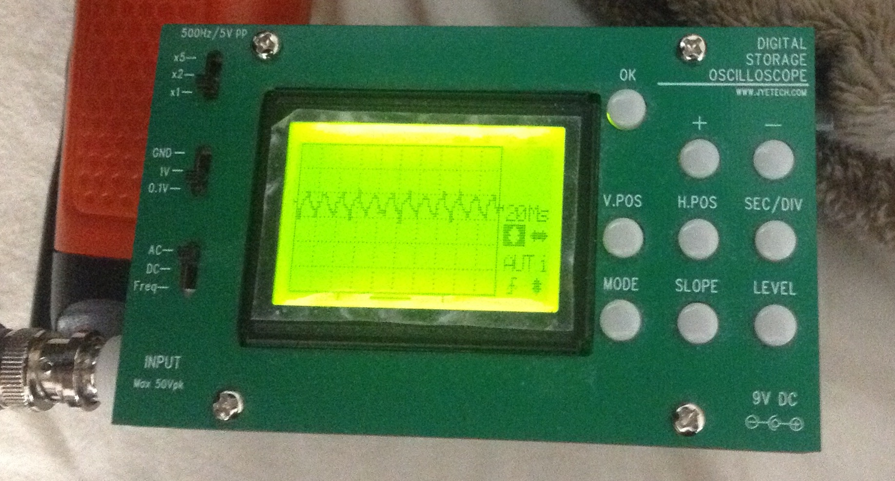

I disconnected both aleph boards, power supply is floating, well it has 2k bleeder resistors out the output caps. With my toy scope, I'm seeing around .1Vpp AC with ref to ground
on both plus minus and ground terminals. this is pointing there is no hum from toroid and cap filter?
so hum is caused because of some incorrect wiring some where when it's hooked up to the aleph boards?
measured at power supply outputs

If you're measuring about 0.1V of AC on the output of the caps, I would think that's
pretty good.
With the input grounded, can you measure any ac on the amp's output?
Just noticed 0V1 ripple with NO LOAD.
How much ripple with 1 channel attached? And 2?
Perhaps faulty caps?!

I will post a wiring diagram of the grounding, you can let me know if it's ground loop related.

wiring diagram attached. I can hear the hum about 1 feet away from
tiny test speakers with the toroid/CRC psu. So on 94dB speakers it
must be quite audible.

Hum from power source (50-60hz) --> it mean problem from power supply .
Aleph class A is so simple and get so much unstable about current & temp.
1, How much current bias now? Did you try reduce bias ~ 100mA? and see.
2,Look photo ..why they twist 02 wire ( 01 line) it is wrong. Just twist (+,-).
