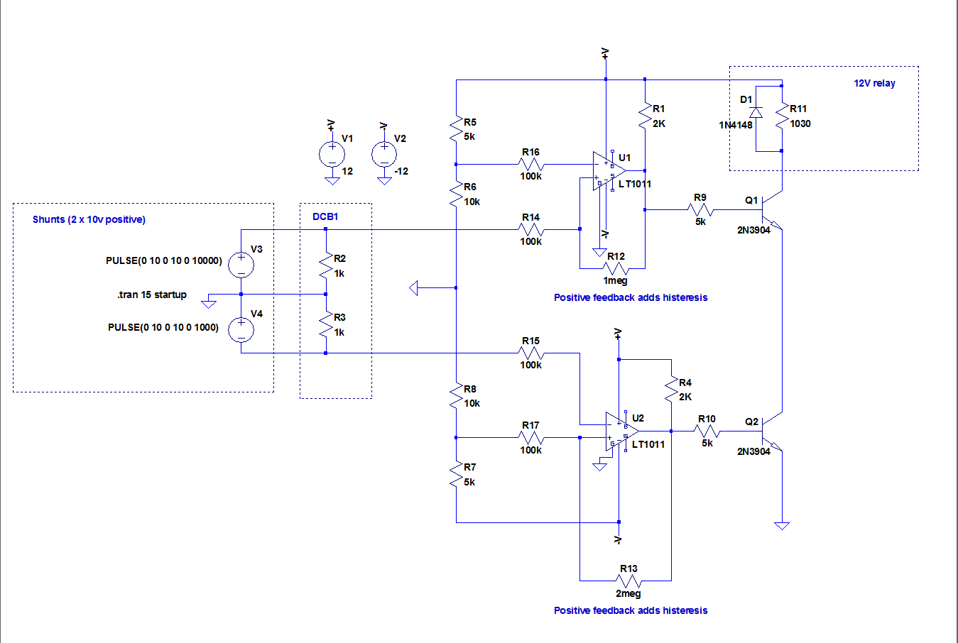

My latest effort regarding a prot circuit that only opens dcb1 output after both shunts show more than 8 volts.
It uses comparators with histeresis (because salas shunts take time to settle)..
Not sure what value should I use for input (R14 to R17)... I want min inpact on the shunts so the protection circuit does not leave a perceptible sonic signature.

Not the DCB1 integrated shunts we should clarify. Those settle fast, are fixed voltage, straightforward, also having a very reliable record. You are referring to V1.2R with regulated output fed BJT cascode CCS "tail" and "kick starter" Zener. There is the JFET cascode tail example too that needs no kick starter because it auto biases. Its a tweaky non fixed voltage regulator I designed in 2010 and can be found in the simplistic regulators general thread. Links are available a few posts back from here.

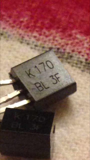

Hello everyone. This is my first post so please bear with me. I am new to DIY; I built the ACA first and then Tavish designs Classic tube phono preamp. So now I have embarked on building the DCB1 with the Mezmerize board. I try to find answers to most of my questions by searching this site but I've run into an issue with some SK170bl's I bought recently from a source cited as reliable in this thread. I'm using Salas's Idss measuring method, thank you btw Salas. G & S shorted connected to -, drain to 10R resistor then to + using 9V battery. Using I=V/R I haven't gotten anything lower than 14.9 mA. So, either I am measuring wrong or these are fakes. The vendor has offered to take them back and refund my money but I just wanted to check with you guys first. Maybe I am not testing them right. However last night I saw another post by Salas saying real ones should have a 1 like an "l" and the 7's tail should be slightly curved. Mine aren't like that. If you guys agree they are fake do you know of any reliable sources?

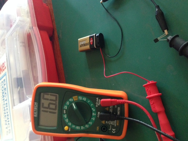

What model meter you use? There is a chance the DMM gives rough mV readings on the 10R voltage drop that can easily mislead the mA calculations by much because its a very small drop. Put the meter selector to series mA mode and the black probe in the mA socket to measure current flow between B+ and drain without any resistor so to confirm the initial indications. Watch it with the probes not to short the battery through the meter though because its internal mA socket fuse will blow.
Tell us the results and attach a close up picture of those JFETs also. Then we will be able help you reach a safer conclusion.

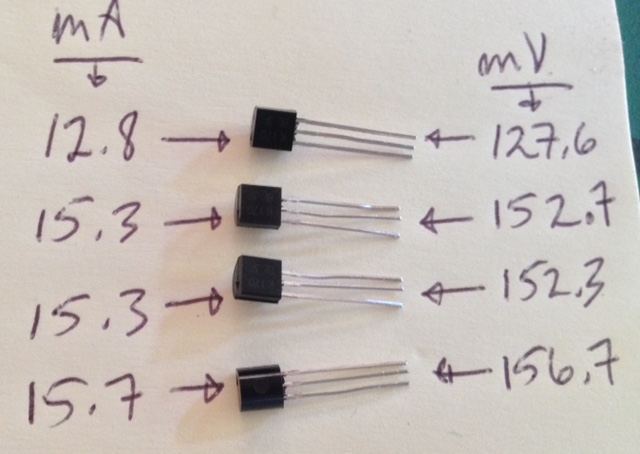

Thank you Salas. My meter is an Extech MN35. I measured four of them for current without the 10R as you suggested and got 12.8 to 15.7mA. Three of the four were over 15. To double check I measured V again with the 10R. I'm attaching a pic with results. Also attaching my test setup just to make sure I had it right. Also a close-up of one them.

Surely not the right JFET product. The budget Extech meter proved consistent. The series connection mA test looks properly wired also. Alweit from Israel sells matched quads on ebay at about $15 with the postage. People say they are OK. I don't know if Tea could also help you with any spares outside his mini kits or if Andrew still has proper Idss LSK170 matches for dcb1 use to offer. Spencer of www.fetaudio.com used to be a good source also.
