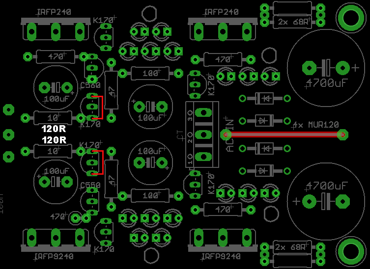

When there is a problem with sourcing good semis you may test an alternative I just thought for you regarding the Mez PSU section. Use Fairchild PF5102 (currently in production) for all the JFETs except those two next to the 10R resistors places. You omit those two JFETs. You jumper their outer pads instead with short wires and you use 120R instead of 10R next to them. The resistors value change is mandatory, not something to be left for later. 100R is acceptable too. Don't try other random values. See attachment.
Salas: To be sure that I do not misunderstand: The Fairchield PF5102 are subsitutes for the SK170 in the PSU section only? The SK170 BL that are noticed to be matched, should they still be the "real thing" or is there some subsitutes to be used for them as well.
I still have some of my "old" and real SK170 BL left, but since I am building as much as four(4) Mezmerize, I will be in shorts of SK170 BL. I will use this four Mezmerize as buffers before the amplifiers in my 4-way active speakers.
Eivind S
Yes, substitutes for the PSU area only. Going along well given you will also perform that specific simple mod I attached. Don't worry when you will see in the datasheet that they are not pin compatible, because due to the way they are connected in the specific circuit positions the G-S or S-G pin order amounts to the same result. The audio signal path "JFET quartet" should be the real thing or the Linear Systems clone. LSKs are on the diyaA Store but graded not matched. Andrew used to have some LSK matches I think, not sure if anymore, ask him. There is also one ebay guy "alweit" from Israel that people say has genuine matched pairs. I don't know if Tea-Bag could also help you out, ask him.
