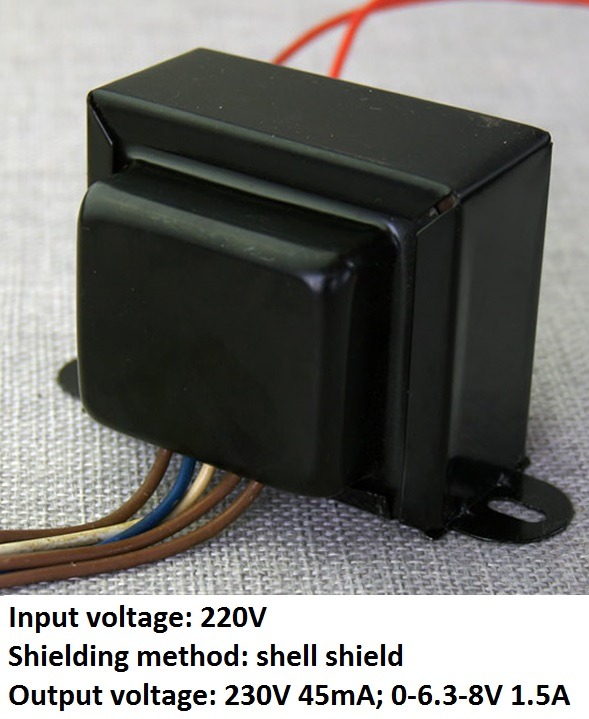

When using the ECC82, the total heater current is only 900mA.
this transformer could fit: https://aliexpress.com/item/1005001496708765.html
The 8V~ (after rectification and charging of the electrolytic capacitor higher!) are sufficient for regulation to 6.3V.
unfortunately high shipping costs, so I would prefer a 2-transformer solution!

This one is close, apart from the heater ...
Toroidy TSTA 0040/001
Around €55. In the past I have found Toroidy to be very amenable to altering windings at a reasonable additional charge. So it would be possible to specify a 4.5V-0-4.5V heater winding, or 0-6.3V-9V perhaps?
Maybe with a guaranteed order of so many units they would make a batch for the standard price?

Nominal power | 40VA |
Input voltage | 230V or 2x115V |
Secondary SEC I | 235V / 75mA |
Secondary SEC II | 3,15 - 0 - 3,15V / 3A |
Depending on the country, add 23-29€ shipping costs and then with a heating system that doesn't fit, no thanks
for 30 € including shipping there is the transformer from aliexpress and the heating voltage also fits
