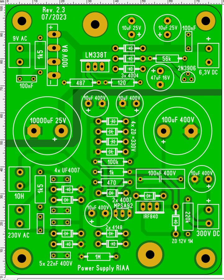

This old thread seem to be report the latest version for both phono and power supply : https://www.diyaudio.com/community/threads/gb-merlin-riaa-pcb.338606/ , may be snapper have used as reference. I there anyone than can give transformer characteristics ( power and seconday voltage/current ) ?

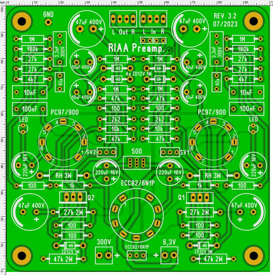

From the original design in Merlin Blencowe's book (Designing High-Fidelity Valve Preamps) each channel has a PC97 and one 12AU7/ECC82.
The version being discussed here can use either a 6N1P or a 12AU7.
The current version specifies a 230Vac winding for the plate supply and a 9Vac winding for the heater supply.
PC97 plate current is about 3mA.
6N1P plate current is about 5mA per triode.
The MOSFET draws about 5mA, I believe.
That's 13mA plate current per channel, so 26mA plate current for the preamp. I'd choose a 230Vac winding rated for 40mA or 50mA, so about 10VA to 12VA.
PC97 heater is 4.5V 300mA. There are two per preamp, so 600mA heater current.
6N1P heater is 6.3V 600mA. There is one per preamp, so another 600mA heater current.
That equals 1.2A heater current for the preamp.
I'd choose a 9V winding rated for 2A, so about 20VA.
For Old World folks, a 230V:230V isolation transformer could be used for the plate supply. It doesn't need to be a big one. 230Vac 20VA would be plenty. A 230V:9V 25VA toroid will work for the heaters.
For those in the Americas, Antek sells a 9V 25VA toroid and a 240V 50VA toroid. Triad Magnetics makes a 230V:115V 50VA isolation transformer that can be turned around to step up from 115Vac to 230Vac.
