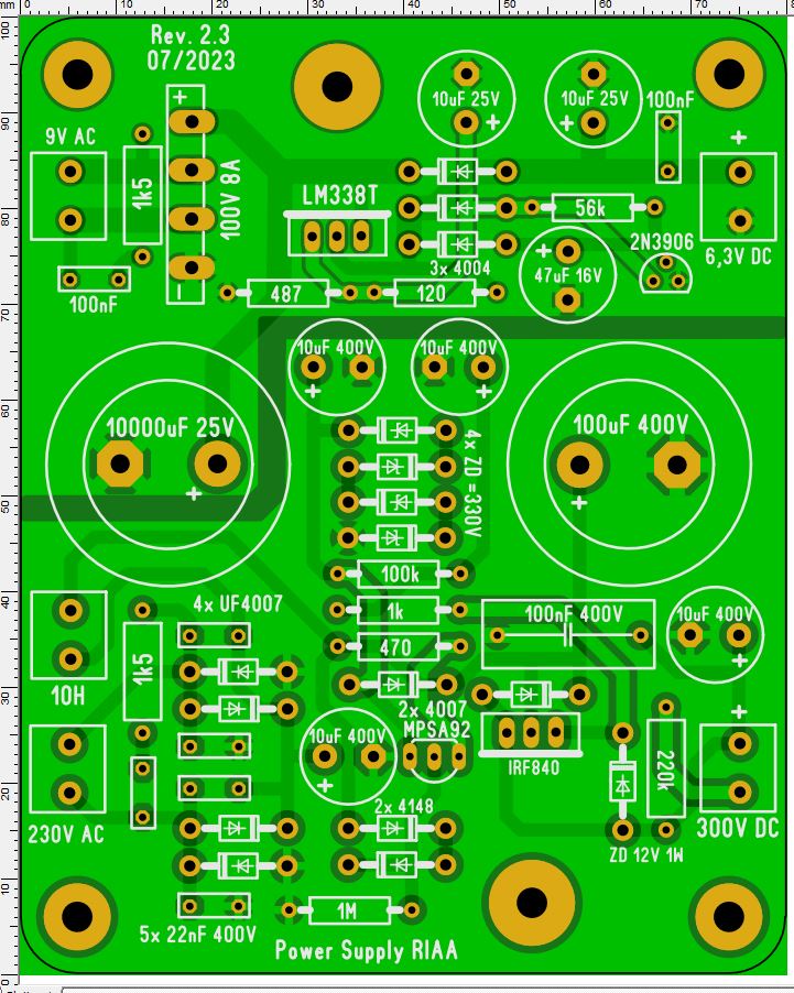

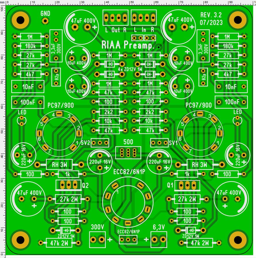

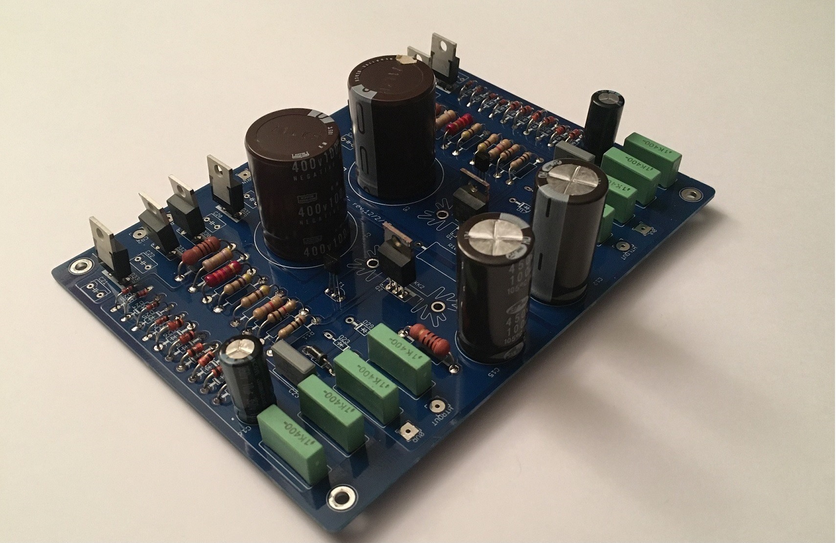

Wondering how others are coming along with their boards? I have a power supply and most of the RIAA board ready now, missing some hardware but able to do some testing soon. The power supply is tested and it seems to stick at around 289V, which is the same as the simulation. (Anyone interested in that?).
I found the PCB was not so forgiving of errors. I wanted to swap some electrolytics that had the wrong raster to ones that fitted right and managed to lift a trace. The tight hole and the ground plane conspired to make it hard to get the heat to flow enough to just lift the part. Otherwise it has been a very Zen experience, trying different combinations of top and bottom placement of parts. Now I need to plan the enclosures.

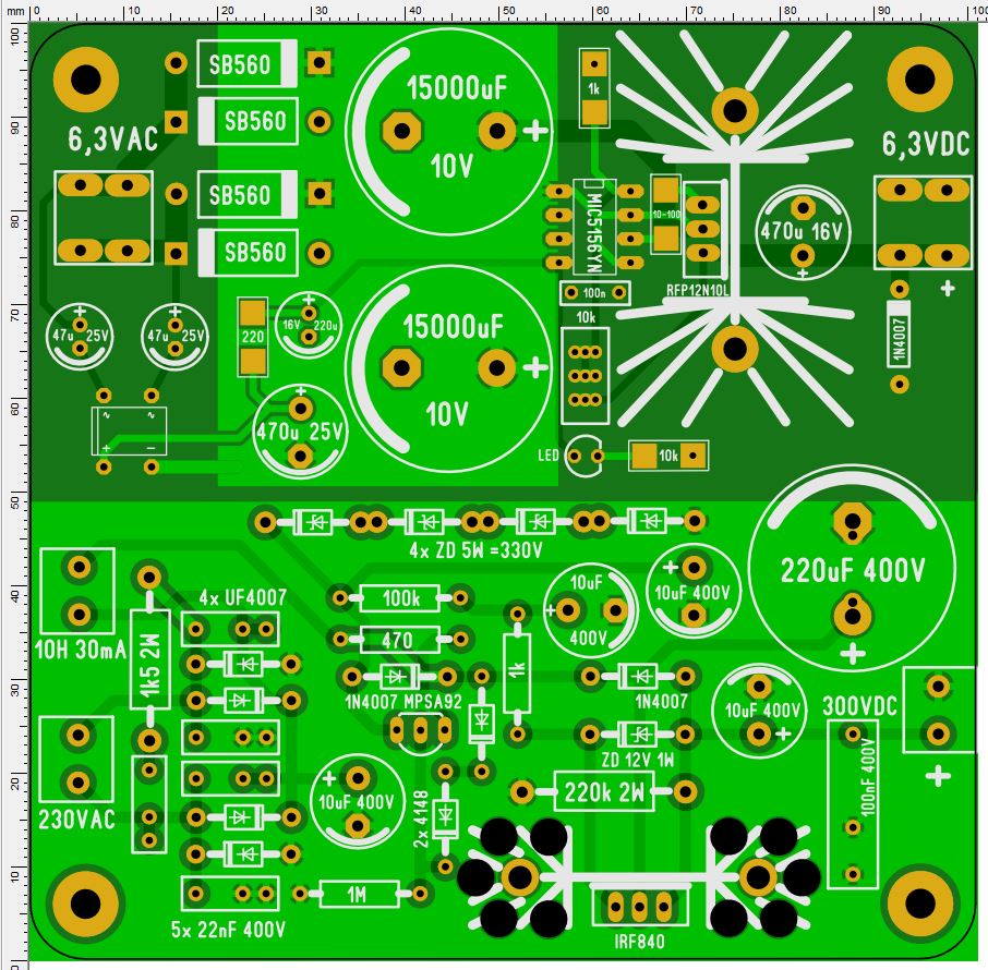

Hallo, I am interested too for a pair of pcbs.created a template. If there are enough interested, I can have a few circuit boards made.
View attachment 1197233 View attachment 1197232
Thinking about future versions of this project, wondering is anyone has see @v4lve lover 's boards that provide 6.3VDC at 2A from a 6.3VAC supply.
Unless one uses different transformers, or has a custom one provided, the requirement for a 9V secondary is a bit of a restriction. Would it be worth incorporating this type of solution on the PSU board?

What about BS107G instead of that ZVN0545A? It may also be obsolete, but in my case it's a good option, I already have few pcs. from an old project. I the reverse transfer capacitance is the only important matter, in this case datasheet says it's 6pF. At least the OnSemi version...
As I think about future versions of this project, I wonder if it would make sense to integrate such a solution on the power supply board?

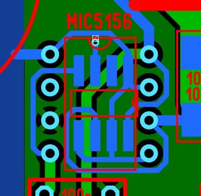

I have made the (modified) Gerber data available (for the 6.3v part of this circuit) for download here in this thread

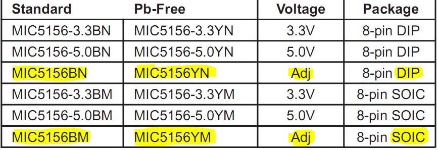

6.3VAC to 6.3VDC LDO supplies MIC5156 based tube amp upgrade
Hi SnapperIt could then look like this, MIC5156YN is just another circuit that is not available anywhere!
Has the circuit board in the attached picture been tested? Does it work? I need a compact circuit like this. Both low voltage and high dc voltage together. I would be happy if you share it.

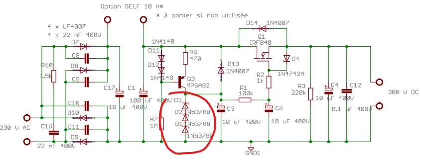

Is anyone building this with the 10H choke? If so what resistance are you using and how does that impact B+? I saw Marc originally tested with a 10R resistor and he said he heard little difference. Anyone else tried that?

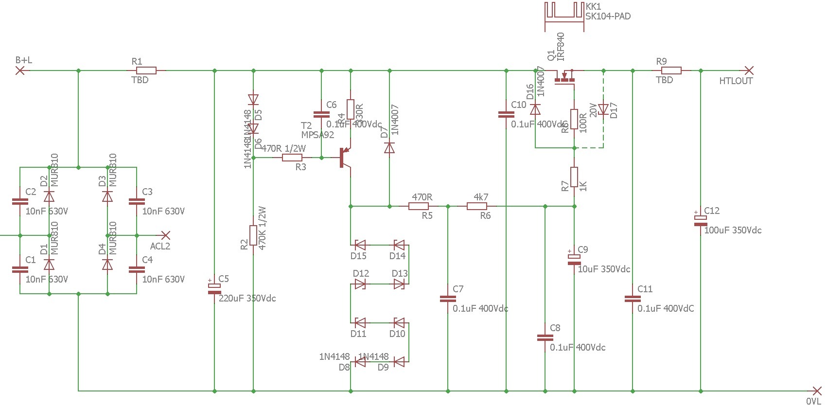

It seems the same circuit I done years ago and published also here
The main issue is the use of 100 uF after the possible inductance
Take a care with ss rectifier and the inrush current
I suggest to use a 100 ohm resistor
With this topology the ripple is dead
