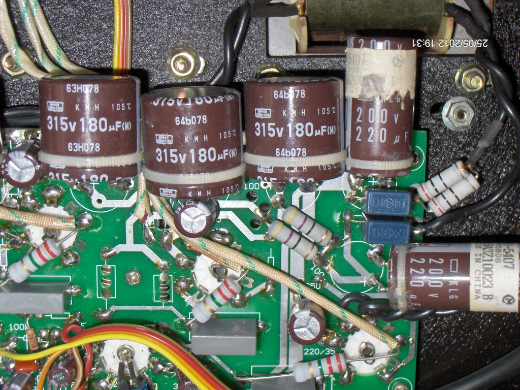

MengYue EL84 capacitors question
Lifting up the old thread to ask if anyone has tried or have an idea about those caps, especially four 315V 180uF, those are quite mistery to me and can't find any that are same or even close these spec.
The other two of 220uF 200V I will replace with Nichicon Electrolytic Capacitors, as the originals are either old or damaged.
Thanks Ian, appreciate your feedback. I know that higher voltage is in fact even recommended, but the problem could be the size of those, at least for one because it's too close to transformer. I found NIPPON 450V 180UF that could fit in. Just wonder why they did put such odd value of 315V caps?
Must inspect more closely all interior and will probably replace all the other caps, including those in signal line, and see if I can make more room.
I guess they had 315V caps available, or had them made. Yes it is an unusual voltage rating, but does the job. I'm still running the originals. Regarding heat, most caps are rated to 85 C and I doubt this amp will ever get that hot. The signal caps should be OK, in fact, I never heard any noticeable improvement from changing any of the caps in my amp. I still have it running, its one of my favorites, but the circuit is not standard.
180uF/350v/ 105c
381LX181M350H042 Cornell Dubilier Aluminum Electrolytic Capacitors - Snap In Opps, they don't sell low amounts.
Here we go 381LX181M350H042 CORNELL DUBILIER | Buy 381LX181M350H042 | Onlinecomponents.com
