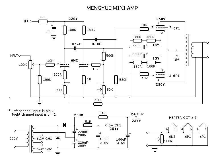

Meng Yue Mini schematic?
Don't know if this is it since yours has EL84 but here is shot
No mine has 6P1-14 or somesuch (haven't actually got the amp yet, its in transit to me), so thanks for the pic. I called it a EL84PP clone because I wasn't sure of the actual tubes they use.

The schematic i posted earlier turns out to quite different to my amp.

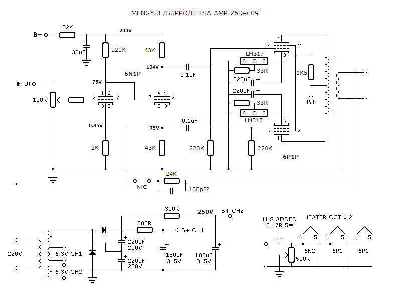

I got inspired by the Suppo Audio circuit and applied it to a Mengyue Mini 6P1 amp. The result was spectacular, very good indeed, especially after replacing the 6N2 with 6N1P-EV Russian tubes. The difference was like night and day.
To do the conversion, I removed all the resistors except B+ and output tube cathode resistors from underneath the PCB. Then refitted the PCB into the amp and soldered all the new parts onto the copper side of the PCB, no traces needed cutting but 2 caps are lifted at one end with a jumper wire to attach them to the correct part of the circuit. This approach is a solution to the difficulty of tweaking these amps, now almost everything is accessed with just the bottom cover removed. My amp was the schematic in the 2nd post of this thread.

Thanks for posting the Suppo circuit. I want to hardwire at some stage but without the actual circuit diagram it would have difficult.

Note that there are several differences between the 6P1 amp and schematic.
So far, the 10K grid isolation resistors are not there.
Symmetry adjustment is 20K, not 50K as shown.
Does not show the headphones connection.
The silkscreen has different resistor values than installed.
Seems dangerous not to have caps on the input, as you never know what is driving it. A small change in input offset would make a large imbalance from what I understand.
You might find the grid stoppers under the PCB (the non-copper side).
If I could suggest any worthwhile modification for this cct, it would be to swap the paraphase inverter/splitter for a concertina/cathodyne or a long-tailed pair. If you remove most of the components from the non-copper side of the PCB, you can reconstruct a new cct on the copper side, maybe a little bit messy, but works fine for experimenting, and very quick to make changes. I have done a LOT of resoldering on my PCB and have seen no signs whatsoever of any traces or pads even giving a hint of lifting, it seems a very solid PCB.
