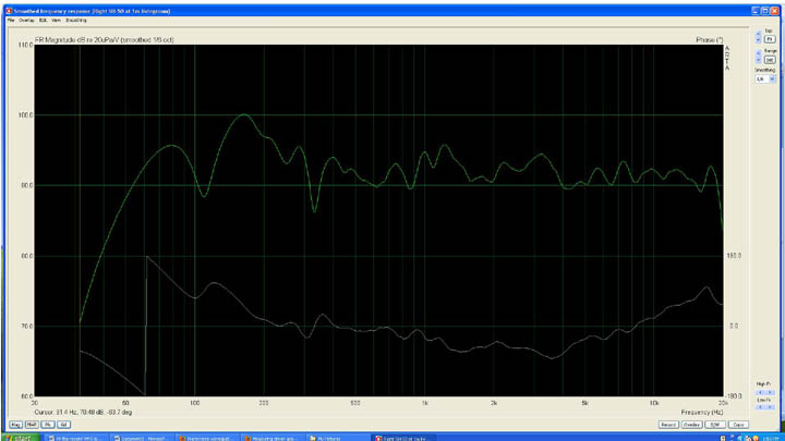

Of course there is uncertainty if there isn't sufficient measurement bandwidth, but there must be no matter what method you are using, including yours. You can't manufacture accuracy out of lack of data.
With the excess group delay method its easy to determine the limits of accuracy though - simply measure the excess group delay of an individual driver with its minimum phase crossover section. (Other driver disabled) We can pretty much assume that any reasonable driver is going to be minimum phase at low frequencies, and a normal crossover section is also minimum phase, so we know that what we should see for excess group delay is a flat line.
When we see that flat line start to curve upwards at low frequencies we know that we're now in an area where accuracy is suffering because of mis-estimation of excess phase for the reasons you describe. (Lack of measurement bandwidth to estimate HBT minimum phase etc)
We know then to exclude this range from measurement, (I cropped it off on the left hand side of the measurement in my original post, below the cropping point it started to curve upwards) or that we need a longer window time.
This measurement of one driver can also be overlaid over the measurement taken with both drivers active at once to confirm within which frequency range we should be sampling the delay of that driver. (Although its usually pretty obvious)

For the single reason that no measured excess group delay can be considered accurate. It is an approximation based upon assumptions.
As far as I can see, as long as the measurement bandwidth is sufficient the accuracy is no worse than any other measurements derived from an impulse in impulse based measurement systems...

Well again, its easy enough to take a few measurements on systems that you've already modelled with your own methods and compare them. I can't do that because I don't have access to your models. If you're not interested thats fine.
This is why I always make a point to say that even the method I describe can only be used for the set of models created because it has to be based upon assumptions related to each driver's SPL response.
While the method I've described makes no particular assumptions about the amplitude response of the drivers, in fact they don't even need to be known, really, since we're only looking at the excess delay.

Here is an ARTA curve from an SH-50 at a meter in a cluttered room with a bare hardwood floor, no eq or correction, passive 3 way crossover. Anyway, the electrical crossovers are around 300Hz and 1100Hz, they are higher order and not traditional shapes but adapted to the requirements of the drivers and their coupling into the horn system..
In front you can’t detect there are different drivers or frequency ranges, even sticking your head in the horn. This design has been in service commercial sound for about 7 years now but only a few have found their way into homes yet..

Wow, this is really impressive. I had heard of these, but never reallly paid attention to what's achieved. I have an ongoing project of a Horbach Keele array with Acourate, but now the idea of building a Unity horn with a linear phase xover is even more appealing. Maybe i could get from such an arrangement a result similar to a Synergy horn...+ delay...:(
