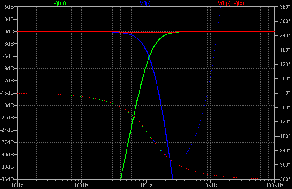

Flattest amplitude response always comes first. The right delay is which allows the flatest amplitude response giving a "quasi time aligned" system. Perfect time alignment with flaws in the amplitude response is useless. That's why i don't bother with exact time alignment and precise offset measurement, and aplly delay empirically.
I agree, but i still don´t see the need to measure the time offset to get a time aligned system...
These two comments seem a bit incongruous with each other. If your goal is to achieve "quasi time alignment" (not sure what that means) then how exactly would one apply delay "empirically" to achieve time alignment ? Surely you must measure something or its just guesswork ?
Let's take the case of a linear phase dsp based xover first. If my "guess" for delay is right the amplitude response will be flat enough and the system aprox. time aligned. Need more? If not, i have enough by tweaking the delay till i get both things acceptable. A piece of cake...
In the case of a passive xover, the result will never be linear phase so that i have little if any concern about time alignment, though i prefer shallow slopes with gentle group delay. Anyway, it doesn't matter, if i choose an LR24, i will tweak the delay for the flattest amplitude response, and will get the GD of a text book LR24. But i could also use an LR12 and need another delay, not necessarily the same as before, to get an acceptable amplitude response, this will depend on the drivers. I might also choose a1st order and try another delay but the choice of the drivers will be even more determinant for the result. Of course, if i used perfect drivers, all 3 delays should be the same, but drivers are drivers... And if i have no way to apply any delay, i would follow Speaker Dave's advices.
These distinctions show the differences between the active and the passive approach. For passive we try different slopes until phase overlaps. This amounts to achieving the same group delay for both sections for the overlap region. With active DSP you can hit the exact corner shape first then some availabe delay of one section or the other will give a classic LR combination and flat response.

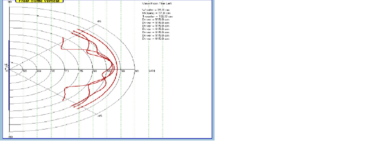

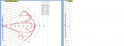

I agree, but what axis are we talking about?
If we mount a classical 1' TW and a classical 7' W on a flat baffle with an LR design in mind, this is considered a non aligned system. Well, we should modify this statement because the drivers will not be aligned for an horizontal axis between the drivers, but you will always find an axis along which the drivers will be aligned, the only concern is that this axis might be badly tilting downwards, making the speaker difficult to use, but this axis exists and the amplitude response we measure on it is flat. The real problem is that the vertical polar response of this arrangement will be badly degraded compared with the one you get when the main lobe is horizontally flat.
If we then change the polarity of the tweeter, the result will be similar, but the new axis will be shifted upwards, and the polar response will be degraded compared to the ideal one, but in a different way.
Anyway, by tweaking the slopes, for instance increasing the tweeter's side, the result will be bringing up ( or down with flipped polarities) the orientation of the main lobe, and the result will be a polar behaviour more conform to a textbook LR behaviour. The right amount of tweaking is the one which allows the closest match to the LR target, both on and off axis.
And of course, similar changes in the polar response can be obtained by applying delay.
