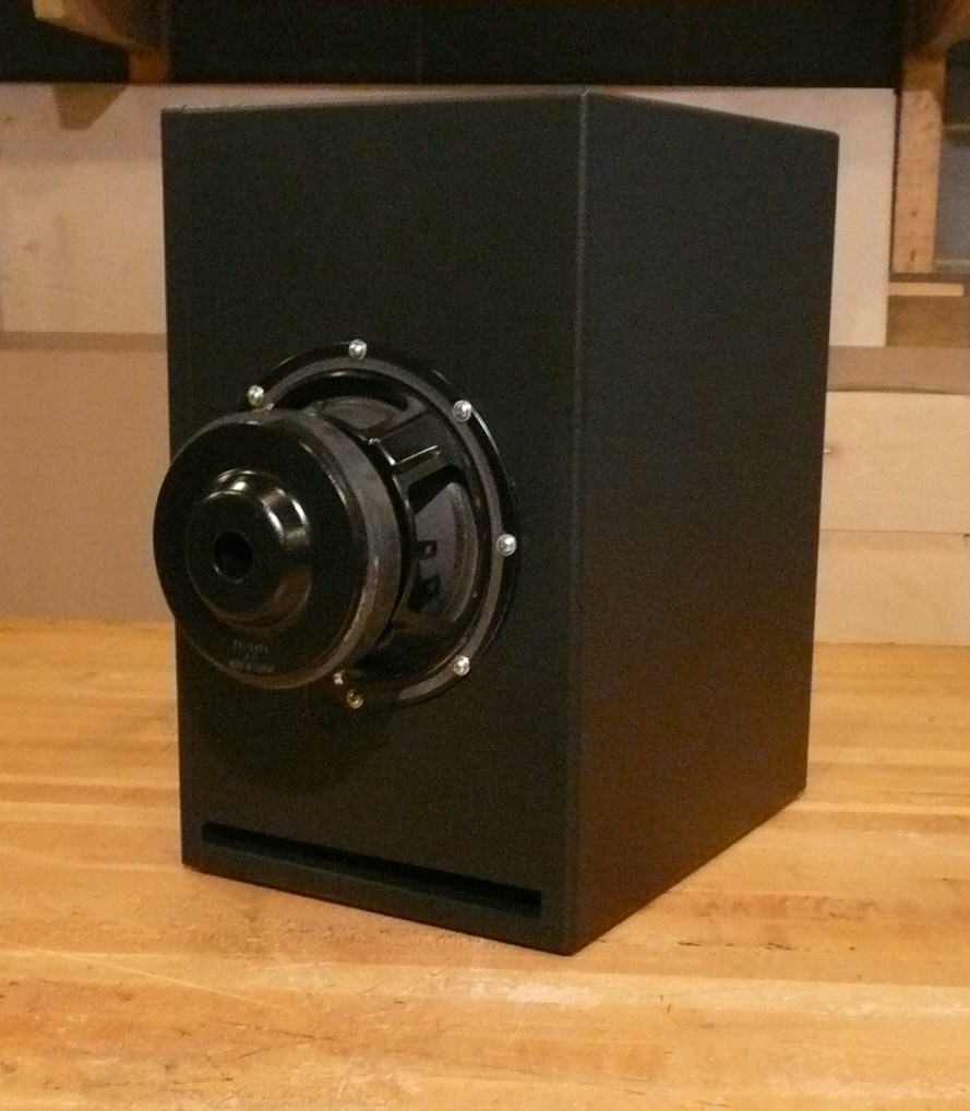

In addition, it is impressive that an inexpenisve 8" woofer can move that kind of air in a 101 cubic inch port.
Ports are measured in ^2 not ^3 You have a 7.5in^2 port. High vent velocity is a bad thing.

@ ODougbo
Hi, your electrical engineer friend wasn't wrong as such, he explained how to tune the box = fb to the driver = fs. That's the classical way of doing things, but there are other ways depending on preferences/limitations etc.
If you find the first hump is the hardest to bring up, you need to tune the box higher.

Nothing is perfect, everything is a compromise, that is engineering.
Your alignment is so way off any sensible classical alignment
you simply cannot apply any classical alignment criteria to it.
Applying "rules of thumb" is not intelligent interpretation.
Why won't you just go off and build a proper box for them ?
And come back and report the consequences ?
Two drivers isobaric in a 25L box tuned to 30Hz versus two
drivers mounted left and right in a 25L box tuned to 30Hz.
The latter will pee all over the former, with bigger ports.
This thread would then be considerably less boring.
rgds, sreten.

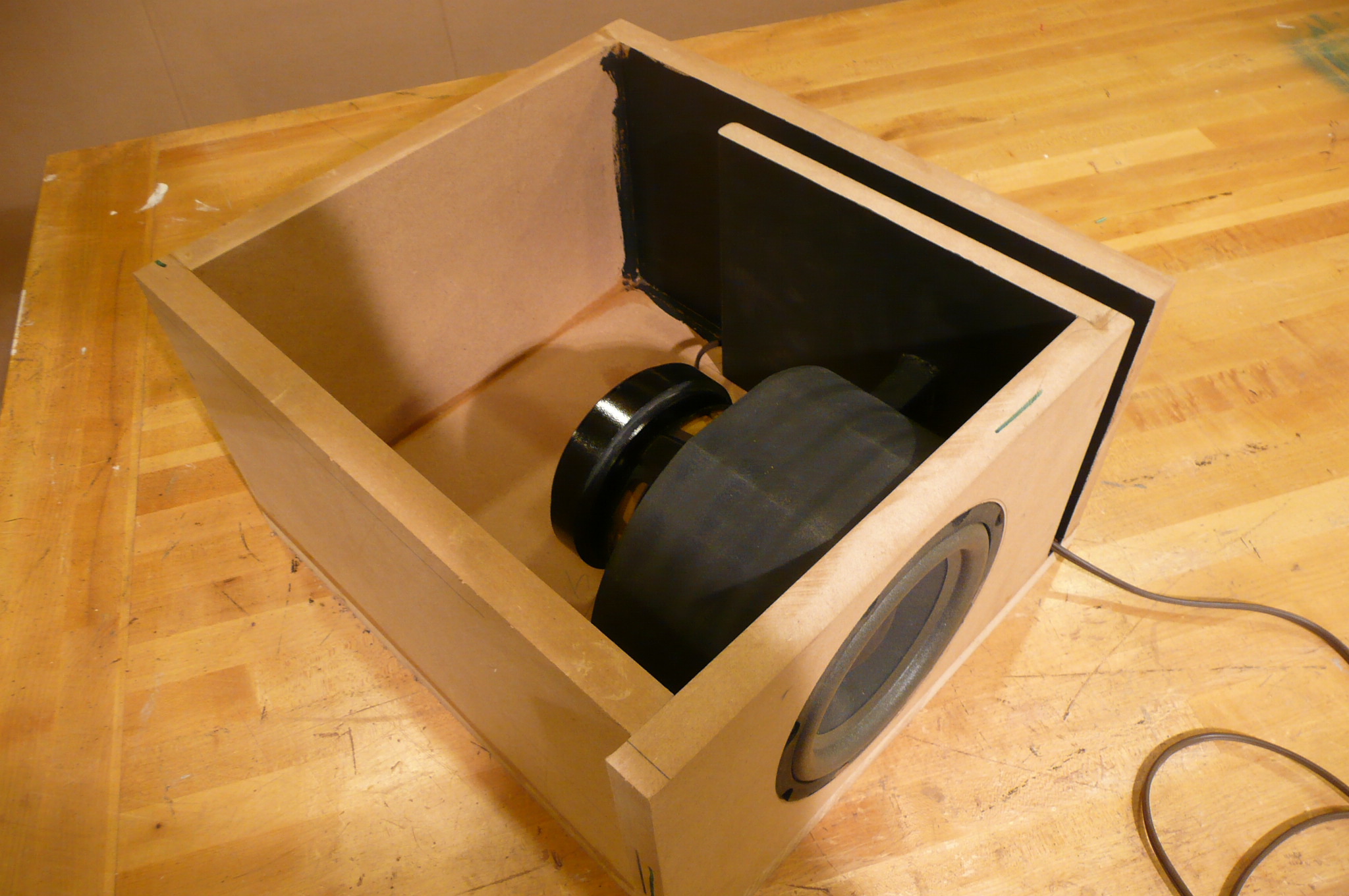

Building new boxes
Seems like were going around in circles, the comments tell me how off they are, and all I heard is chugging lowwwww bass throughout the shop.
Building new boxes, not a bad idea, the speaker bench is empty; you'd have to recommend an optimum port size AND related details.
However, be warned my friend, I did have a 28.4 liter clamshell, it was a powerful sub in a small package ~ the bigger boxes with tunnels are simply better (they have a remarkable “slam” quality).
Construction tip: I used rope caulk (HD) around the side of the box, clamped it off, then added screws, then trimmed with a router. Easy/fast, worked pretty well.

It's a difference of position. Doug is happy he's getting bass, the rest of us are more concerned with getting the most/best bass. Doug, this is a place largely by and for technical perfectionists, a wonderful resource to have because we get a lot of expertise here. But if you want to take a halfway solution and call it "good enough", you're in the wrong place. Try Audio Asylum, Audio Karma, or Audio Circle, all of which are less engineer-oriented and more tolerant of sub-optimal solutions, if they "sound good to you".
different ISO box
Thank you for a fresh view, however I don't think halfway is a fair statement, built several these and compared them to many other speakers for about ten years now. The one fellow I passed one along too, is really enjoying it.
I know if some of you fellows heard these, it would a different story and did get support from an engineer that said the "small" port was actually helping out the response.
I would try a different ISO box, enjoy building them and very passionate about speaker builds, etc.
So I really could use the help from the technical folks about a new 25liter build, the port size in particular. I can fine tune it with a generator on the bench, but want to make sure the size /air velocity is correct.

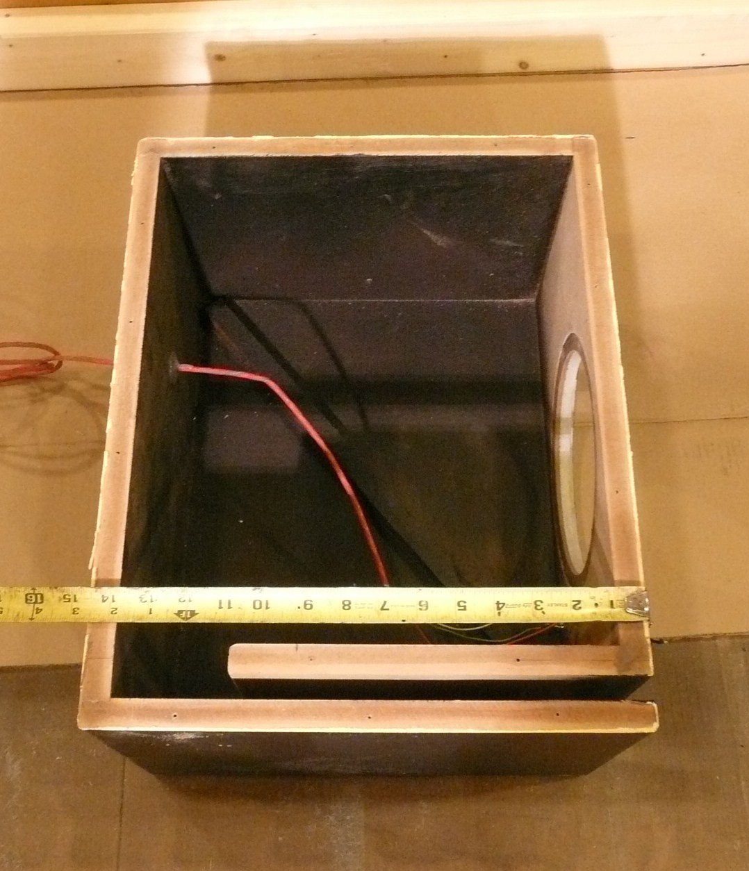

Thanks, never would have found that website. Are you suggesting a flare port vs. a slot?
I was thinking about following a format similar to pic, however, increase the height and length of port size e.g. instead of the 3/4" slot, it could be....say 2", the length would be very long and probably need to be an L or a U.
If the box is to be 20 - 25 liters, I’m guessing it would be a tight fit with a larger port.
If someone can get me going with the cubic inches of the port, I'll fabricate a new box, provide results, pics, etc.

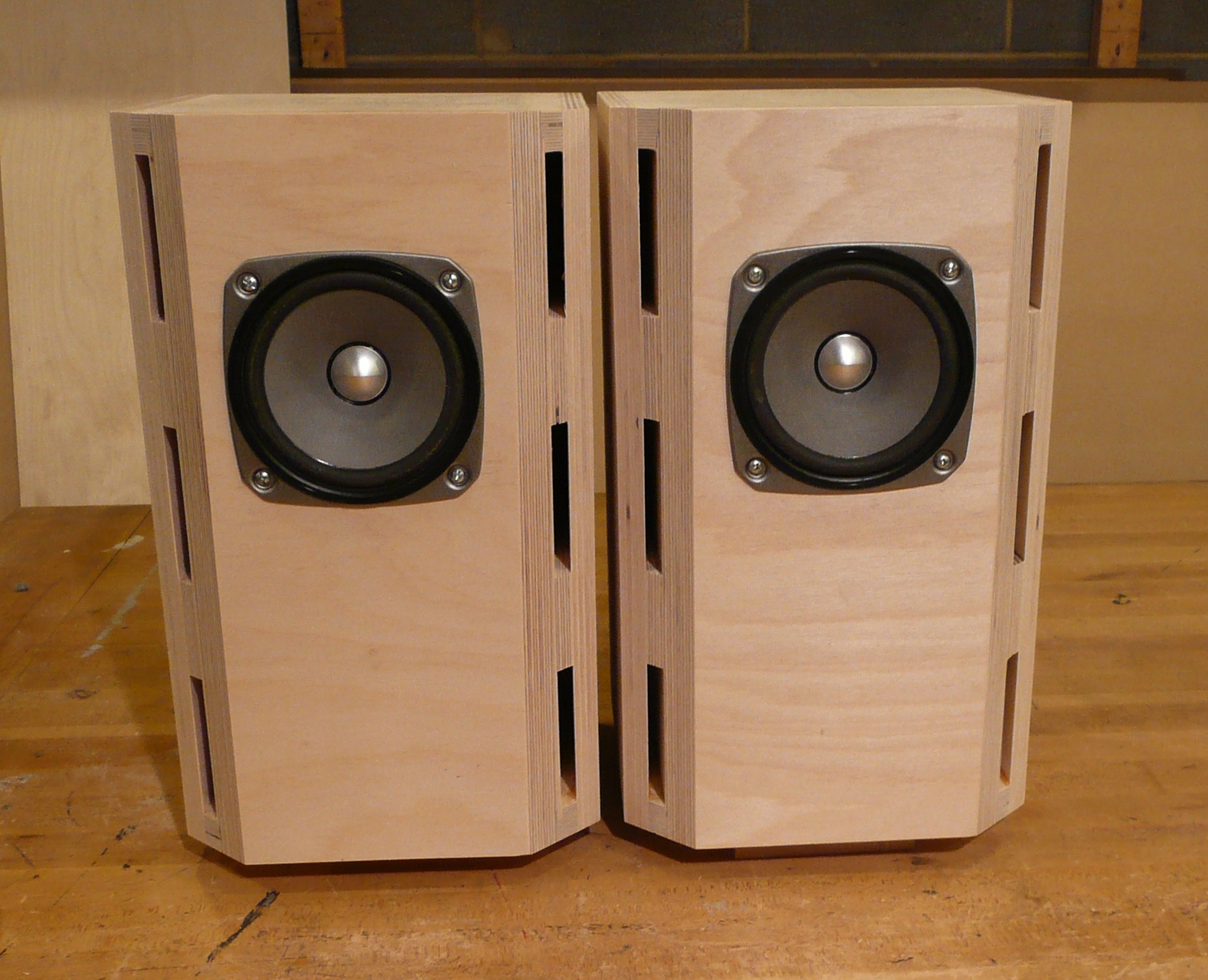

btw, just for fun, adding a pic of the last build, new satellite speakers for the sub.

Oh sure, still have a couple of them left. I wonder if the port size and the box volume will be the same OR the port will size will have limitations due to the small box size.
I guess the port could be a “U” that follows along the bottom, back and along the top.
