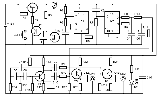

Yes you did.........Demagnetiser .
A pcb layout is given also.
"This originally was an article in the LLDIY Newsletter Issue 14 Jan/Feb 1994.
A Cartridge Demagnetiser
What on earth is a cartridge demagnetiser? Surely a cartridge requires magnetism in order to work? These were the first questions that came to mind when encountering this thing 5 or so years ago. It does not demagnetise the cartridge but instead the build up of small magnetic effects in other parts of the cartridge such as the core etc. This is only my understanding of it though. The part I don't understand is that people use these devices on their interconnects, power amps, speakers etc. and claim similar results. I have not yet.
The unit puts out a very small, distorted, high frequency wave form - that is all. The clever bit is the signal rises slowly and dies away slowly so as not to leave magnetic residuals. In comparison to the commercial unit the idea was taken from, this unit, once turned on will do one channel, then the other channel and then switch itself off. No chance of leaving it on and wasting the battery, no hassle of changing leads over. A friend of mine designed it and although it could be simpler, the extra complexity costs so little while adding to its ease of operation.
The results to my ears (and reports by others who have one) are amazing. It is as though someone has opened the window in a room full of stale air; like the system has just had a spring clean. "
Eric.

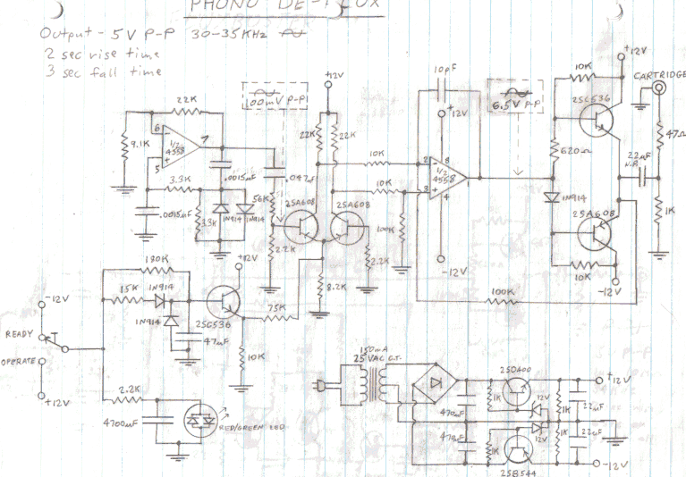

Frank, I'm very sure it was 33kHz and it was an original fluxbuster.
Also the amplitude was unexpexted high for MC, so the only thing I can think about it has something to do with the inductance of the coils. Due to this the high frequency will certain reduce the current through the coils, but this could also be done with a lower amplitude of the signal. So I guess the frequency is chosen for the best overall results.
Dick.
Back in the eighties when the Fluxbuster was first released I reverse-engineered it. It puts out a 5 volt peak-to-peak sine wave at about 33kHz, with a source impedance of about 50 ohms. It takes about two seconds for the waveform to achieve full output, it stays there for about 6 seconds, and then gradually decays to zero in about three seconds.
When I built my own version, I left out the logic circuitry that sets the 6 second "on" time and just wired in a pushbutton instead, so I can hold it on for as long as I like. A led with a 4700uF capacitor for the decay delay indicates when the process is complete and the cartridge can be safely unhooked.
I have attached a scan of my original completed schematic.
Take care,
Doug

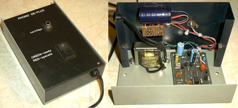

Here is a picture of the fluxbuster clone that I built, both outside and inside. The pcb was done with Radio Shack rub-down etch-resist transfers, and apparently I built it in 1990, as that is the date on the pcb. This device has been used many times on a number of different cartridges, always with good results, but I've never tried it on cables or anything else. I always remove the stylus if I can (moving magnet cartridges) before using it, and it only does one channel at a time.
It actually makes a fairly easy and fun DIY project! :)
Take care,
Doug
