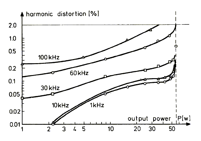

This paper has the same contents as the AES paper, same authors (Lohstroh and Otala):
Preprint NO. H-6 (R)
AN AUDIO POWER AMPLIFIER FOR ULTIMATE QUALITY REQUIREMENTS
by
Jan Lohstroh and Matti Otala
Philips Research Laboratories
Eindhoven, The Netherlands
PRESENTED AT THE
44th AUDIO ENGINEERING SOCIETY CONVENTION
FEBRUARY 20-22, 1973 - ROTTERDAM

It is interesting how people apparently connect the terms 'Otala amp' and 'high quality' for no obvious reason (not obvious to me at least).
Otala's amp is NOT the worlds best amp. It isn't even a very good one in spec terms. It was a 'reference design' to show one way to build an amp with low or close to zero TIM.
There are other ways, and now that we understand the real mechanisms of TIM we can build very high feedback, very linear, very low distortion amps that are as free of TIM as anything proposed by Otala.
If, for instance, the PGP would be no better than Otala's low TIM amp, we would have been spinning our wheels for 35 years. Thankfully, that is not the case!

From that AES paper:
"The approach chosen is to avoid all apparently “elegant” tricks frequently employed (bootstrapping, positive feedback, distortion compensation, higher feedback for dc than ac, gliding bias etc.)....."
You’d never better even the “Blameless” linearity benchmark with this prescription.
