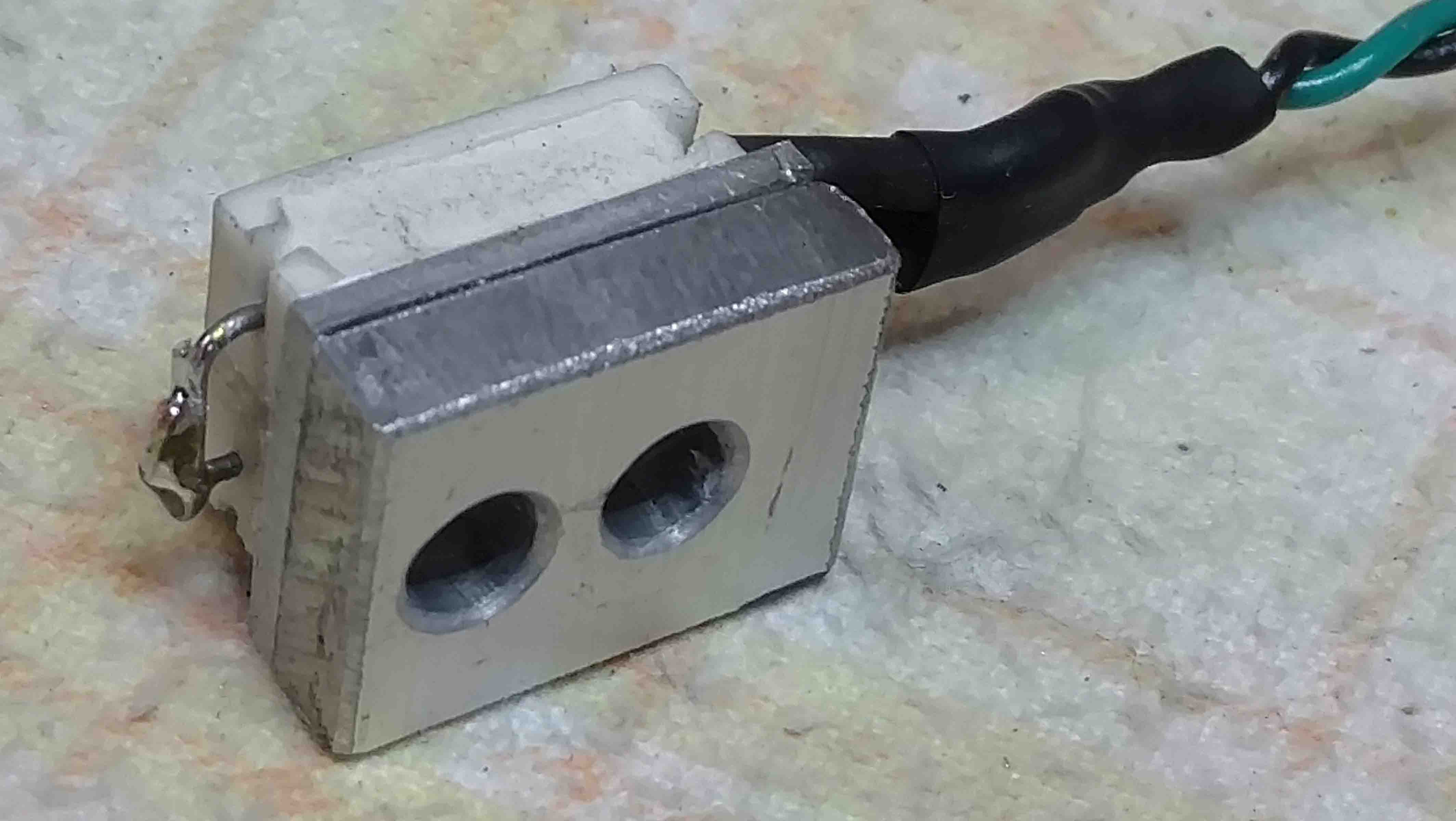

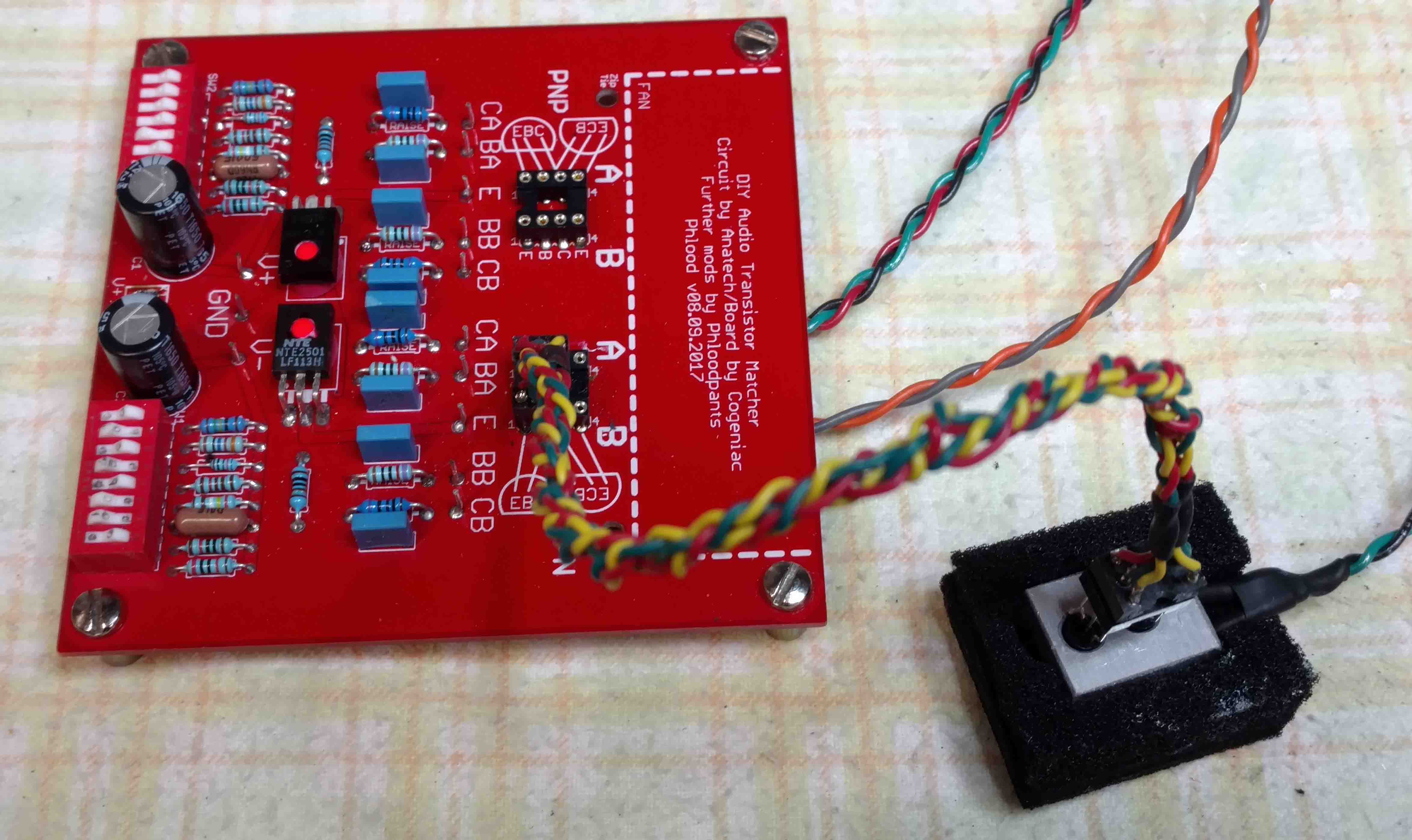

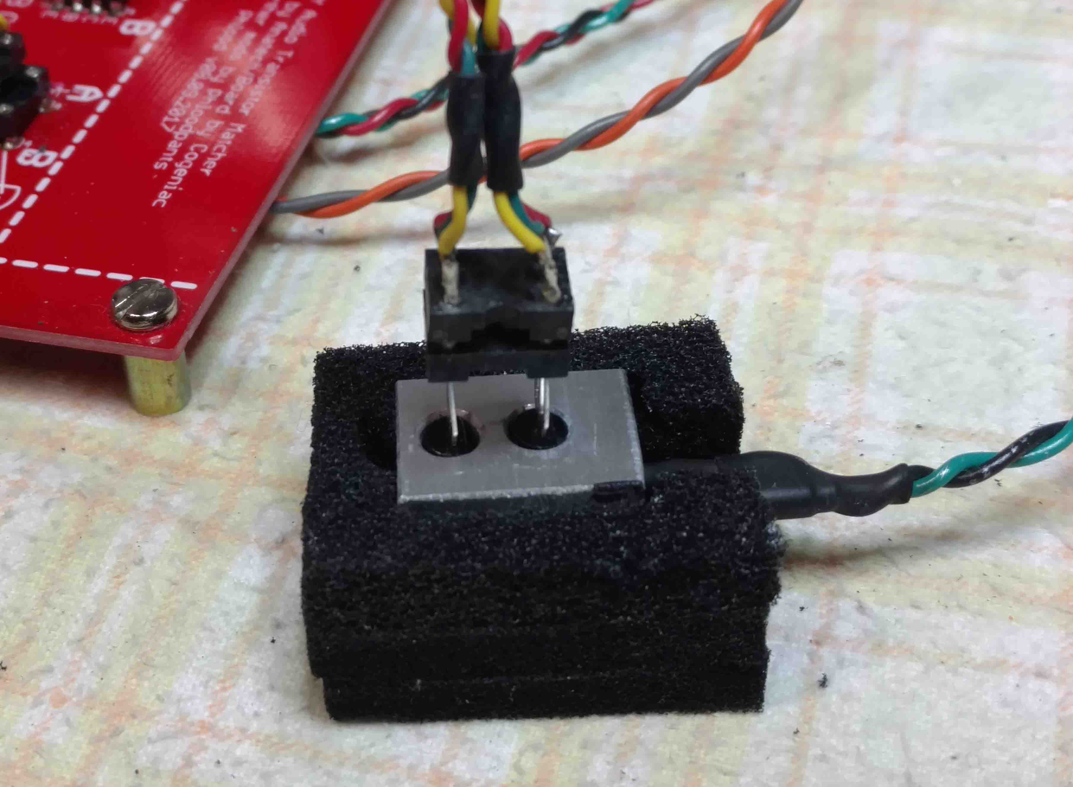

I decided to try and separate the transistors under test from the test rig. I attached six small gauge wires about 8 inches long to the male and female sides of two IC sockets. This serves as a sort of ‘extension cord’ for the transistors. I can move the transistor pair in their new socket away from the board and experiment with different ways to keep them at the same temperature, and also control the testing temperature.

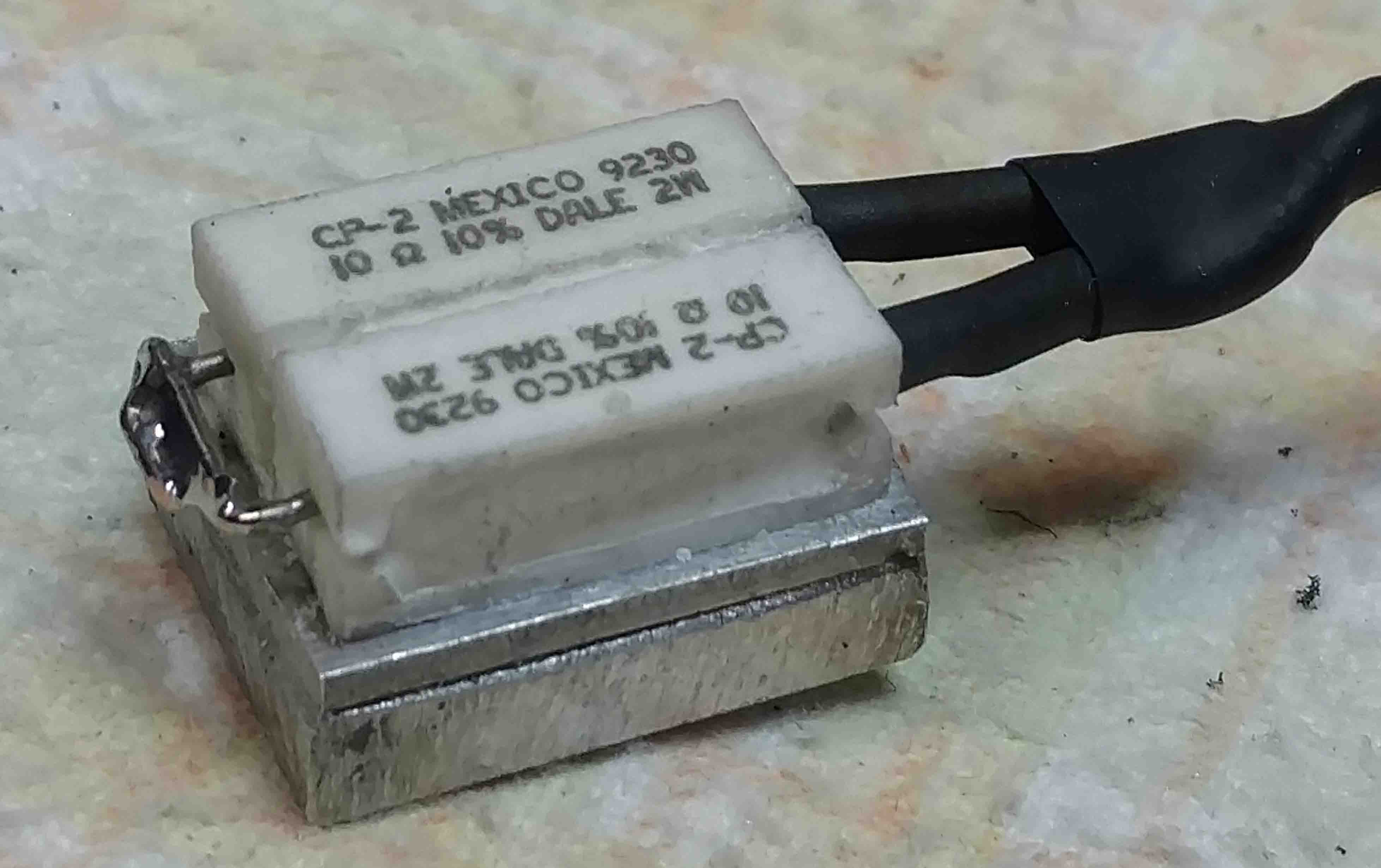

I also added heating to my thermal cap by mounting two small power resistors (rectangular ceramic) to the top. They are tack glued with thermal paste between them and the aluminum block. So now, I have a heated thermal cap that maintains the transistor pair at the same temperature, and allows me to control that temperature.
With the foam insulating cover in place, I can achieve a block temperature of 96 F with a current of 125mA. (The resistors are 2-watt, 10R connected in series, with an external resistor dropping some of the 5 vdc power source.) This works out to about 630 mW. I’m measuring the thermal cap temperature with a Fluke handheld IR gun. I want to install a small thermocouple in the thermal cap to improve the temperature measurement accuracy. I am only beginning to experiment with this new version, but if it works, it’ll be a whole lot simpler than building an oven.
