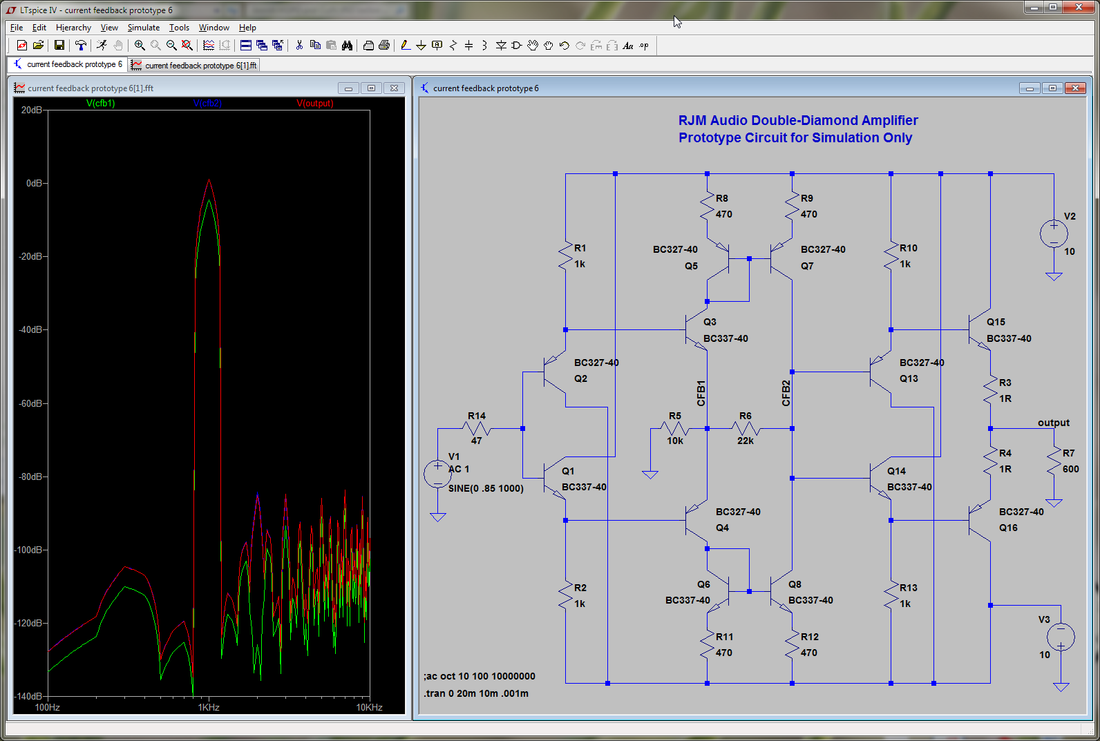

open loop performances of the DB-CM-DB architecture are quite amazing :eek:
Under simulation at any rate, my results bear this out 100%.

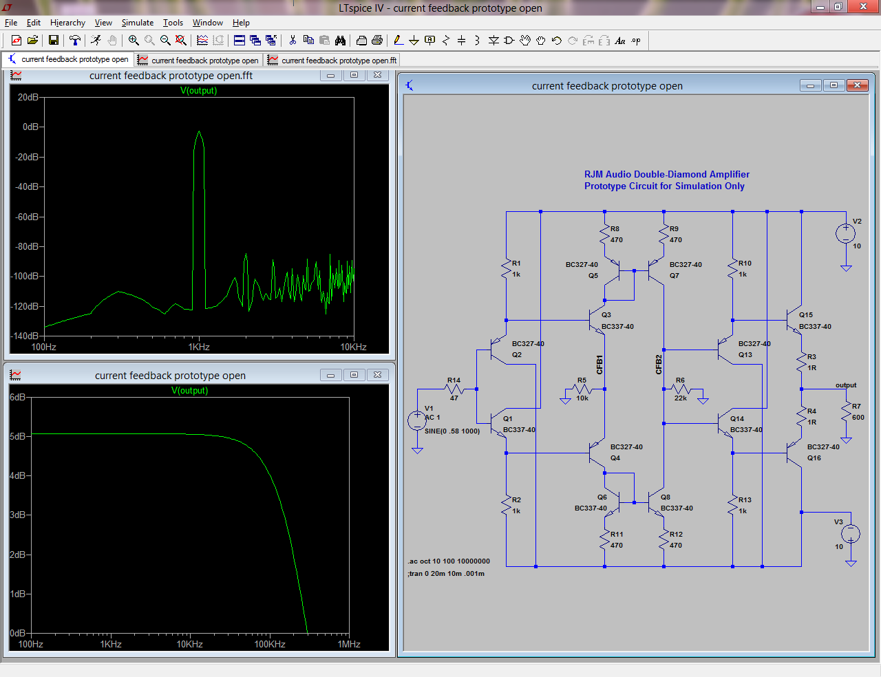

rjm
Joined 2004
There is some gain there... Not optimized... should have lower distortion. Remove R6 and then it will be open-loop and then retest.
I interpreted "open loop" as "the output buffer is outside the feedback loop" rather than "there is no return current into the inverting input". I guess that was incorrect.
If you remove R6 completely however, things go a little screwy since the impedance of that node just jumps up to the remaining components surrounding it (Q13,Q14) - gain goes up (roughly 45 dB), distortion goes up, bandwidth goes down.
It is possible to run "open loop" by dismantling the feedback connection, connecting R6 to ground instead of R5. The simulated performance is largely unchanged.

rjm
Joined 2004
forr - I hadn't heard the term before, but on searching, it certainly seems to be a variant thereof.
coluke - and works it does, but I still don't understand why you'd choose that connection scheme (grounded) over the other (back to the front half of the current mirror). Seems to me like there is no difference.
rnmarsh - no, not yet. I'm not even sure what I should be "optimizing", even.
