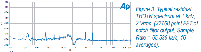

The SYS-2722 analog generator seems to be in the 0.00003% - or better - THD range @ 1 kHz/2 Vrms out:

SYS2722 is about -136...... that might be Ok for awhile. But, then there is that nagging question... how much is curiosity worth for a one time test? Time or money? Hmmmm.

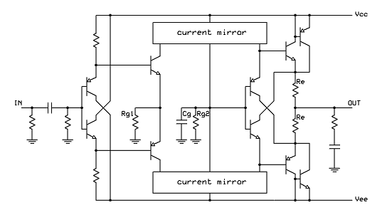

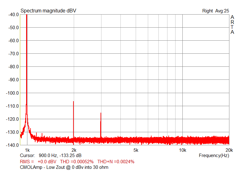

Basically it's a pretty standard discrete open-loop CF topology- I've attached a simplified schematics (well, actually an over-simplified one - output CFPs are not going to work that way :) ) and a sample FFT run (@ 1 Vrms into 30 ohms). It works very well - in principle you could further improve performances by selecting bjts, but with 18-20 trannies/channel it could be a real pain...The interesting point is that you can easily convert it to closed-loop if you're interested in a CL vs OL comparison (and I was pretty curious indeed, but heard no appreciable differencies...), but I know it is by no means a simple circuit, nor it was that easy to have it running smoothly (@ about 0.2 ohm Zout, at least).

That's a nice variation on what has become what might be called the better topologies in use today .... current-mode, too. There are a million varieties and this one seems good too. However, as you noted, the complexity is much greater. And, is it dc stable in offset and drift?
For myself, the lowest thd is not the goal. I just want to measure it accurately. It seems, IMHO, that a more elegant solution/circuit is the one which gets the job done best with the fewest of parts and the lowest cost.
An Ic with external power output stage comes close to meeting the goal.... but usually still needs a dc servo. And, the better IC's are not cheap.
L.
DC servo would be needed with that, Im also building something similar over the weekend, just curious.
Output drift is less than about |5| mV over 2 hours or so @ about 100 mA Iq (fairly stable, and this was somewhat the real challenge with such a low Zout design goal), en plein air and with a far-from-optimum layout: not a precision DC amplifier at all :rolleyes:, but seems fine for audio - actually a DC servo coluld be not necessary at all, although I've already tested one, just to be on the safe side.
