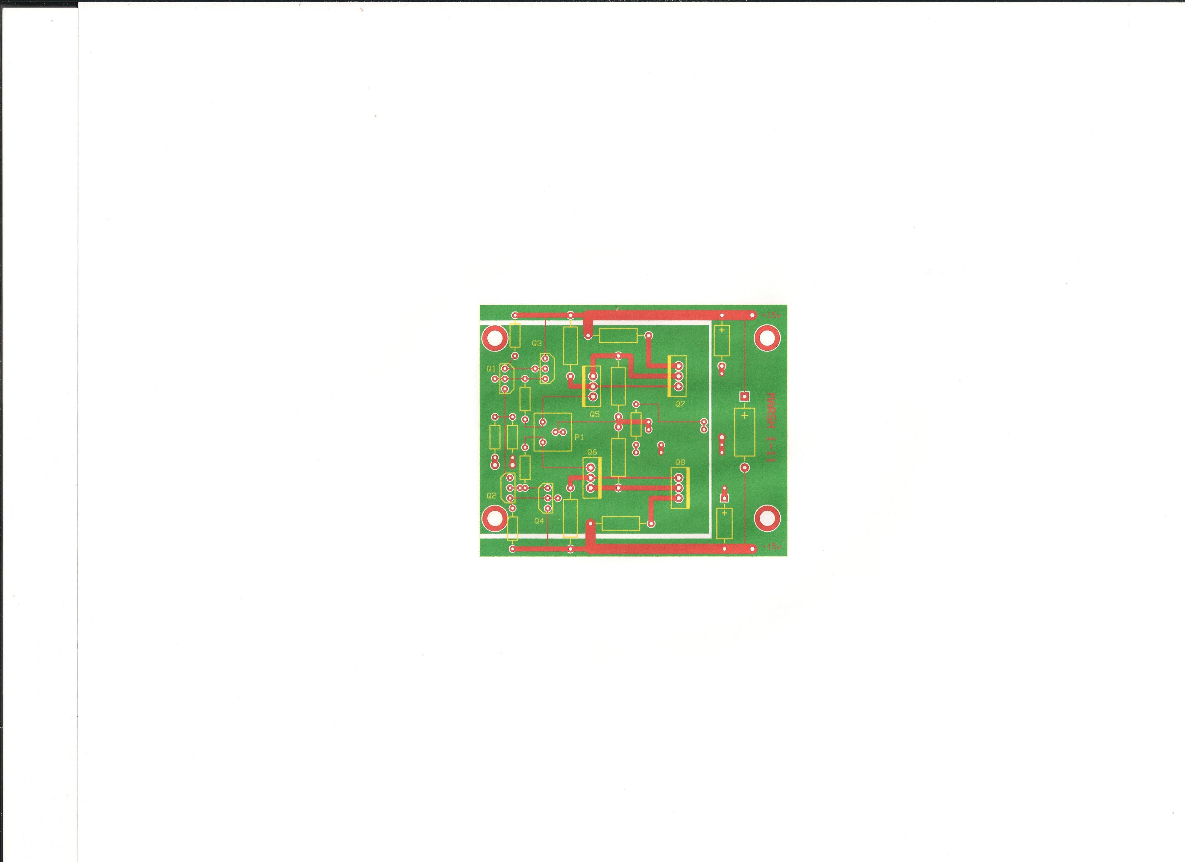

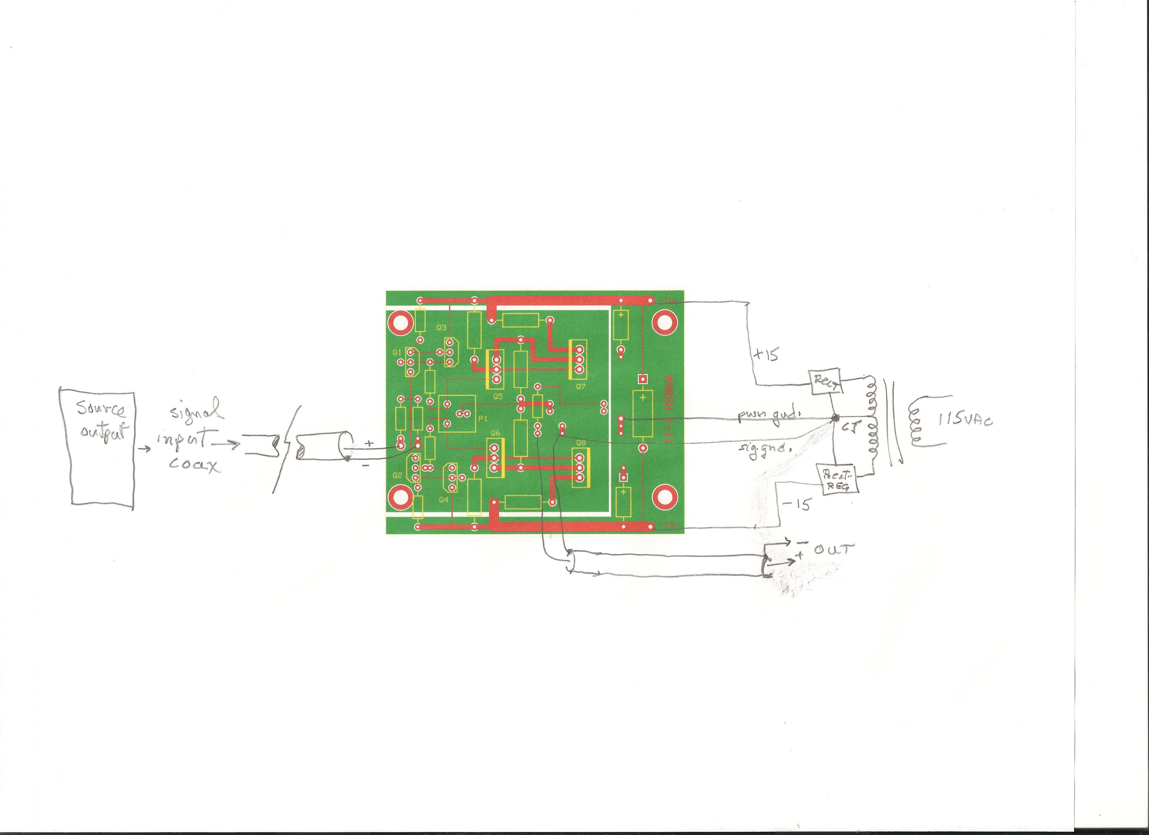

seperating power ground from signal ground on the pcb
Here is an example of what I generally do -- I use two pcb ground plans: I have a seperate power ground on opposite pcb sides of +/- traces that form a strip-line for low z distribution. It never goes over signal traces and has a seperate path to the power source ground point.
The signal shield/ground is only over the signal area/wiring. Never crosses over power wires/traces or signal ground plane areas.
Separated power and signal returns are an important part of the high-end pcb design. This keeps power filtered transient currents/ripple/rfi et al out of the signal paths (via common). Result? Greater sonic clarity and seperation. -RNM
Disabled Account
Joined 2012
Dual grnd planes
example using old pcb circuit - green color are the two seperate ground planes: signal and power.
right side is power and left or center is signal. Traces are above the ground planes in red. -RNM

dual mono floating PS, "balanced" 4-wire output cable is always better, resolving "gnd" between SE signal gnd, output/return gnd and PS CT is simpler when the source/signal gnd is the only common connection
but for simple headphone amps with SE source, TRS output connector these gnds are always wired together between the R,L channel boards at input and output
the xfmr CT is a "dirty" wire - large discontinuous pluses of current are present here and in the reservoir cap gnd leads - "star" these together but use a separate clean gnd return branch to the Vreg gnd ref, continuing on to the amp PS gnd in a separate "clean gnd star"
at typical headphone currents "gnd contamination" from R,L return currents mixing in common gnd system impedance is mostly ignorable due to their small size, ease of using "heavy" wiring relative to the current magnitude
I use double/reinforced insulated line xfmr, construction to allow floating output to avoid chassis safety gnd adding complication to the picture
with Class A output bias the power rails on opposite edges of the board is survivable - but is in general bad practice - will bite you with Class AB nonlinear rail currents mag fields coupling to the circuitry in between

Well, the guts and gore of it is that i use a vasly more complex arrangement that the simple one shown. The point only to not have power supply currents (ripple etal) passing thru signal common in a single-ended design. high currents are a seperate issue from headphone amp currents... but generally agree.
I use a seperate power supply (including transformers) all the way thru and seperate c.t. grounds to one point at the reg supply as you suggest. I dont want to get into grounds for all manner of circuits, here. new thread, perhaps?

draw the current loops - the "stipline" in the posted pcb isn't doing anything, openended stripline doesn't do anything at low audio frequencies
even properly applied stripline (terminated) doesn't "work" at audio, only truely effective at MHz - the return currents will find the path of least impedance for each frequency, at DC it "resistance" controlled
http://www.diyaudio.com/forums/anal...ch-preamplifier-part-ii-2373.html#post3049769
gives an example, by 20 kHz the proximity effect has only concetrated the "image current" under the trace by ~ "halfway" - the plane current is still spread through much of the gnd plane

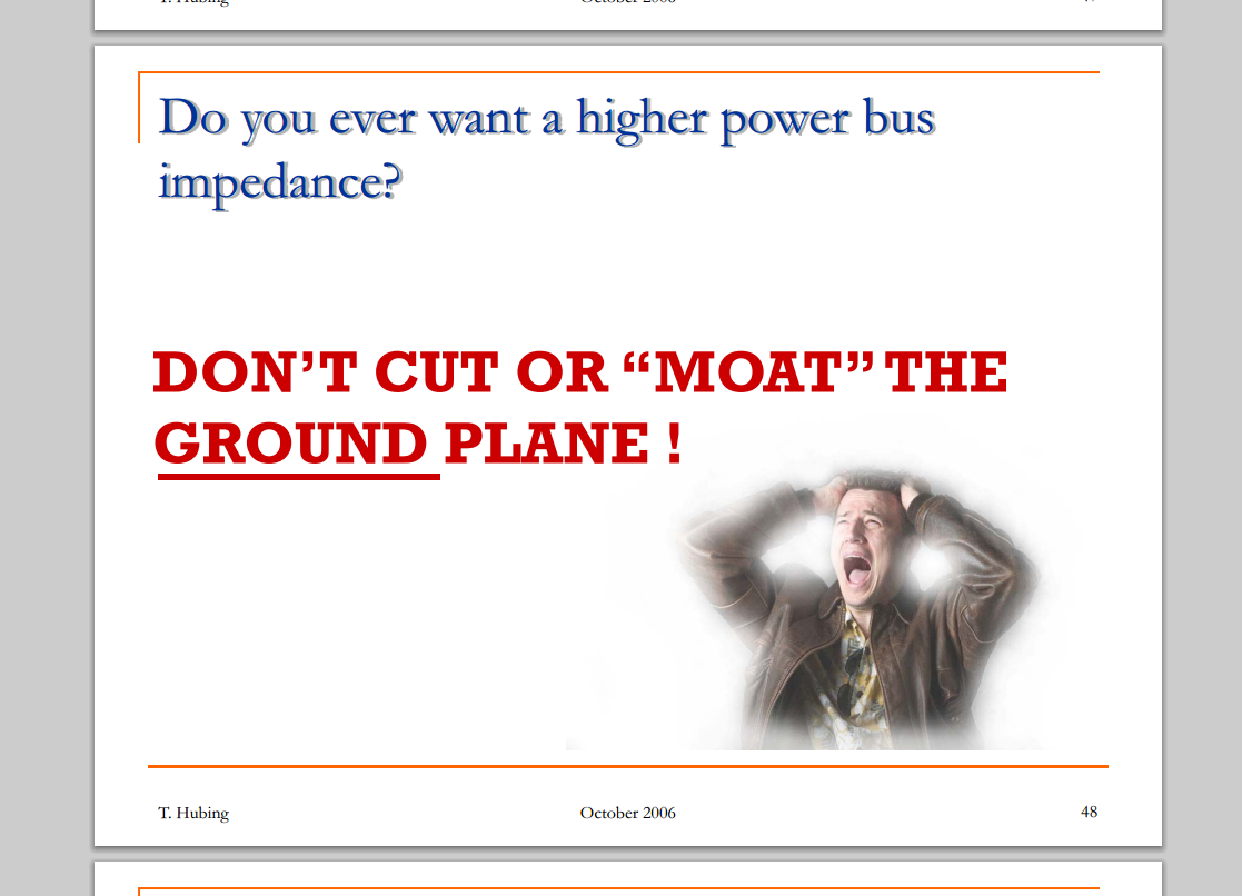

I did not cover grounding nor power supply design in the headamp article for that audience. But for many DIY on this forum, maybe some tutorials are needed. There are many books on the sunject but here are two quickies of the grounding issue for wideband width circuits (>100KHz) and esp. for digital circuits (DAC etc):
www.cvel.clemson.edu/presentation_slides/PowerBus-decoupling.pdf
www.cvel.clemson.edu/presentation_slides/automotive-circuit-board-layout.pfd
www.cci-msc.com/rigidbus/pdf/rigidbus.pdf
Good practical info that DIYers might want to read up more on it for their particular project -whatever it is.
Plenty of books on the subject exist as well. Proper grounding is important for best audio performance and sound and for trouble free projects.
only 1-2 slides mention <100 kHz - which I think is the 1st order of concern for audio electronics layout, wiring - "down there" plane partitioning, slots, moats do work - if you want to control the current paths you have to do it with conductor geometry, explicit pwr return routing - can't rely on proximity effect, image currents in planes - Resistance matters

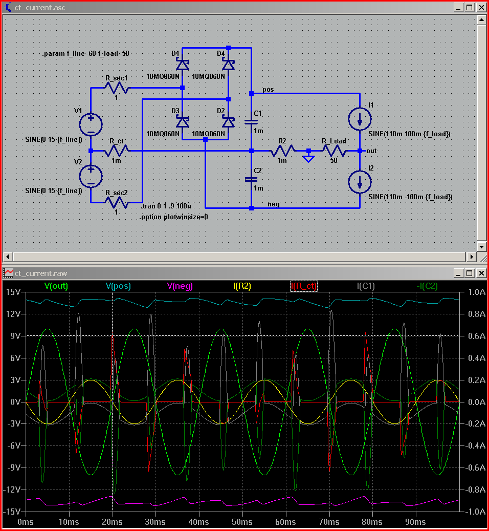

(I have professionally designed Industrial Instrumentation for >2 decades - including strain gage instrumentaiton with Ethernet, USB 2, 100 MHz processors, DSP within inches of Av 4000 amplifiers, 16-20 bit ADC)
I worked up this simple sim for the xfmr CT current - some have scoffed, use faulty reasoning about circuit symmetry to claim the CT is "clean"
load on PS rails simulated with Isources - Class A bias conditions
busy plot but shows how a load frequency differing from line multiple can give large CT currents as each polarity supply cap is unevenly discharged/recharged
look at the Red R-ct trace spikes, C1,2 currents
but these nonlinear pulse contaminated currents sum to the mostly linear load current
the R2 current is equal to the (inverse) load current - is as linear as your load's impedance - can be very good for headphones
  • ct_current.asc
