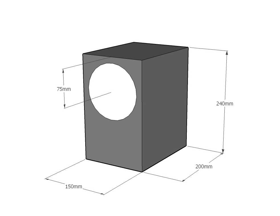

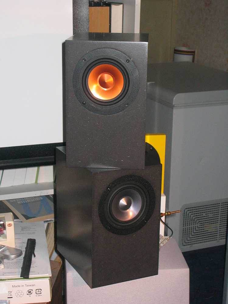

so, over the easter weekend I completed my small mini monitors with the CHR70.
they are 4 liter sealed, using a high pass capacitor (680uF) to both extend the low end and to flatten the low response (normally in 4 liters sealed there would be a hump). I have applied a notch filter (47uF, 0.39mH, 2.7ohm) as bsc.
the cabinets are made from black MDF and have 3 coats of clear varnish only. I liked the look of this black MDF so much, that I decided to name them "Black Beauty" (I just read this book to my joungest as bed time reading)
the sound is realy good, stil plenty of low, and the high (after some experimenting with the toe in) is very nice, not as sharp as with other metal cones is this price bracket. not as nice as the Alpairs, but they are near double the price so was not expecting that either.

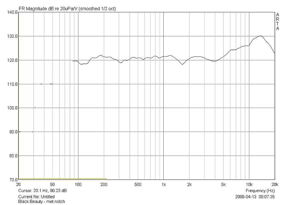

I made some quick *) measurements using Arta of the final result, not bad at all I'd say
*) this was the first project that I used Arta, so in time it was not that quick, I spent most of the day setting up the program, fiddling the (also new) soundcard, and testing the combination, but once that was done, the measurement went prety quick

lol, I actually don't have the option to be lazy. These are for a friend as a wedding gift so I can't leave them unfinished. They aren't as top heavy as I thought they would be. On carpet they kinda are but on a hard floor they might be ok without a base. Eliminating the top void/ballast would help too IMO.

I don't hear that either (and don't see it in other's measurements), possibly 2 reasons:HareBrained said:.... I'm a little surprised at the amount of rise high end. I can't say that I hear that in mine.
- my mic is not calibrated yet
- listning slightly off axis already solves it as well..
I suspect the former -according to the published data (and the MA published specs are trustworthy, unlike most) there's a slow rise above the telephone band up to ~12KHz, the level of which is similar to the small designed in centered around 500Hz. 30 degrees off axis rolls that off nicely, & you're unlikely to need to be that far off.
