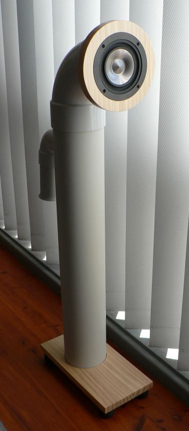

Triffid... a simple little TV/FM/CD speaker
Quick easy speaker for a small room driven by 20W using DVD/FM/CD as sources.
Vented speaker, Vb=6 litres, Fb=59Hz, F3=49Hz, option of BSC / no BSC, long hair wool damping in the lower 200mm of tube, selective damping on inside walls. Can go lower but I've picked a compromise between low extension and power handling and the BSC is not required in it's current application.
Not usually a fullrange user but rate this driver above FR125S (sealed, vented), FE127E (vented, TL), W3-871SC (vented) in that order. Gets a thumbs up as a fullrange driver as unlike a lot of the others it does cover a broad range very well just like the FR125S but with a bit more life and detail. The detail can go missing in action when things get congested but that's to be expected at this price point and driver type.
The SPL is not a problem in my case as most amps have excessive gain anyway. The low impedance could be an issue for some amps (some tubes?) and also ChipAmps that are running high rail voltages.

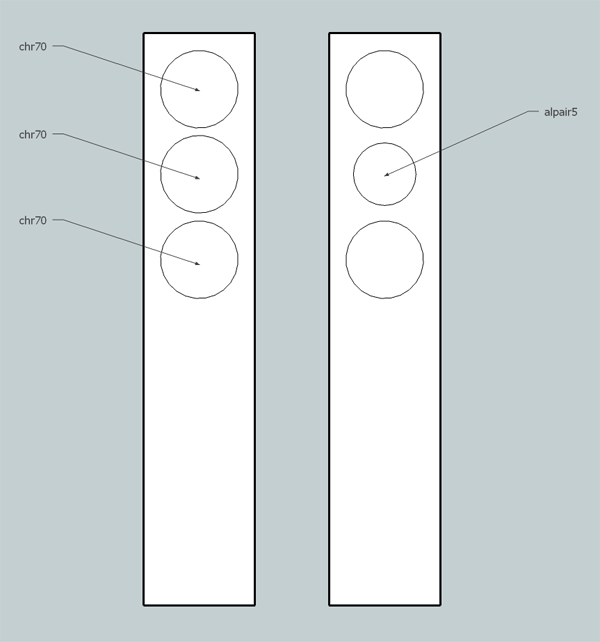

Friend of mine might be commissioning me to build him some new speakers for his home theater system. I'd like to try something nifty with the CHR70s. He wants something relatively badass to go with their 58" plasma and all that, so I was thinking pairs multple chr70s for left, right, and center, and a single chr70 for each of the rears. Floor standing BR (or maybe something fancier?) for the left and right, sealed center and rears. They already have a decent powered sub with adjustable crossover.
now, with the whole "doubling up full-rangers" being a problem with the phase cancelling thing, I was thinking of other ways to incorporate these drivers into multi-way speakers. First I was thinking maybe two CHR70s as mid-bass drivers, with a single Alpair5 in the middle running the highs.
Getting into the Alpair stuff might be a little overkill in this case, and I'm thinking "if the CHR70 is enough quality but just not enough quantity.. why not just add more of em?" So what about a 3-way CHR70 floor stander, with the top and bottom drivers running mid-bass, and the center one running highs.
Am I totally off my rocker?
Would certainly look slick, anyway :p
I was thinking wire the midbass units together in parallel, and wire them in series with the treble unit, then balance them out in the crossover, working out to a overall 6-8ohm unit, which seems tasty
