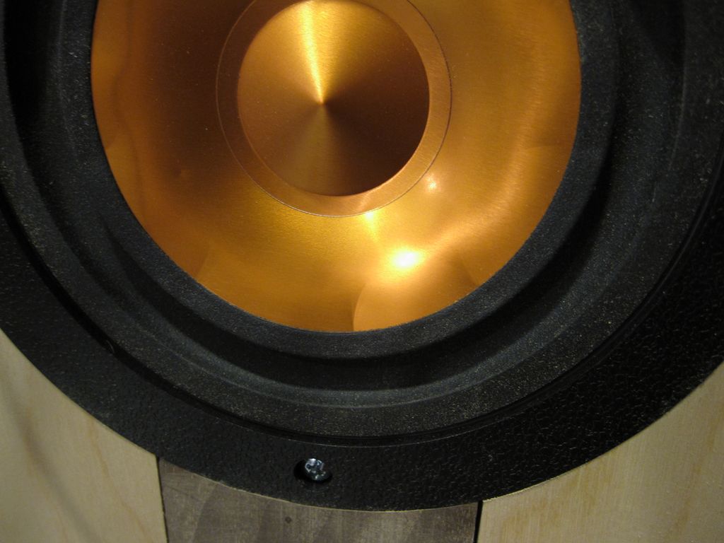

aaahhahaa I can handle this question!
I have a pair of (1st gen) Chr-70s in sealed cabs as computer monitors, using some EQing to flatten out the bass. More on the speaks and EQing here
Anyway, I had an odd issue where, in a particular game, both channels were playing, but the high frequency was missing out of one of the speakers! This is obviously VERY ODD considering they're full-range drivers. When troubleshooting, I started swapping some cables around in my mixer.
*ahem* anyway... I got a little lesson in "TURN OFF THE AMP BEFORE SWAPPING CABLES 101". As upon plugging one back in there was a tremendous thump out of the right speaker, driving the speaker extremely hard into the extents of its suspension. It was rather impressive to watch, actually!
Anyway, the suspension held up great! All that happened was that the cone actually "crimped" slightly upon hitting the surround's limitation. There are now a ring of small creases evenly spaced around the rim of the cone.
On the plus side, I actually detect no obviously audible difference in the sound the speaker generates. It still sounds great. Under extreme scrutiny one might notice something, but I haven't, yet. Just cosmetic damage.
I think this is really a testament to the high standards of build quality in Mark's speakers. The even spacing of the crimps I think indicates the level of precision that goes into the assembly of these things. If the driver or surround were just the slightest bit off-center, I would imagine the cone would have perhaps torqued harder and perhaps caused damage to the driver, or perhaps much more significant damage to the cone itself, but as it was, the forces were distributed with startling consistency across the cone.
Picture included!
As an aside, Since I'm playing with crazy amounts of low frequency boost while EQing, I have also driven the drivers to the extents of their suspension under more normal conditions (you know, with audio signals instead of dead shorts), and though it sounds awful when they get there, they handle it like a champ and go right back on doing their business when you bring the levels back down.
Picture included!
Hi Tresch and Guys,
Many thanks for this feedback. I've been receiving a fair number of questions in recent times re bass delivery for CHR-70 and Alpairs. First off, can CHR-70's go low (<40Hz)? Yes they can go low, but like all smaller drivers there are performance and technical limitations. I've talked about potential distortion issues and recommended working excursion limits earlier in the thread.
On the practical side, Tresch's pic is a good demonstration of what happens when a CHR-70 (or Alpair) is over-driven. Indeed, most any full range driver that's subjected to persistent high levels of mechanical stress will suffer cone and power-train damage. It's important to remember that full rangers can't handle as much power compared to most multi-way bass drivers.
If you happen to "over-cook" a CHR or Alpair driver, they often can be rescued by some gentle rubbing with your small finger from under the cone. If a crease is more profound, use your finger nail. Gradually working your way around the cone, gentle rubbing usually produces good results. In more severe cases, the creases may remain visible but the driver will most likely remain functional, good for future experimentation and music making.
Cheers
Mark.
