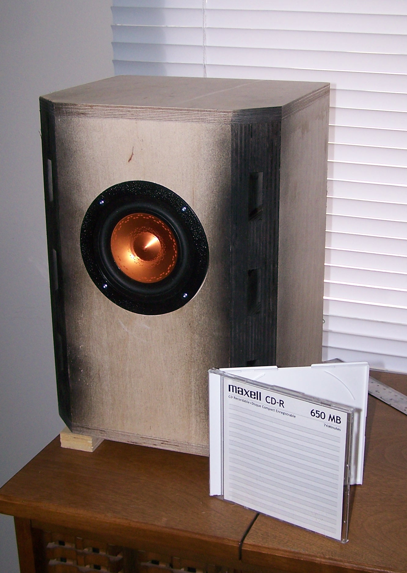

Drumroll please.....
The dMar-Ken70's are finally making music.
In brief: they're pretty nice.
Defining characteristics: Heaps more bass than you'd expect, and a nice extended top end. In this cabinet, the CHR-70 is very nearly a "full range" driver.
Oh, and for all that they're low efficiency, they play plenty loud enough - I've been testing with a 15W Class-T amp. I think we sometimes forget that 90dB is actually pretty loud.

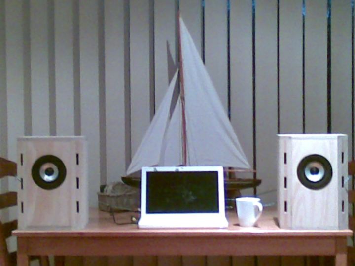

When you get a chance, send me some big pictures to post.
Is that a MacBook posing with the coffee cup?
Our dMar-Ken7 are playing (A7s are still stock, Chris has them ATM), the dMar-Ken70 await veneer and a set of the CHR Mk2.
For shame, Dave, it's a TEA cup.
The Mac (as well as the speakers, once they're finished) belong to my girlfriend - I can pose my sister's MacBook for the bigger shots if you think my Dell might spoil it :p

I'll charge up the real camera to grab some better shots later - they're still pretty rough, nailgun pockmarks everywhere - and 3 of the 4 chamfers show a brad sliced in half by the circular saw. But that'll mostly clean up once they're filled, sanded and painted.

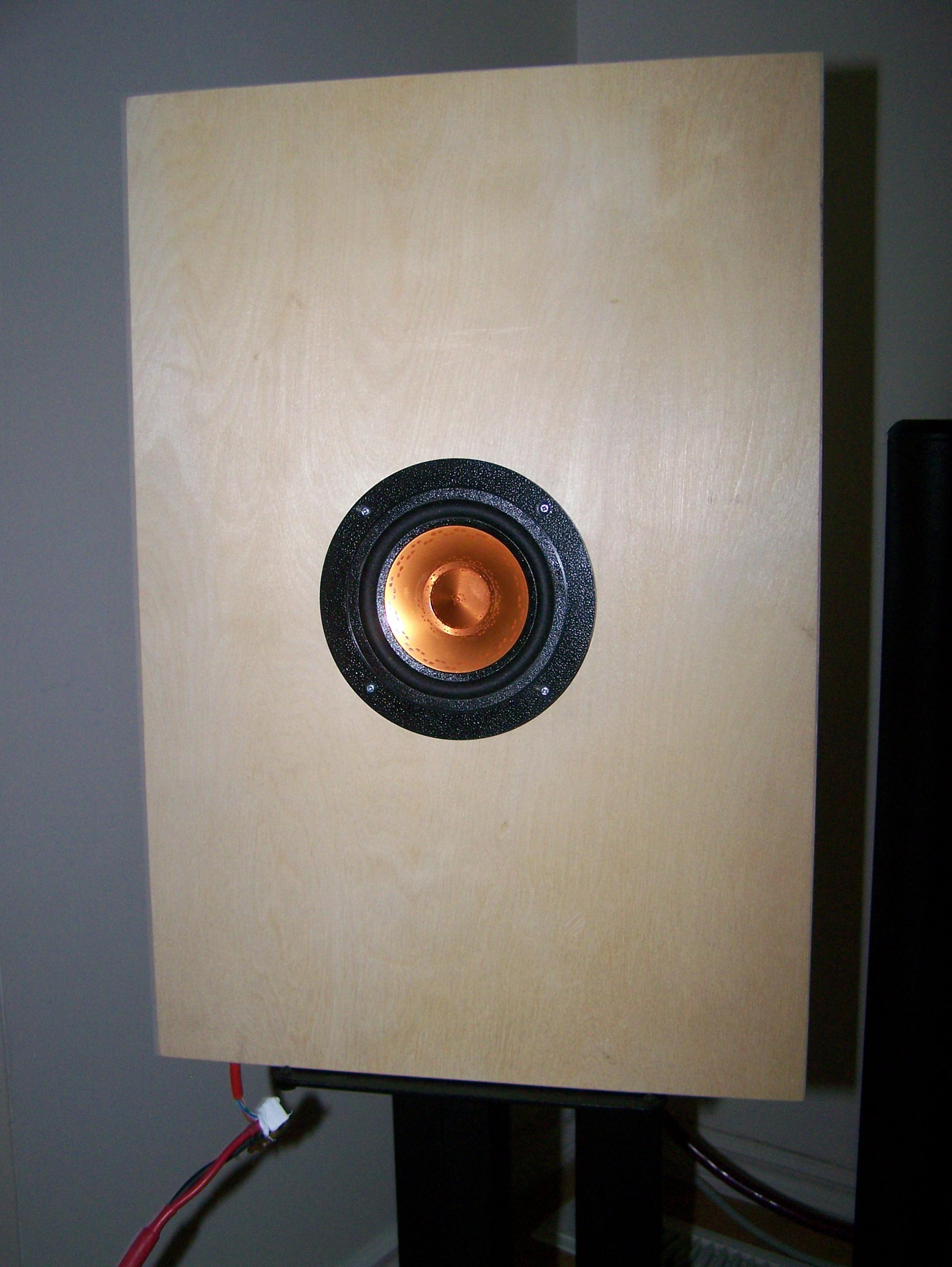

Since completing the dMarKeNs I have tried the CHR-70eNs in a small baffle that is designed to replace the Jordan JX92s OB portion of the Spirit of Orion loudspeakers. Comparing the Jordans vs. the "eNs" is a no-brainer. The "eNs" are much smoother. They lack a tiny bit of sparkle compared to the Jordans, but I suspect that the Jordans add sparkle. I still have not finished the cabinets (they are built, just have no finish on them), but will do so now that the drivers are in the little baffles.

The Jordan's can be worked on. Suddenly very sweet and clear, with no metal flavoring at all, once to Jordan JX92 eN spec.
Bud
It will be interesting to hear how the Alpair12eN works out... they (currently) have the same retail as the JX92 (and to my ear) start out ahead.
I think that Stew's point is that you can buy 2 pair of CHR70eN for the price of a stock set of Jordans (with change left over) -- gives you an idea how well the CHRs respond to EnABL (no other treatment, other than matching) on these
