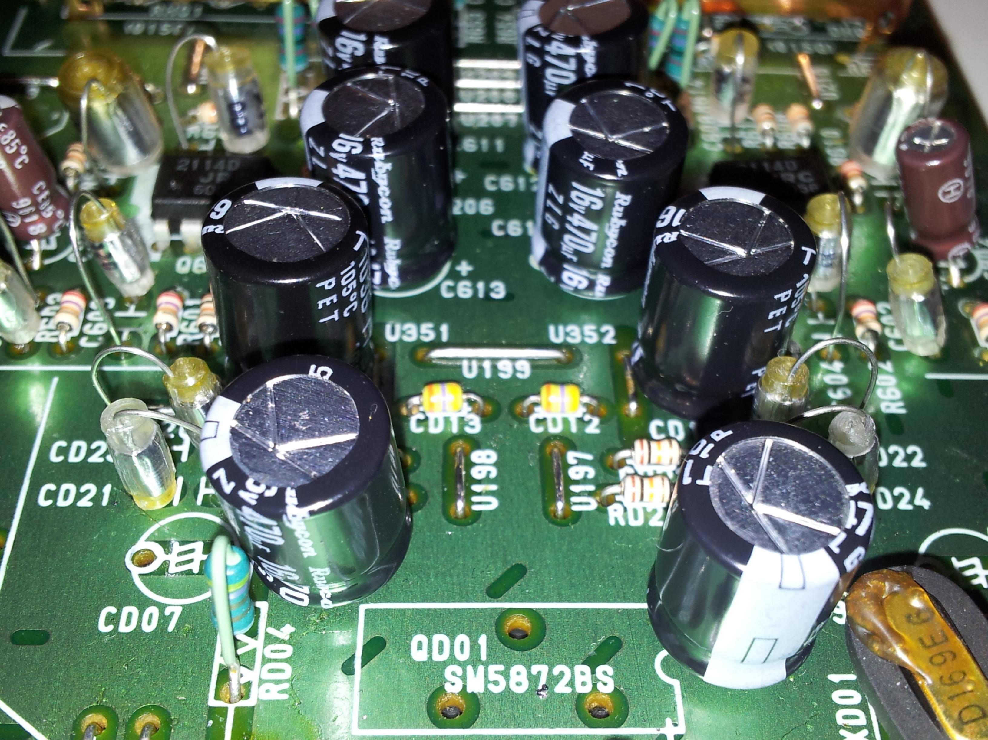

I'm half way through installing a Flea/Tentlabs XO clock, but something's got me confused...
Do I still need a +5v to pin 27 of the DAC - XVdd (Power Supply Xtal) if I'm using an external clock?
I assume not, but I can see people with external clocks who've left/upgraded CD04/CD05 caps in place which makes me doubt it..
Could someone confirm one way or another please?

hmmm, I'm confused.
XTAL = Crystal, so it's literally the power to the original crystal, which I've just removed, which says to me it's useless now.
But then, here's an old picture of Ray's which shows a Flea clock and no original crystal, but with CD04 upgraded and moved to the CD05 position...
ok, well I have the answer now. You definitely need it. Won't play without it, but give it 5v and it's all happy.
Just hearing the new improved clarity from the Flea/XO clock for the first time and I'm very happy with the improvement :)
Now it's time to rip it all apart and have a go at installing the DOS board too....

Here's some pics:
Thanks all for your help, especially Ray :)

I fixed the legs on T5 and the DOS works! Thanks for posting the schematic with the voltages about a million years ago, Ray!
While swapping over I was surprised to find that the player still works with the op-amps removed - just very quietly.
I haven't had a chance to listen properly yet because it was late when I finished. There is very noisy mains hum compared to the op-amp stage, but it's only hacked in with long wires running from the DAC pins to the DOS board so I'm hoping it'll get quieter once it's fitted properly.
Anyway, exciting to finally have it working! Assuming I can fix the hum, all it needs now is better metal foil resistors and better regs (it's on 2x 7812 & 7912)
So I guess this answers the question about how to provide a clock signal direct to the decoder on a v1 cd63 :)
Also, have an arty evening shot of the glowing goodness.
It's getting pretty busy in there now... All I have left to do is to fit a clock divider and give 8mhz to the servo, mount the clock properly instead of blutack and to fit some better 12v shunt regulators to the DOS board. Then a quick tidy up and I think I'm done!
