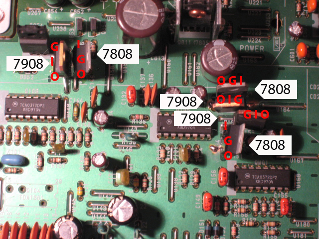

Also, the voltage regulators don't like such big caps at the output (C805/806/815). This could lead to instabilities like oscillation or heavy overshoot at load variations. My experience is that these players sound better with moderate size caps, about 2x/3x original value maximum. C803/804 may be a bit larger, as they are situated before the regulators. Bigger is not always better!

I'm aware of the difference in pin settings. In the picture I took I named the regs and pins (7808 IGO ect). Did I install them correct? When I compare it with pictures of the pcb from other users I noticed I placed them different, but can't find out what I did wrong.

Well first you'll need to resize your images (Photoshop, Fireworks, Paint Shop Pro, PhotoResize, Gimp etc), then attach them to the forum.
If you're not so handy with a computer maybe the easiest thing is to upload them to a website that will resize and host them for you. Photobucket, Flickr and so on.
or e-mail them to me and I'll resize and attach them for you.

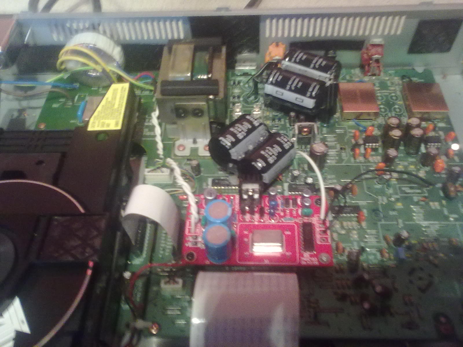

Hi folks,
it's been a few days I'm listening to my CD-43 with DOS modified with the CFP. I've also changed my 317/337 regs for ultra-low noise regulators, Sjöström's SSR. So I don't know wich of these mods has the bigger effect.
First I want to say that's a huge upgrade, going from NJMxxx in the CD63 to LM4562 is far less impressive. Let's say it's as great as regulated drivers or full reclock.
Bass, deep, fast and strong, that's it, the drums are fine now, no more late and away kick drums. Of course bass guitars are tight and fast. And the slight low mids not right of before is gone.
The overall sound is even more homogenic, and detail of image is imporved, maybe the regs? It seems to have released the details that were held back. On the Subdivisons track of Rush's Signals, the ambient keyboards are no more ambient, in the air, they are a real instrument located precisely. Like I already have the best lenses, and now it's focused, perfectly.
My setup sounds great, just a bit thin and bright, but that's what they say of the TA2024 amp, and that's my amp.I need speakers and amp now, that source is just a wonder, wich is mercyless, showing how bad bad records are, how bright some are and dark some others...
