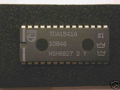

The question was asked as to where my 67' is going this time: This is hot off the computer;
" I have had a look at your cd player today.....
I have sorted the hissing out, it was what I thought it was! The combination of the wideband DOS circuit and the SPowers switching speed we needed to fit a 100nF across the feedback resistor on both SPowers. The noise is now gone, any hissing you hear now is generated by the dac chip and this is normal.
I have ordered 2 transformers as I am going to improve the small psu already fitted internally. The VA will raise from 2x 0.8VA to 2x 7VA, larger SI capacitors will be fitted too. This dual 9.6V psu will supply the Dac SPower and the new Servo SPowers. We will also fit a Spower to supply the clock for even greater improvement there too. " There will also be the all-important fuse-holder by-pass tweakeroo and new rca jacks. Oh yes and resistor changes. Now you know the down and dirty of it!
