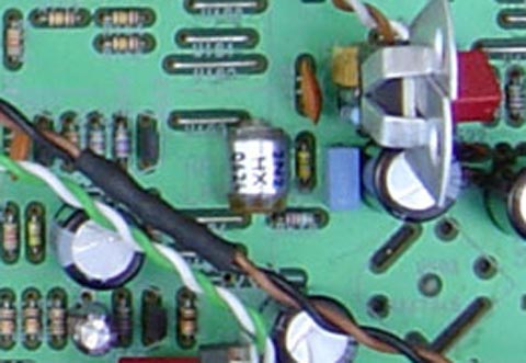

Well I've just minded that the polystyrene I have do not have any blue circle (input side IIRC) unlike the DOS' ones... strange! Or one of the type is better?

As for me as I can't live with that strange sound I've had a look in order to try bypasses.
And I've found a poor ZL under presure: I asked him to work in the wrong polarity... maybe the Servo will be much happier with a new cap in the right way :D And maybe the sound will become "better"! Gimme my dynamic back!
I'm happy that this cap did not blow...
Matthieu
