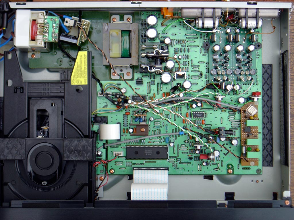

Hi there,
here is my xmas tree!
I had to use only red Leds to get it right...
The CD-43 is finished, it will have to face the CD-40 wich comes next week =)
I'll do sound report of the CD-43 after a decent burn-in, RC LPF and ringing avoided 317 may help a lot.
Another thank you to you all for helping, the result is at least better than the factory player ;)
A grateful Matthieu,
merry melodies to you all!

Yep,
and I can check if at least 2 regs are working through the removed headphones' jack :)
But it does not sounds good. It's held back, lack energy and dynamic. Maybe I need to bypass caps (I did not at all, only big lytics and bypass at pins) or such to improve response? Like very input legs of the regs? That annoying bypass caps story...
Or my output caps combo are not that great, or the BG at DAC's analog and DOS (and pre-amp also!) take years to burn-in... albeit the xmas tree and moved furnitures changed sound and what I am used to... I don't like the way it sounds now :(
