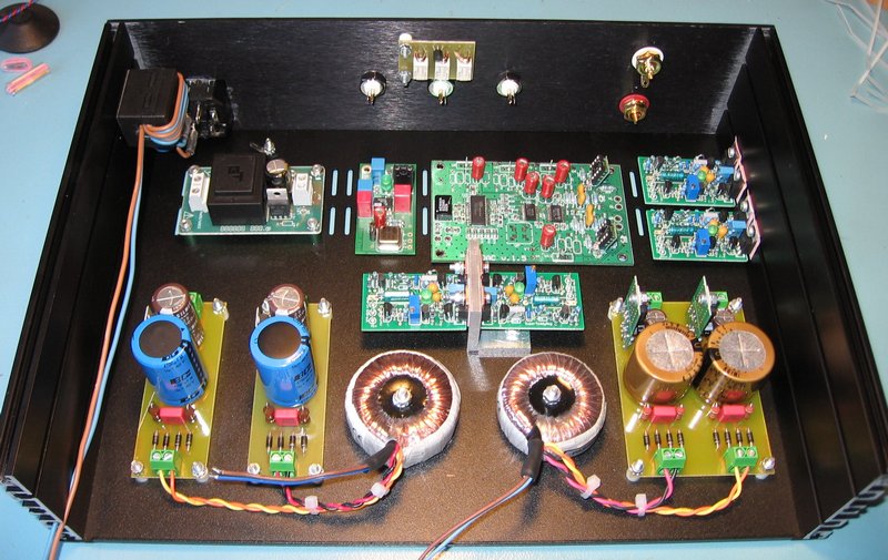

Yeah, I know... I was/am busy building ezDACs and Crescendo amps :D
I didn't have a CD63, so that didn't help either. With a nice KI in the house, some more possibilities are available. It's nice to fiddle around with the players again!

The "beast" is a rebuild of my first ezDAC, only this time with discrete regs on the supplies and relais PCB with three digital inputs. I think it's going to be the heart of my system soon :D
Ray
I wonder how it will sound when I hook it up to my new DAC...
Ray
That looks very nice Ray, relay muting too. Now for the boring bit - wiring it all up LOL
