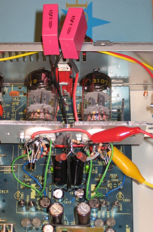

You know what beats HDAM + opamps?
This:
I managed to place the tubes horizontally now, on a piece of scrap aluminium. The passive filter is built up on the player's PCB. At the bottom of the picture you can see two 10mH coil (the others are below the board, not enough space) and some polystyrenes. I've used wires in the opamp's holes to connect it to the tubes. They are ECC82 / 12AU7 now. Output is a bit higher compared to the original, but it's not too much. The attenuation of the filter nicely matches the amplification of the tubes.
The sound is excellent. Nice soundstage, very open mids and highs, and the s'ses and t's sound very precise, without any grain or smear. The music sound very calm, like it's flowing into the room, with great ease. The background is dead silent. The low-end sounds rich but controlled. This afternoon I listened to Pink Floyd's Dark Side of the Moon: it's analog! It's difficult to explain. I would be nice if I could attach some listening results
I have a bit of a hum when I turn the volume all the way up, but I think that's the power supply that I still use to provide the +150V.

6h5c said:I managed to place the tubes horizontally now, on a piece of scrap aluminium. The passive filter is built up on the player's PCB. At the bottom of the picture you can see two 10mH coil (the others are below the board, not enough space) and some polystyrenes. I've used wires in the opamp's holes to connect it to the tubes. They are ECC82 / 12AU7 now. Output is a bit higher compared to the original, but it's not too much. The attenuation of the filter nicely matches the amplification of the tubes.
Ray.
very nice Ray

Thanks guys. I'm very pleased with the sound. But i'm not satisfied yet
In the next few weeks I want to see if I can tune the circuit regarding harmonic distortion. The nasty thing about low B+ and low current is that the tube is biased in the more curved area of its characteristic, and more 2nd harmonics will be present in the output signal. This sounds very "tubey", but is not what I had in mind.
I want to experiment a bit with different tubes, anode resistors and voltages. A friend of mine built a good 1kHz notch filter and a very precise 1kHz oscillator a while ago, and I hope to do some measurements with that. If I have to run the stage at +300V in the end, so what!
Allan, it is indeed hard to find tube-data at low voltages. Maybe i'm going to build a set of curves myself. It's not that difficult...
I don't think valves are the only possibility to make a nice output stage. I think it's the lack of feedback / opamps that does the trick. I expect a simple discrete FET or bipolar transistor stage will get you similar results. I want to modify the HDAM circuit into something like that, see how that sounds. It will get rid of the +150...300V
Ray.

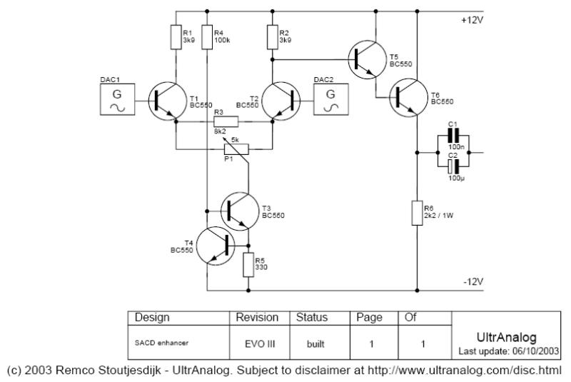

I built the V2 headphone amp with 6922's, sounded better with B+ 40V, was going to try 60V or 80V, got sidetracked
agree, if B+ too low, gets to close to the curve, very hard to bias for.
Thats why i didn't experiment with 12xa7, 12au7 etc
ps and lack of valve experience
the utralog circuit you posted before
Have a lot of bc550C/bc560C's sitting around, will have to breadboard something.

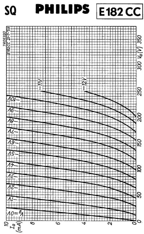

6h5c said:This one is nice, they included curves for lower current.
Why do I always pick the expensive SQ types?? What is that??
Ray.

poynton said:Hi Ray,
Nice tube
Nice curves
Look at this on Ebay 5875277030
Guess who's selling it
Hey nice tube! You have only one?
Ehm, your statement that it is a special ECC82/E82CC is wrong!
It is a totally different tube. Maybe that's why you didn't get any bids yet
ECC82: mu=17, Ri=7k7, S=2.2mA/V (@ 10.5mA)
E182CC: mu=24, Ri=1k6, S=15mA/V (@ 30mA)
Ray.

poynton said:
Hm, I don't know where they got that idea.
Later they say: "An amplification factor of 24 is quoted. The operating conditions, performance and pin connections differ from the ECC82." Seems a bit contradictive.
