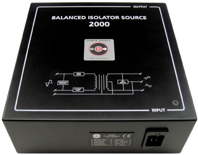

How about isolating and balancing the power also?
I found this on this site.
It's a small dutch company that makes all kinds of mains conditioning stuff. Look at the schematic that's printed on the box, they use a transformer to isolate and balance the mains voltage, and create a symmetrical connection around earth.
They claim that mains filters will work better and power cables will radiate less noise.
Ray.
Ray.
6h5c said:How about isolating and balancing the power also?
Ray.
Ray.

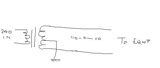

how do you balance an ac voltage?
awpagan said:
They also use an earth
allan
also ray and andy
Balanced about ground - Use a centre tapped secondary Isolating Tx with the centre tap to ground
poynton said:
Use a centre tapped secondary Tx with the centre tap to ground
Question is for the EE's
How do yo earth through a transformer?????
allan
allan
I don't know the physics but it has something to do with converting line noise to 'common mode'. ?? which self cancels ??
Which site did you get that picture from?
