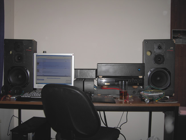

LOL, ok then. I'm listening to my JVCs I stole from the dump site, with £30 worth of drivers (all three in each upgraded - 1" Wharfedale, 4" Audax poly (run FR), 8" Wharfedale (run FR)), fed from LM3886 dual mono chip amp, Rod Elliott preamp and heavily modified CD63KI.
Ramsey Lewis Trio is playing and my beer was Excelsior - mmmmm.
I think my point here is that however crap your room and cheap your speakers, a good source seems to get the music through! And - believe me - this is making quite good music! Lots of life and detail at low levels.
