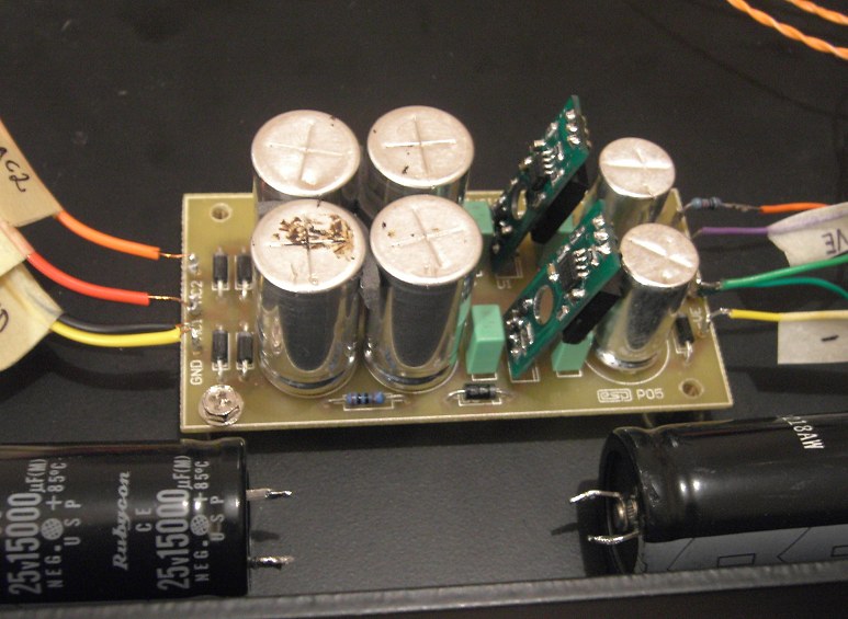

Speaking of regulators, I upgraded my preamp over Christmas to use Brent's delightful new S-Power regs. +/- 15vdc.
I will be using a pair to power the output stage of my CD63 as soon as I can afford it.
Terrific all-round gains and really musical and dynamic. More detail and better imaging, texture of instruments, speed and depth of bass. Overall there's a sense of calm and ease that was missing previously. Cheap regs seem to be a false economy!
Pre-reg caps are 2200u Nichicon, post-regs are 220u Cerafine. Bypass are 1u polyester. Diodes are schottky. Preamp is 2 x LM4562. The 15000u were connected for a bit but I disconned them trying to isolate a problem, not sure about their addition pre-regs.
Simon

rowemeister said:Nice to see my babies in situe
Brent
Brent
Looks nice indeed Brent, but as i'm a real dutch guy: ~ 62 euro is a bit pricey though! Is there is discount for us DIY'ers ??
